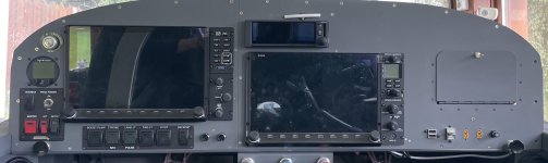

Well... this is about as close to done right now as I'm getting to get so that I can get her flying! All Garmin and FlyEFII.
What’s the flyEFII controller used for in a practical sense? I take it since it way over on the right it’s not something that gets tweaked or adjusted throughout a flight?
For regular flight checks its used to confirm various ECU and fuel pump pre flight checks (one ECU off, other one runs, etc).
Its a back up source to show both my battery voltages as well as a back up MAP and fuel flow meter. It also shows throttle position, injector duty cycles, engine temp (at least through the probe mounted in the #3 primer port). It has an SD card slot for recording all the engine data as well.
Most importantly though has a knob that allows you to trim your fuel and also the menus to change your injector and ignition timing, fuel map, etc etc.
