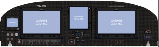

Here is my Plan for Serial 140088 with help from SteinAir:Screenshot 2023-12-10 at 18.49.20.png
I am probably going to put the 507 on the center console however above the angled dash 7 fuel valve.
It’s very common, but what is the reason for the ignition breakers adjacent to the switches? Is it just to shorten wire runs?
It's common with P-Mags because you want to interrupt the power to each one to test the internal generator along with grounding the P-leads during the run-up.
Here is my Plan for Serial 140088 with help from SteinAir:View attachment 56899
MIg,
Just a couple thoughts - and, it may save you a few bucks (but check with Stein):
*The G5 may be unnecessary as I believe with two G3X's offer plenty of redundancy. I believe the G5 is generally installed in the config above (in conjunction with a G3x) so it can take over should the G3X display fail. The G5 can also take over 'directing' the Auto-Pilot. That said, I believe since you have a second G3x - the second G3X can be effectively configured as the back-up, in place of the G5. I would at least ask Stein about this. Maybe in your scenario, the G5 is essentially third in line? What I would rather have (I do have) in my plane is a different level of redundancy (vs the G5 batting third) - I'd opt for an iPad with a stratus with ADHRS. This way, you could lose the whole panel, but you'd still be able to navigate and follow an approach if necessary using foreflight and the stratus. The ipad (or even your iphone) will hold a charge for at least an hour to two, and the stratus will go for 8-12 hours. You would lose AP, but again, this set-up is the third batter - not your primary backup. If you remove the G5 - it gives you a nice place to put your iphone (ram mount). And, if you go to the small (7") G3x, you could mount an iPad on the rightside. This puts them both in convenient places where they are easy to see and use (put a usb outlet behind each so they can charge in flight).
BTW - I've had multiple panels (RV7 and RV14's) built by Jason at Aerotronics. He knows this stuff inside and out.
