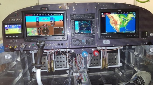

Panel for Norris Brown's RV-14A - N14NP
I am using all Garmin G3x touch screen equipment except the IFR navigator is
a Garmin 530W and the independent backup unit is a Grand Rapids Mini X.
Circuit protection is with the VPX Pro.
Currently working on organizing all the wires.

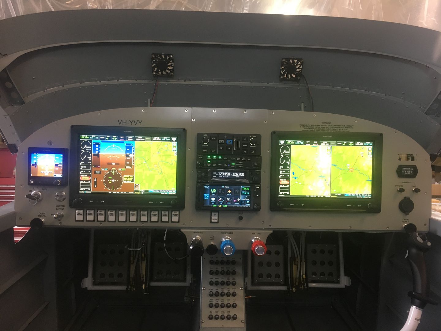

RV-14 VH-YVY Panel
Twin G3x, GTN650, GTX23, GTR200, GMC307, GMA245 & G5. I will be expecting a Christmas card from Garmin this year:)
Aussie panel
Graham,
That's my panel! At least the one I envisioned. Any trouble mounting the AP panel at the top of the stack? Did you do the panel work or hire it out? Looks fantastic. You're only 3 numbers ahead of me. Guess I need to pick up the pace.
James,
Steinair did the panel for me. The AP fits fine and I should still be able to put the canopy release in if I decide to. The GTN650 at the bottom require a slight mod to the sub panel because of its depth but no big deal.
The only change I am making is to put in a paddle style flap switch and use the centre switch for "PFD2".

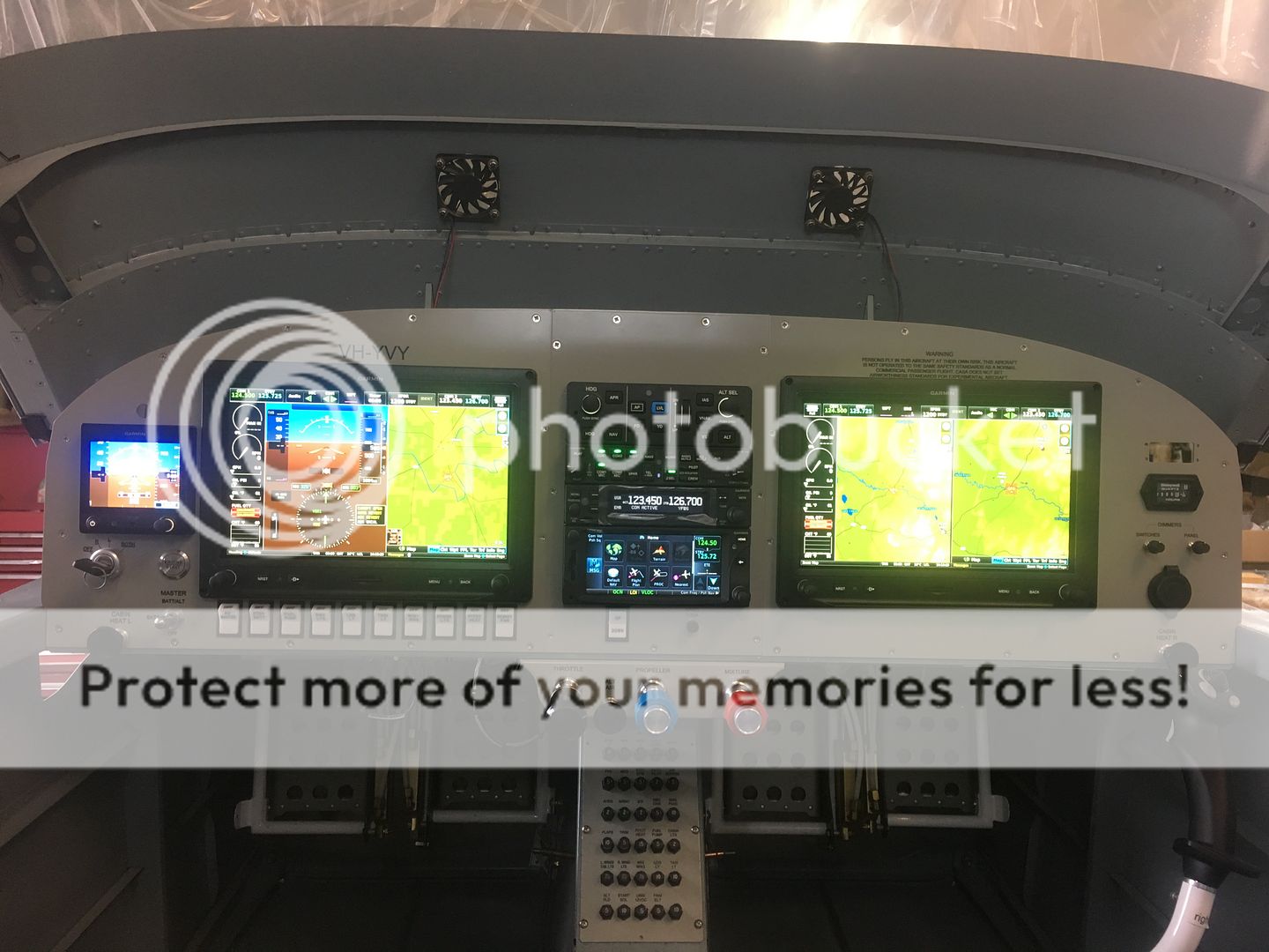

Norris,
Nice looking panel. Did you have to cut out any relief in the canopy frame to clear the outboard upper corners of the GDUs when you close it? The corners of the displays look pretty close to the edge of the panel compared to other -14 panels I've seen, so I'm wondering if the flange on the canopy frame interferes when you try to close it all the way?
Checking panel with canopy closed
Mark,
Thanks for your observation. Put the canopy on today to check clearances and the left G3X display just fits with maybe 1/32 inch to spare! "Even a blind squirrel finds an acorn now and then."

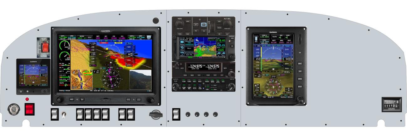

Here's my panel plan
Not a real panel yet but well into the planning stage.
Here's my wanna-be panel. Been editing equipment and PanelPlanner layout for a couple-a-few months.
Plan to go Garmin; left to right - G5 / ARETX ELT / G3X 10" EFIS / TOGA button / - top to bottom stack - AP / 650 / NavComm / Audio Panel / - G3X 7" portrait - Hobbs.
Plan to get started on acquiring and building within a month or so of new year
Why Audio panel on the bottom and AP on top? You'll touch the AP more on every flight than the audio panel.
Why? - Because >
Why I put the A/P at the top and the Audio Panel at the bottom of the center stack:
Objective, Weighable, Measurable, or Quantitative;
I shortened the canopy release handle to extend just out of the sub-panel face and clears the back side of the A/P with no interference when pulled to release the canopy; as the Audio Panel extends further and presents a clearance issue when pulling the canopy release handle. I chose not to provide a canopy release ability when in-flight, only for maintenance and accessibility purposes.
And, I will touch the A/P more than the Audio Panel while flying.
Subjective, Conditional, or Qualitative;
The A/P at the top of the center stack - more comfortable and easier to interface with because it is closer to eye level, less ‘clutter’ nearby at the top, logically located close to the TOGA button immediately to the left and above the 10” EFIS.
I like the Audio Panel at the bottom of the center stack - personal preference.
My plane, my money - my rules.
