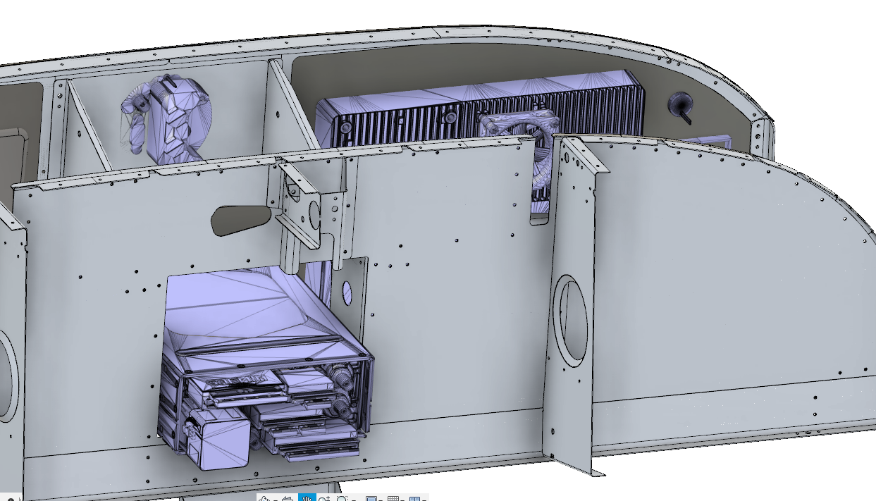

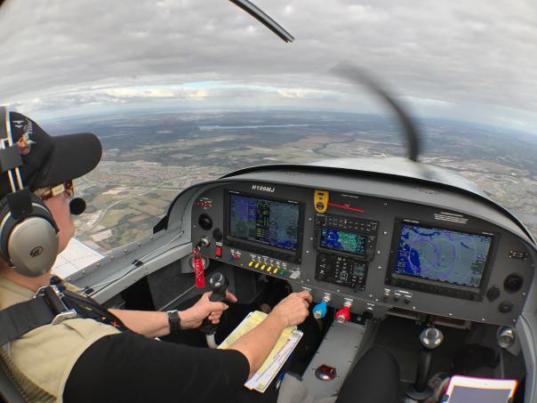

N199MJ final design
Here is our final design. There are 2 additional USB ports located under the bottom edge at the midpoint of the screens. These are for the data input and output of the Dynon Touch system. Turned out to be a great location as they are out of the way and don't take additional panel space. We also have Steins replacement circuit breaker panel instead of the standard auto fuses.
The throttle quadrant is the one Van?s sells for the RV-10. You can sometimes find a builder with a new one for sale a little cheaper if they changed their installation plans.

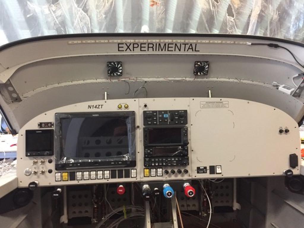

RV14A Panel N14ZT
Here's the panel almost completed, the rest to be done is more of the wiring connections behind the panel.
All of the currently acquired panel instrumentation is mounted and the harness that connects everything is installed and wired to a VP-X Pro (equipment harness built by Approach Fast Stack). 'Most' everything is wired up to the common fuselage harness, still have a few days to a week to get everything connected, that is to the 97.5% done point.
In the panel equip is Garmin; a G5, a GDU465; the stack top to bottom - TO/GA button switch, GMU507, GTN650, GTR200, GMA245, an ECK ELT remote control panel above the G5; and on the right side a partially water-jetted cut out (the corners) for a GDU470 7" portrait, and I have left enough space in the right panel and behind it to put in another GDU46X if that suits me or some future owner instead of the 470. Starter, mag, and alternator (B&C 60A and a B&C 20A) switches below the G5.
Lighted rockers along the bottom for electrical items, four dimmer switches, a Hobbs, next right one of a 5 rocker switch place-holders (black snap-in cover plates), and the special 'WINGS ON / WINGS OFF' rocker switch for good measure to keep passengers thinking and to hammer in the passenger warning placard. A panel mounted dual USB port and two alternator field breakers; a few more breakers to follow as I ran out of circuit assignments in the VP-X.

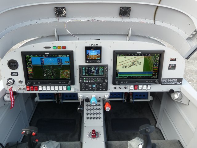

RV14A F-PJEM panel
This panel tends to become conventional now ;) but it's like I dreamed it :)
Dual G3X Touch, GTN650 (COM1), GTR 20 remote (COM2), GTX 35 remote, GMA245, GMC307, GAD27, G5 as backup flight instrument with battery, TCW backup battery for PFD, GTN and GEA24.
Very nice panel indeed.

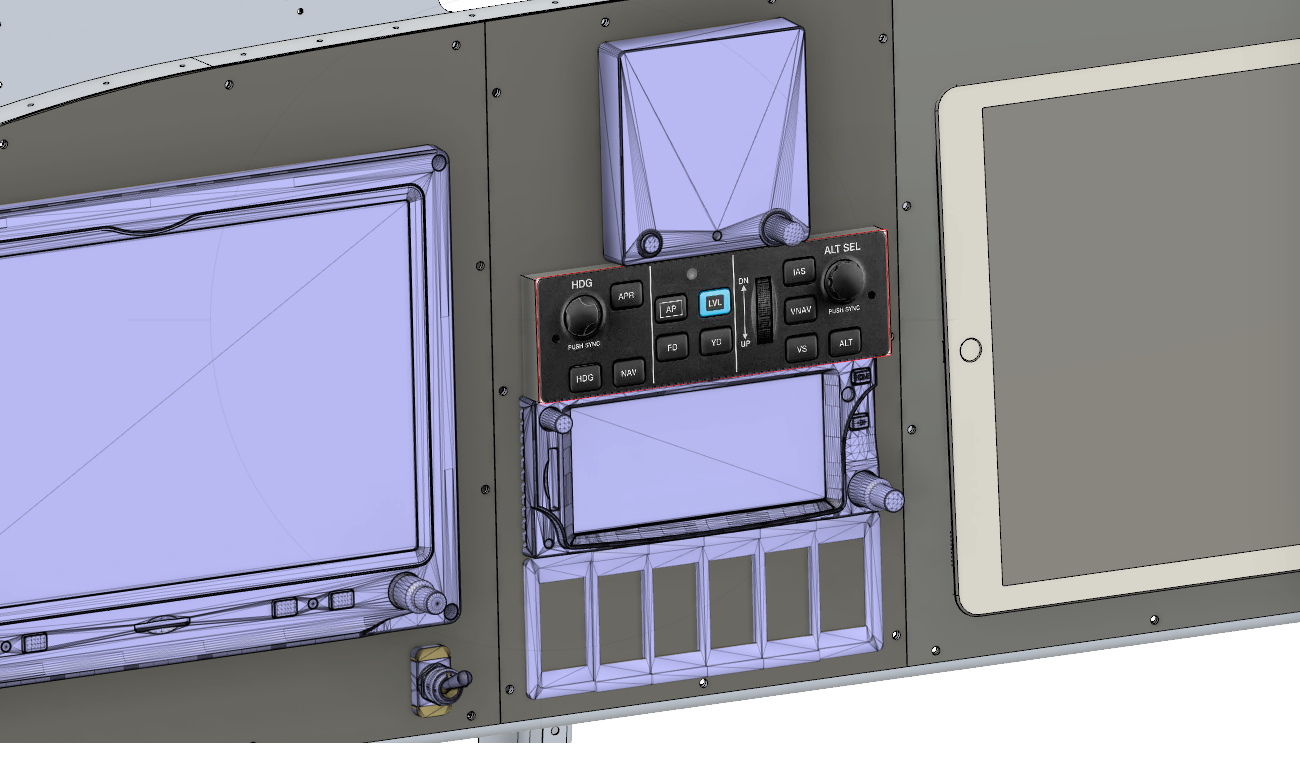

Panel Plan
Pilots Side:
Engine Start Push Button
ELT Control (Not Shown)
Master
Avionics Master
Autopilot
Boost Pump
G3X
Flap Switch
Center Console
G5
GMC507
GTN625
Nav
Strobe
Landing
Taxi
Defost
Pitot
Right Side:
Ipad 12.9"
Small Glovebox for pens,glasses etc
The plan is to run as simple a panel as possible. All switches are Carling Contura Backlit and Laser etched by rockerswitchpros. Single Battery, Single Alternator with VPX Sport controlling the 12v electrical system. The G5 will have a battery backup as well as having an Ipad/Sentry combo for redundancy. The flap switch is a lit toggle switch as well as engine start. Every switch is lit and laser etched to do away with panel labels. I am hoping I can use the built in intercom of the GTR20 instead of a remote comm panel.
Greetings.
Be careful that the Canopy Close-Out doesn't impinge on your instruments behind the panel when the canopy closes. The Close-Out is the gray box-like area with clecos in this picture:
Also, be careful that the C-01404-L/R Support Flanges don't overlap any part of your panel devices when the canopy is closed. In the above picture, that's the gray part that on the top underneath the glareshield.
As an example, I put dual 12.1" GRT HXr EFISs in my panel. They had to be aligned to the bottom of the panel so that the canopy could close. My steam ALT on the right actually just contacts the aft edge of the Close-Out when the canopy closes (if you look real closely, you can see a bit of white on the edge of the Close-Out which is where the paint was rubbed off and now exposes the primer).
I see you're in Colorado. PM me if you'd like to take a look at my bird to get a better perspective on what you need to watch out for when placing instruments on the panel.
Thank you both for the input. I was able to compress the stack and get the g5 with 15mm clearance at the top. I am worried the switches won't have enough support between the 625. E, I can't tell you how helpful your blog has been.

Finally, everything attached and mounted on panel and behind panel, VP-X Pro with configuration transferred, Master Switch ON, Avionics Master ON. Hold breath and step back . . .
No smoke or sparks.
VerticalPower VP-X; ACK ELT, Garmin - G5, GDU465, GMC507, GTN650, GTR200, GMA245, GDU470, GTX45R_emote.
Now on to a few small buckets of airframe finishings up, gear leg fairings, wheel pants, etc, etc...
Looks nice, Jeff. What are the things on the far right of the panel? They look like circuit breakers, but you have a VPX. :confused:
They are CB's
They are Circuit Breakers. I ran out of VP-X circuits, so ran a number of items through CB's.

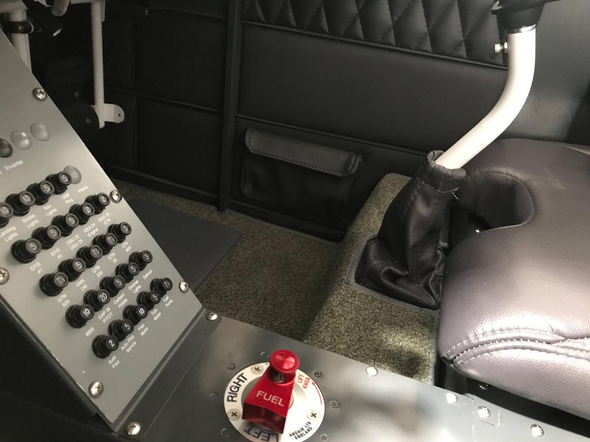

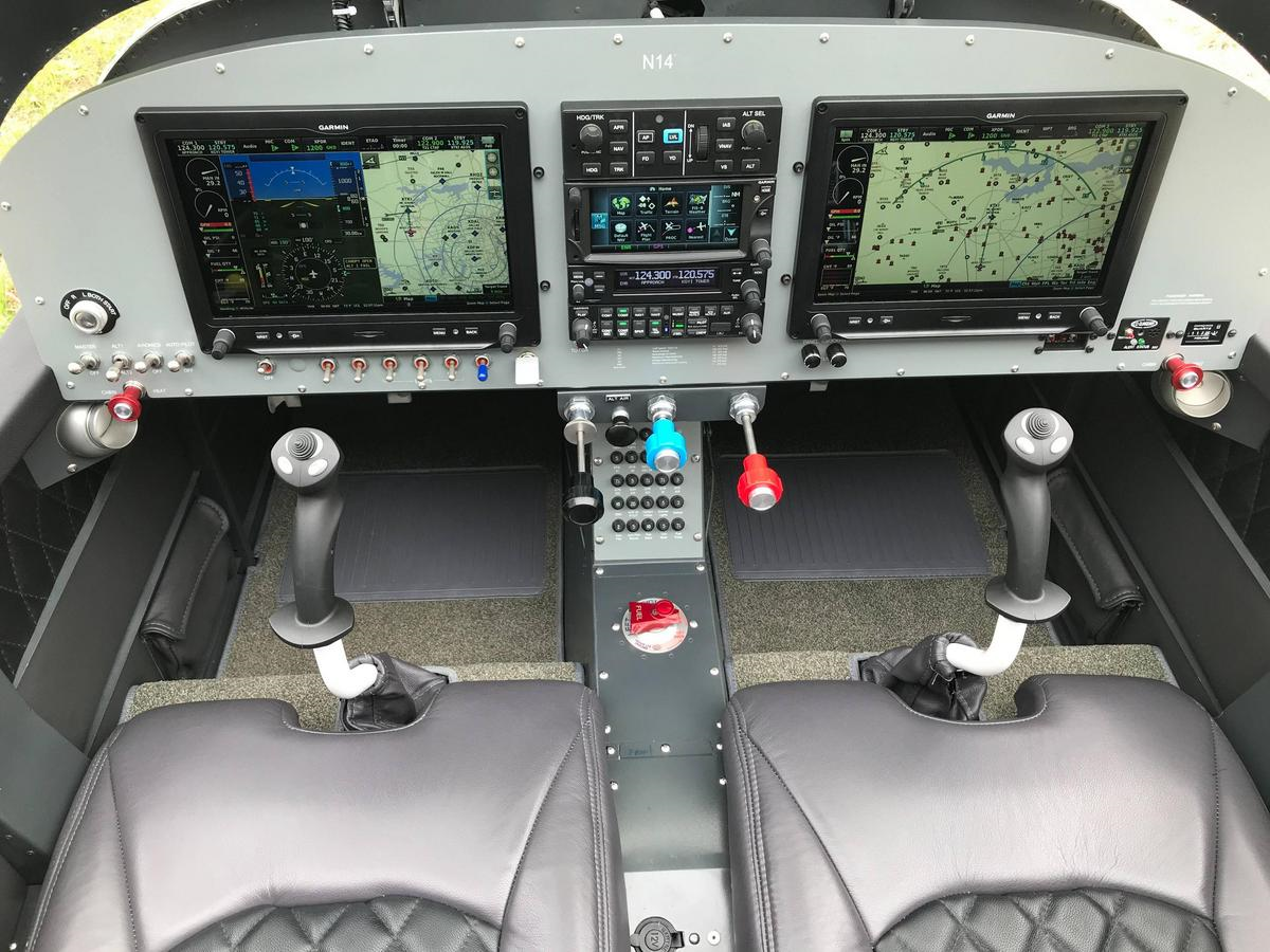

Looking at the N14 photos, why would the fuel select valve be in off?
R
OFF or ON, probably either way is OK.
What a wise man once told me (can't remember who) , "You don't want to rotate the valve at all until there is fuel in it." Probably not good for the valve.
That must be why, I thought it was a flying aircraft and there was a good reason to select off after shutdown.

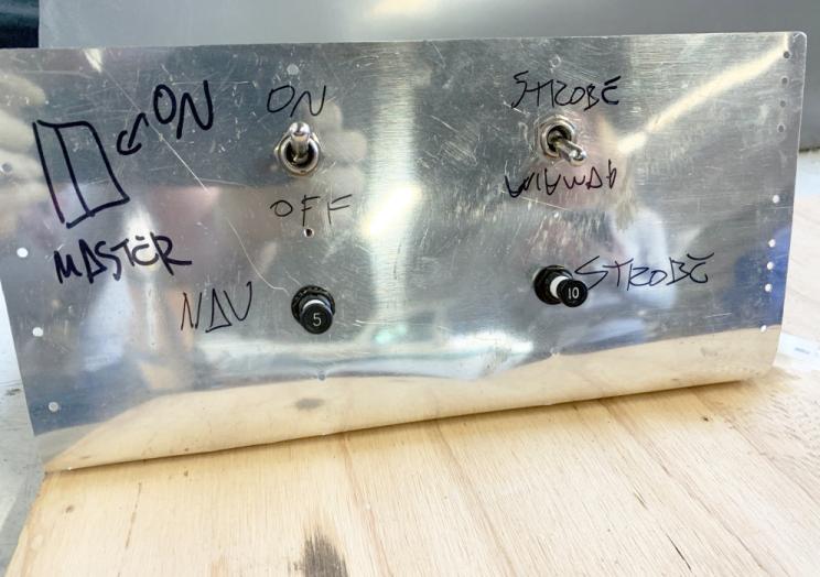

That is a good question for Van's, this is there design. There are a lot of safeguards in the electrical system. What is your concern.
I decided to use Klixon breakers verses a electronic breaker box. Simple to diagnose issues and quick to pull if needed. The location Van's selected for the breaker panel is very functional. I installed a small strip of LEDs under the radio stack/ connected to the panel dimmer to see the breakers at night.
I wouldn't necessarily have any concerns with the CB that close to the fuel valve. I really like the looks and the way the CB are installed thru this kit and get mounted but I had a real concern regarding removing gaining access to the tunnel which require this bracket/section to be removed/moved. It seemed to me that one would need to have a good size lead on those wires to move them and set it aside to gain adequate access so I decided against it.
Yes, I appreciate the comment as that planning is required. I did leave an extra 12" of wire to accommodate the panel removal for access of the fuel pump/filter maintenance.
