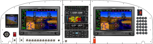

Here's the plan...
This is the latest plan for my -14.
Looks nice. One question: Why are you putting headset jacks in the panel? (at least they look like headset jacks). The 14 has them on the floor either side of the seats, and that keeps the wires out of the way nicely.

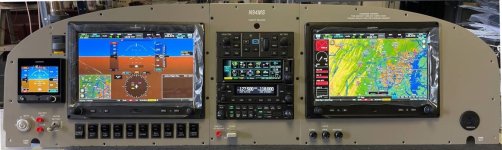

N94MS Panel
David at Avionics Systems in Virginia did a great job! Highly recommended.
Panel includes:
Dual Touch's
G5
Garmin A/P head
GNX-375
GNC-255
GMA-245
Behind Panel:
Remote Comm#2
VPX Pro
etc
Note: Center panel has been changed to have canopy release hole in correct position. Also added a SAFE GLIDE switch.
Great point! I just didn't know.

Looks great. I would consider changing the position of audio panel an AP-Panel…(like Marks example here). you will use the audio panel farless than AP…
I have gone back and forth with that so many times. Most GA airplanes I flew had the Audio Panel at the top so there's that. All the airplanes I flew with the AP panel at the top had autothrottles, so there's that. I reasoned that many of the functions on the AP panel required a power adjustment, so why not put it close.
It's just about time to flip the quarter... :cool:
Thanks for the input. I need all I can get!
Audio panel on top? There are historical reasons for that and those reasons no longer apply. Back in the bad old days of tube radios, before there were flip-flop radios, a pilot would listen on one radio and then tune the other to the next frequency. Then to switch radios, it was go to the audio panel, turn off the old radio audio, turn on the new radio audio, and switch transmitters.
With flip-flop radios, you don't have to do that. Once things are set, you hardly need an audio panel. In fact, you hardly need two radios any more if the comm radio can monitor a standby frequency. I've flown single comm radio for six years now and never looked back.
The second reason that audio panels were installed atop the panel is that often the cowling sloped down ahead of the windshield, and old style audio panels tapered down at the forward end to match the limited space.
As for putting the autopilot panel next to the power knob because they get used at the same time... Maybe sometimes, but not all the time. When you move your eyes over to the autopilot panel so you can push the right button, it's easier if you don't have to move your eyes down.
As for your choice of GPS, I think there's a better option. The GTN650 (or other GTN6XX) has more screen real estate, and that will be handy when you are editing flight plans or fussing with approaches. Plus, if the GTNxxx has a comm radio built in, those frequencies will be displayed all the time and the knob will default to them, so in terms of usable GTN screen real estate, a separate comm radio costs you and provides no benefit. And if you've got another comm radio already, you're covered.
I'm not sure how things get wired up if you have the VHF NAV in a separate box, but with the VHF NAV in the same GTN box, the system will automatically transfer from GPS guidance to ILS guidance... if you set everything up correctly.
What would I do if it was my plane? Autopilot on top; GTN750 underneath to get effectively one more MFD screen; Comm 2 or Transponder underneath; and audio panel under the right side screen, 'cuz it will almost never get used, once the intercomm is set properly.
You said that you go back and forth. True confession, so do I, sometimes...

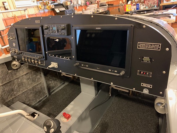

Here's how mine ended up.
GNX375
GNC255
GTR20 + GDL52R + TCW backup mounted behind the passenger panel.
I questioned myself by not putting in the second screen on the passenger side, but after 150 hours behind it, I'm glad I didn't. It's just too far to the right for the pilot to make regular use of it. The only thing I would do different (and budget not a consideration) is put in a GTN750 & scrap the gnx375/gnc255.

Thanks for sharing. Though I have years to go, I have been thinking one pilot MFD with a stack similar to yours, leaving space on the right side for, perhaps, an iPad mount. Your setup looks IFR capable, if I'm not mistaken.
Yes, IFR capable. My back up battery will power the G3X system (GDU, GSU, GMU, etc..) & the G5 has its own back up battery. Should I lose the GDU for some reason, foreflight on my ipad mini will get me out of a pinch.
As I mentioned, the GTN750 would have been ideal, but hind sight being what is....
All in all, I'm happy with the setup and layout.

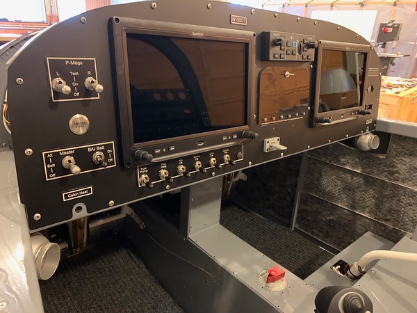

new 14 panel
VFR G3x, easily upgradeable to IFR by sacrificing the center map box.
Found that Van's sub-panel mapbox hole was the perfect size to house the Garmin remote audio panel plus remote com1 and com2 radios.
Hey Steve,
Just curious; where are you putting the throttle, mixture, prop controls?
Can you remove the remote audio panel forward enough to get it out of the tray without removing the tray? It's going to be tight if it does.

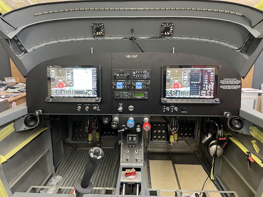

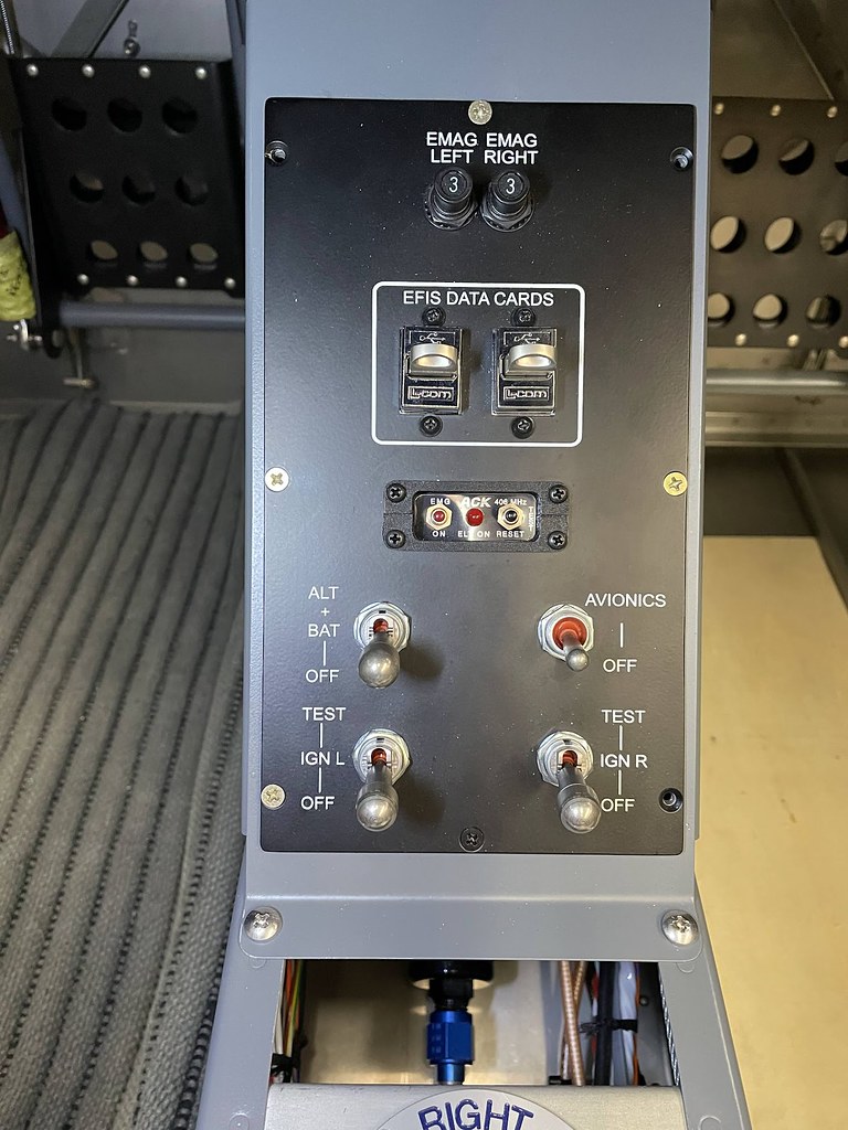

Finally our panel
Hi guys
Our RV flies and we finally come around to post some panel pictures. We planned to panel to fly from the left and right seat to accommodate the heights of my wife and myself :) I'll always sit in the right seat, she in the left. We are very happy with the Dynon solution so far. The panel is made by Advanced Quick Panel. The toggle switches are "the Hummel solution", we wanted them instead of the standard switch panel.

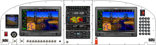

Final Panel CAD
It's a done deal...

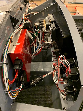

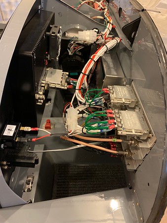

New RV14 Garmin panel
Complete Garmin panel and airframe wire job, headed back to builder for completion. I have included a couple of behind the panel shots as well.
