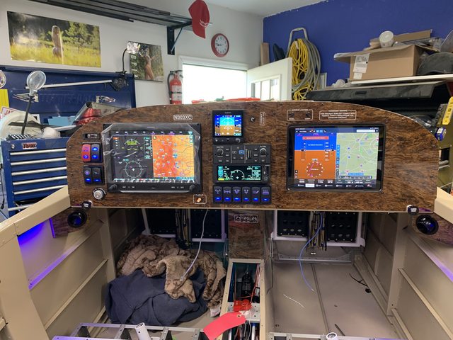

Show us your RV-14 panel
Panel Preview. The right side gets an Ipad. Very Simple IFR panel.
G3X, G5, GMC507, GNX375.

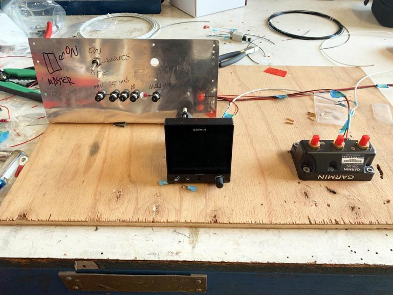

Okay time to roll out V 0.2:
I replaced everything on the 'panel' and this time I have my G5, GSU 25 and a couple other can bus goodies hooked up. The only thing I didn't replace was the, 'Master' switch :D
Got the panel put together
Nothing is wired yet but I cut the panels, covered them in flat black vinyl wrap, and labeled them. Then I got everything mounted. Tada!
Thanks to Jared Solomon for the inspiration on this (Okay... I more or less just copied his panel with a couple minor changes. It's hard to argue with success. :p)
Let me know what you think.

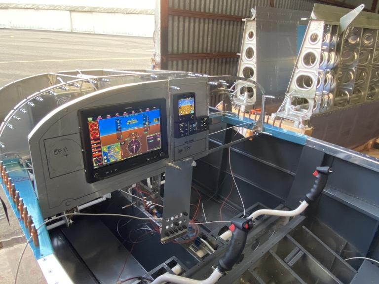

V 0.5
Okay finally something that doesn't look hokie. The G3X is so damned sweet. I even have my right wing hooked up (which was the point of the exercise to begin with). I wanted to at least crappily calibrate my magnetometer. Rain prevented that but who cares!
Note the oh so eloquently mounted temp circuit panel.
I'm very happy with my choice to do all of the plane wiring myself.
It's not easy but its a blast getting back into wiring again. I used to
run miles of ethernet in stuffy attics before wifi was a thing and you
wanted to get your house, 'plugged in'... this is much more fun.

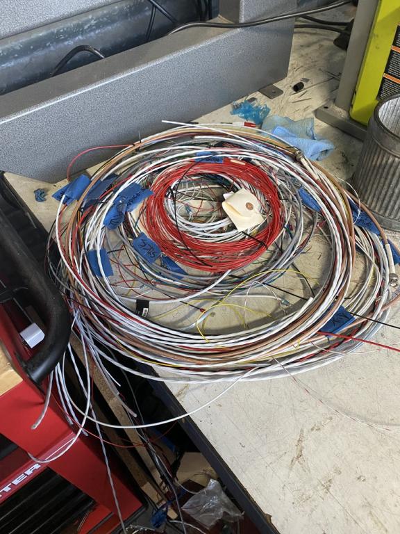

That being said... welcome to my own lil personal hell:

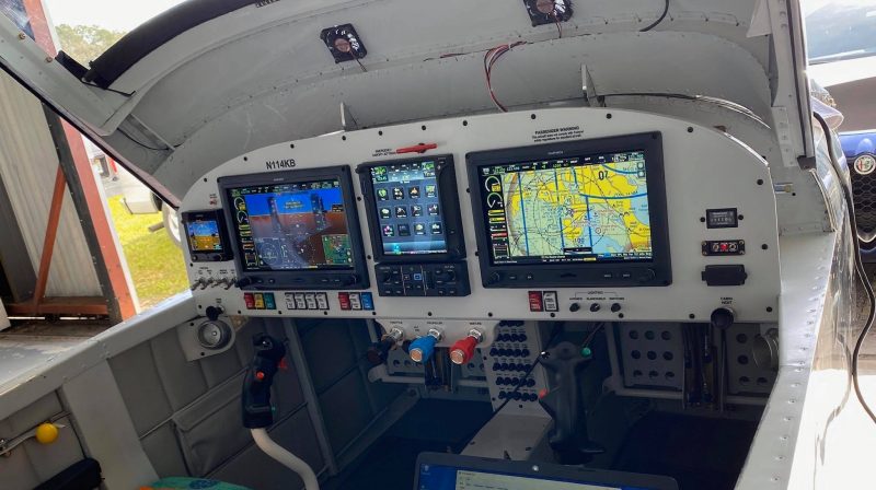

Garmin G3X Panel by SteinAir
Here's our G3X panel that was just shipped the end of last week from SteinAir. Needless to say SteinAir was absolutely fantastic to work with (again) and their workmanship is outstanding. Here are a few details about the panel and electrical system:
Dual G3X Touch w/ G5 Backup
GTN 650Xi
GTR-20 Remote Radio
GTX-45R Remote ADS-B Transponder
VPX
SiriusXM
IBBS
Plane Power 30A backup Alternator
AOA Pitot Tube
3 Axis Garmin Autopilot with Pitch and Roll Trim Servos
GMC-507 AP Control Panel
GMA-245 Audio Panel
CPi-2 Dual CPU Ignition w/ Backup Battery
ZipTips Wingtip Lighting and PosiStobe on the tail
Par36 Leading Edge Landing Lights
The 4 breakers on the right side of the panel are for the CPi-2 ignition system (2 CPUs and 2 coilpacks). SDS recommends using regular breakers instead of the VPX system to provide power to their system, and we were running short on VPX breakers anyway. The switch labeled "Spare" in the panel will be re-labled "Lean Mode" and will toggle the CPi-2 system into LOP mode advancing the ignition timing (same as pressing the LOP mode button on the controller).
