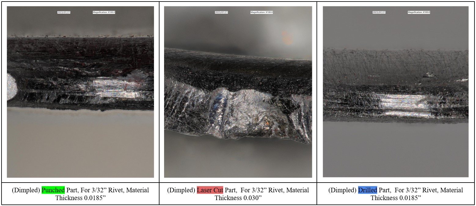

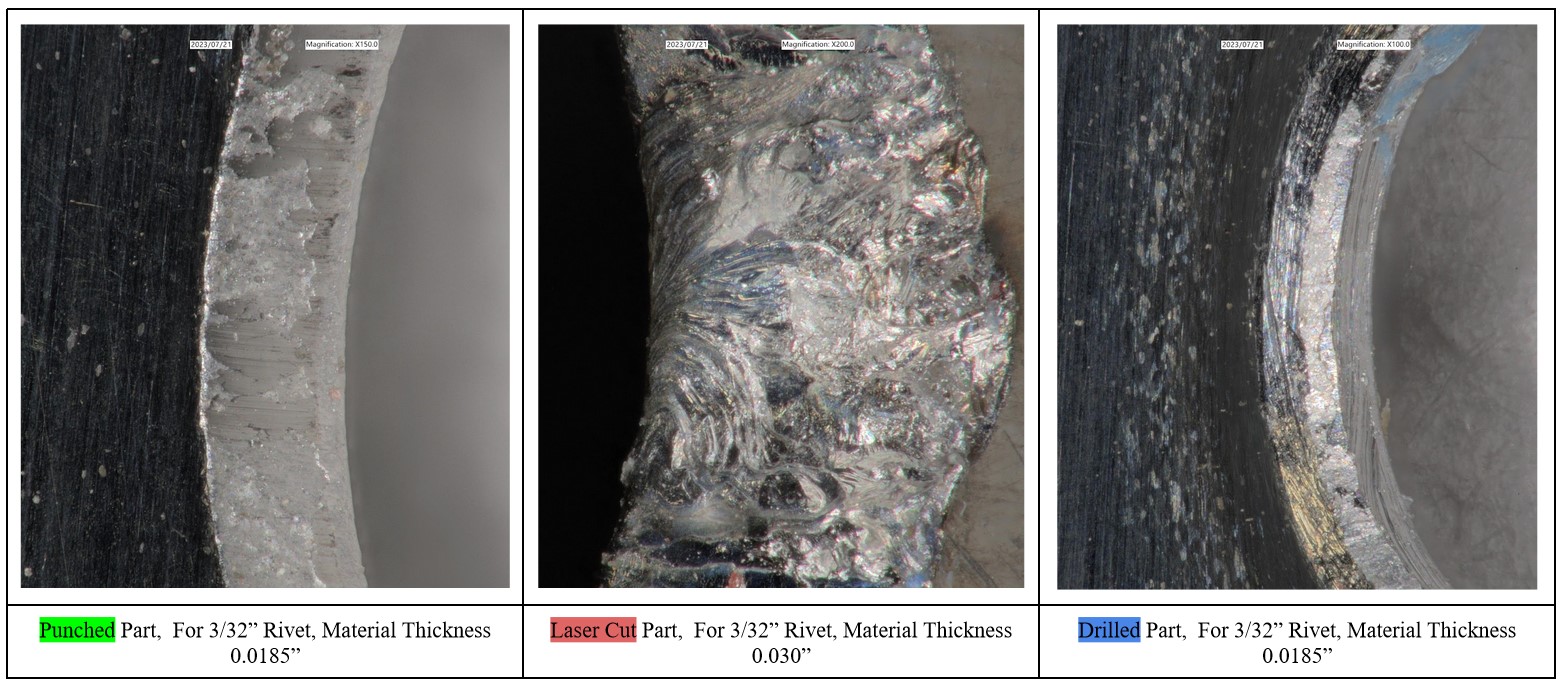

Figured I’d dig through my scraps to find some unused laser cut parts from a particular third party ER tank supplier.
Night and day difference in parts. My ER laser cut parts are CLEAN. Obviously this can be done properly, you just need to know what you’re doing.
Are you sure it laser cut. Look too clean
Thats definitely laser cut...punched is much cleaner...note the hole is not nice and round like a punched hole...however its interesting to note it is a clean cut laser hole and could likely be cleaned up with a reamer just fine......maybe not all last parts will be duds.

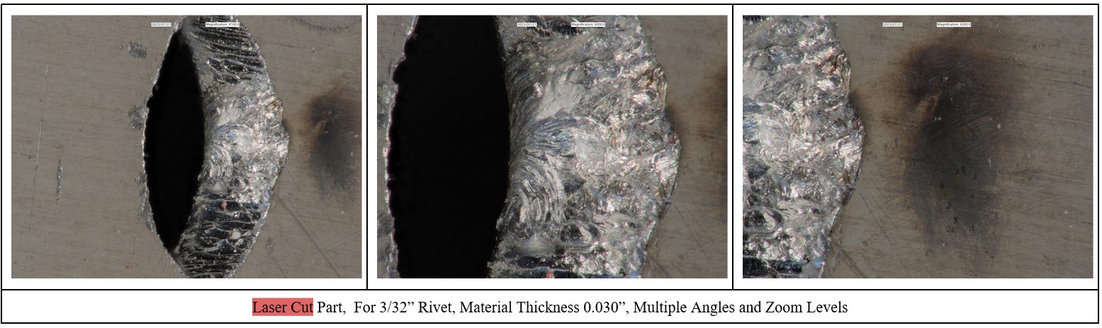

Definitely. Under scope, the telltale vertical scarring around the face of the hole is evident just as with the Vans parts. No slag or notches whatsoever. The hole isn’t perfectly round, but pretty darn close.

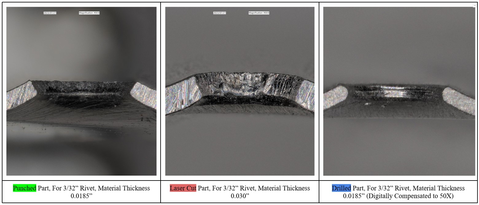

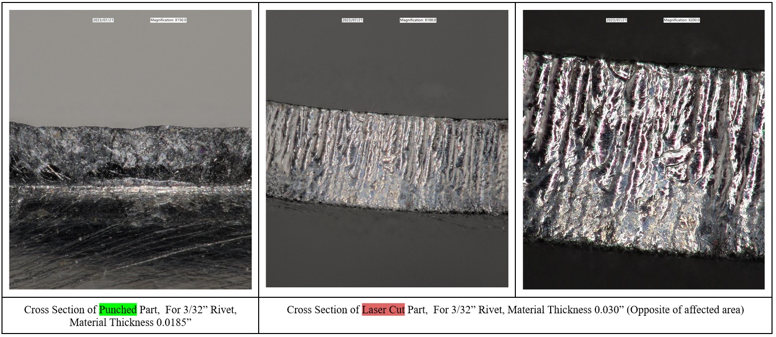

Thanks for posting this! Do you have some pictures of traditional hole punched once too?
Oliver
Since you insist, I guess I'll play with the microscope at work again... :D

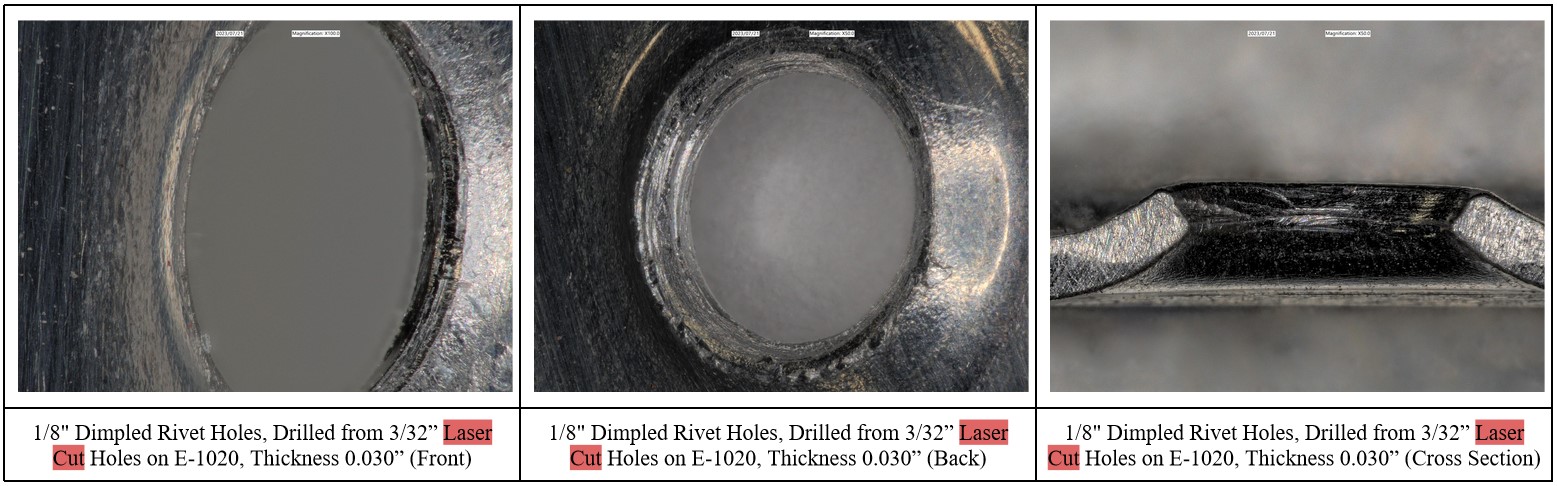

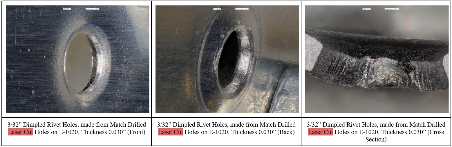

I intended to test parts with and without deburring, but that proved difficult to do, because I was struggling to keep track of which pictures of what parts I'd taken. The microscope isn't the most user friendly tool I've ever used. You'll notice some intended comparisons are mismatched in zoom, some I left, some I zoomed digitally as best as I could.
I would like to preface that, once again, I am not qualified in any way to give advice to any of you regarding aircraft construction, or materials science. I am just a guy who happens to have access to a very nice microscope, and am affected by this laser issue. An idiot with access to a powerful tool is still an idiot, don't be fooled. Any interpretations I post below are my opinion, and should be assumed as wrong. Please wait for Van's official guidance.
I think these images show that the problem isn't necessarily the laser cut parts. It seems the laser wasn't properly "leading" the cuts. To my understanding, for holes made to a final diameter you would start in the center and spiral (or go in a straight line) out. This would mean that the initial laser 'pierce' is not on the outside diameter.
Match drilling doesn't appear to make a big enough difference to remove that 'notched' area.
Drilling the holes out for a 1/8" rivet does appear to eliminate the rough surface. However, that comes with an entirely different set of problems and engineering validation necessary. I did this test because I am worried that I will make a "few" mistakes drilling out several hundred 3/32 rivets.
