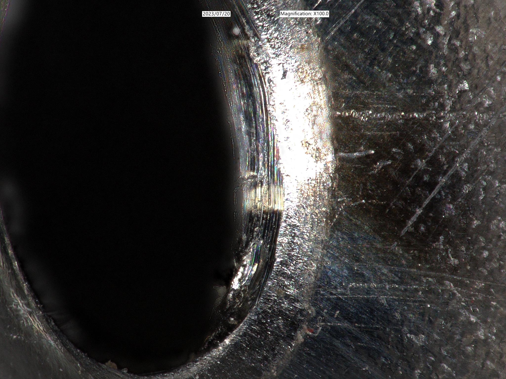

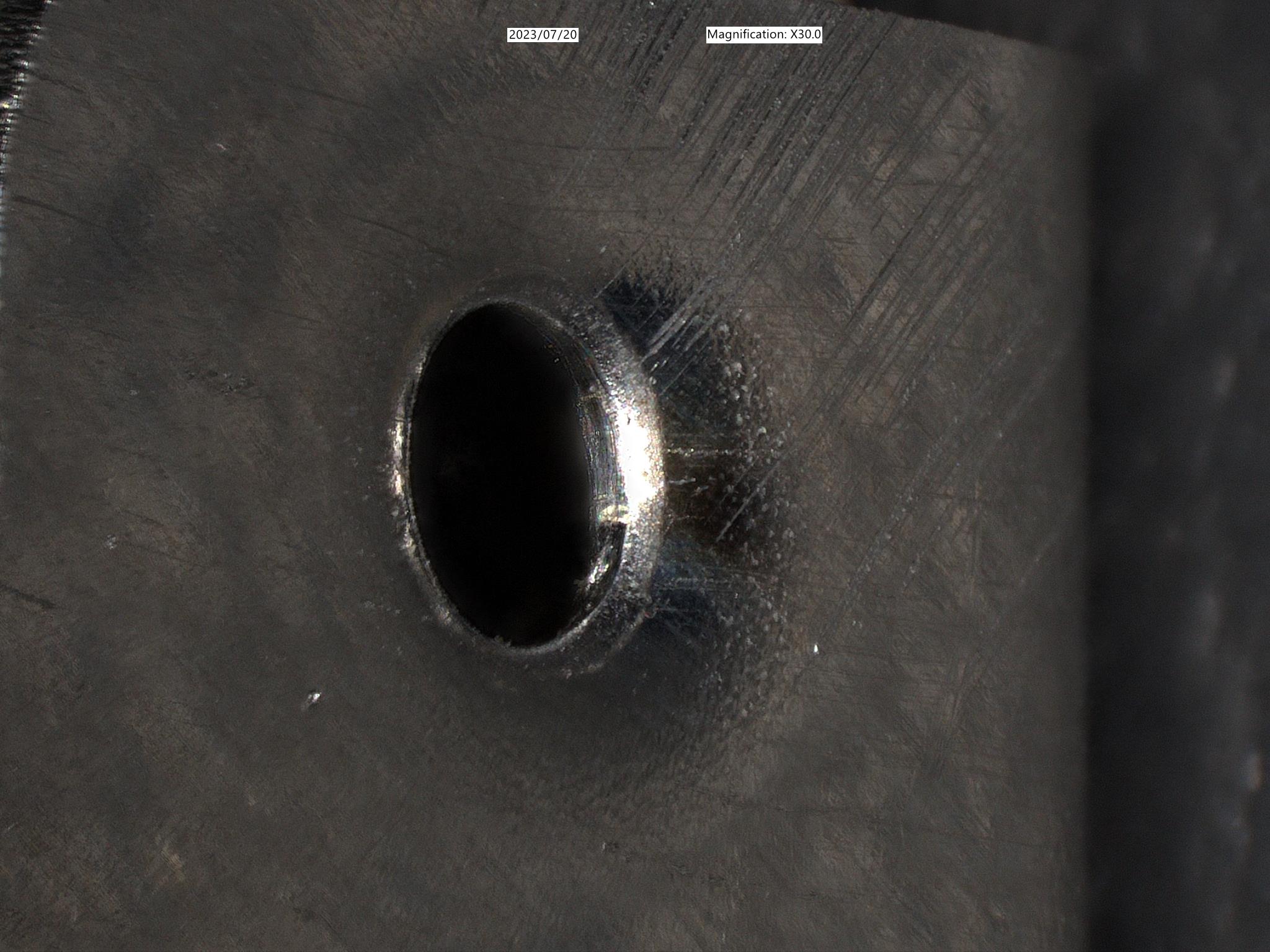

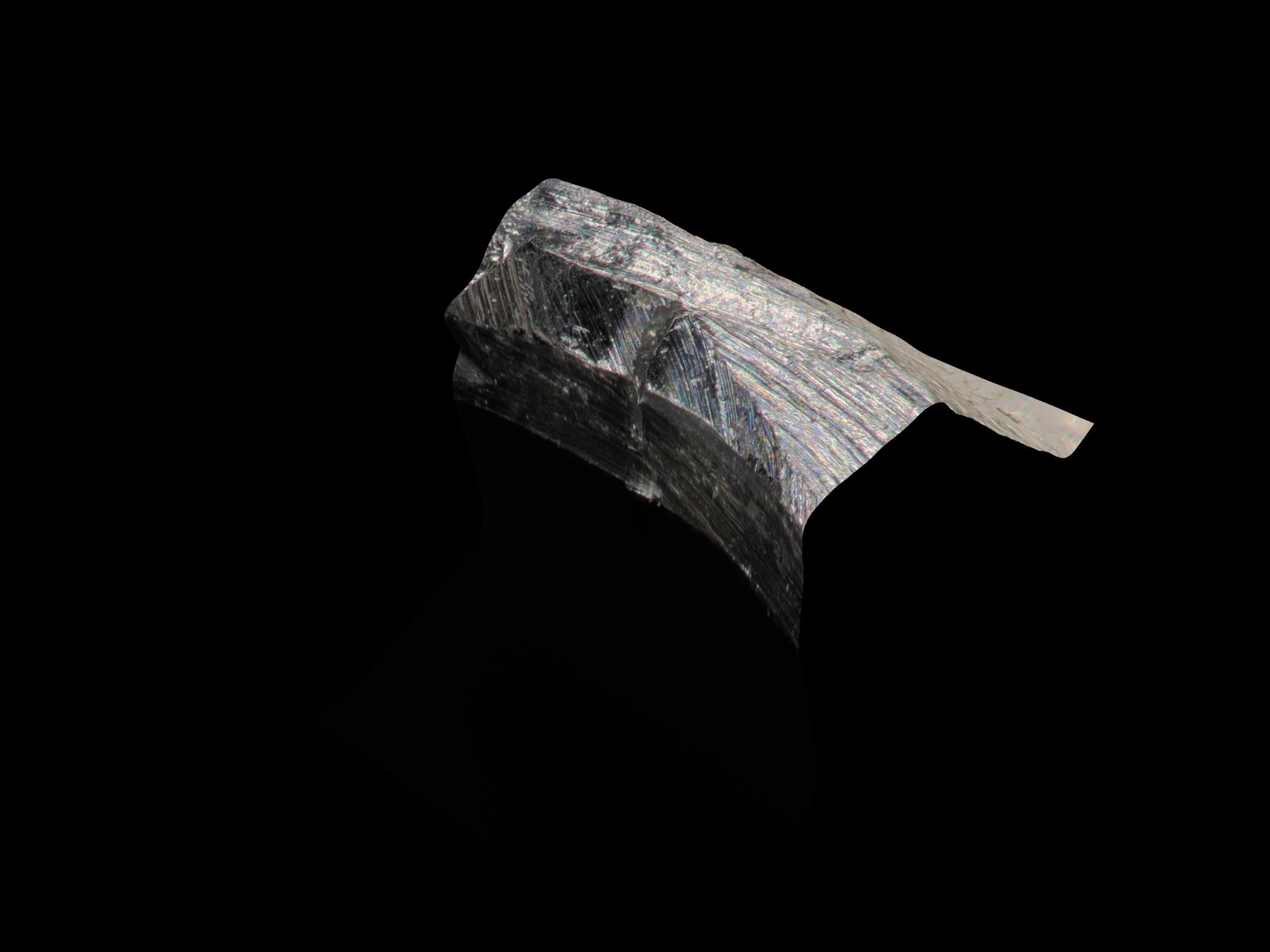

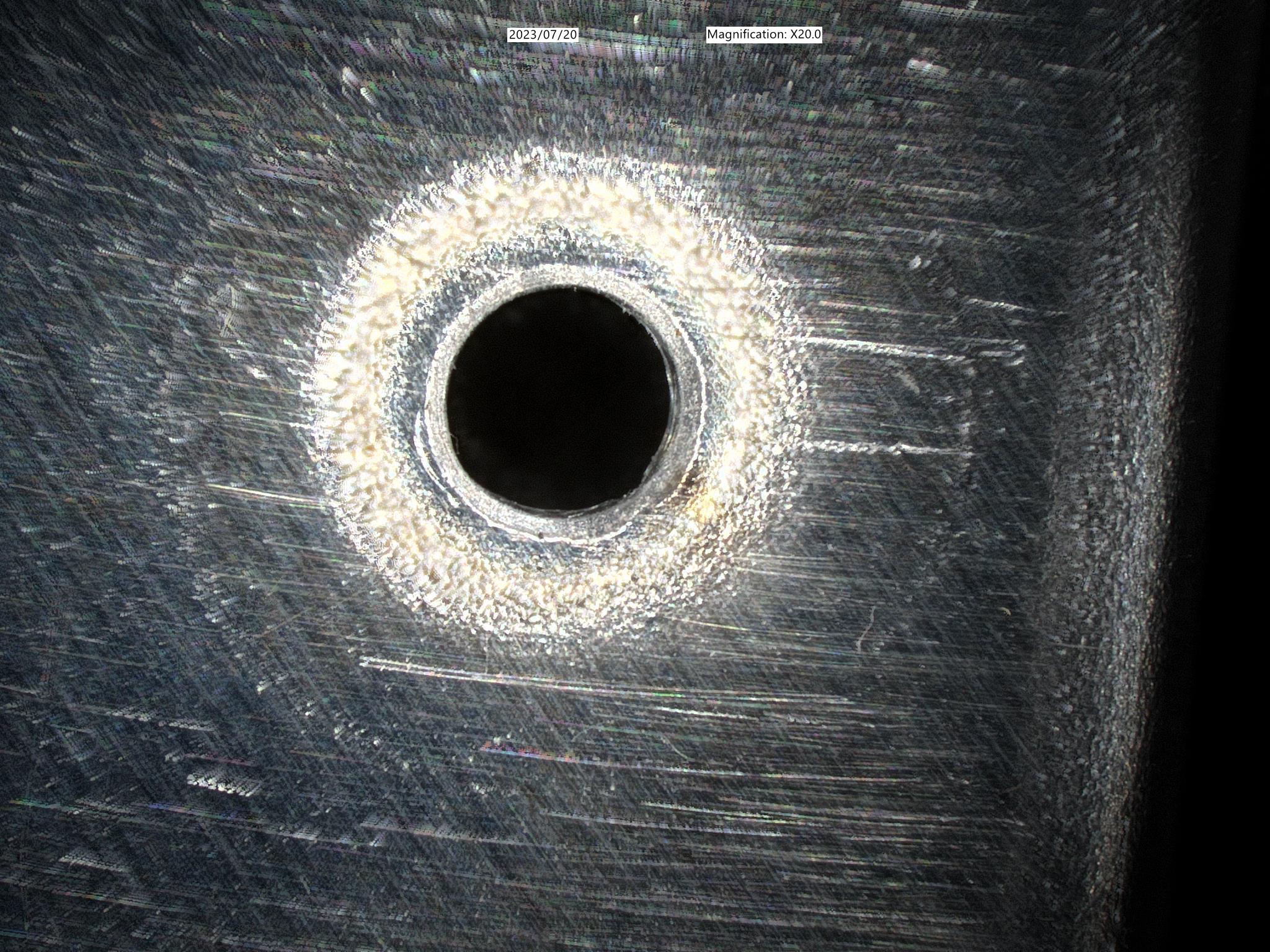

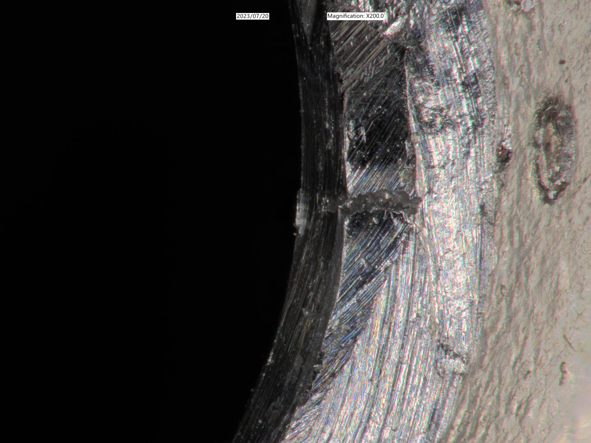

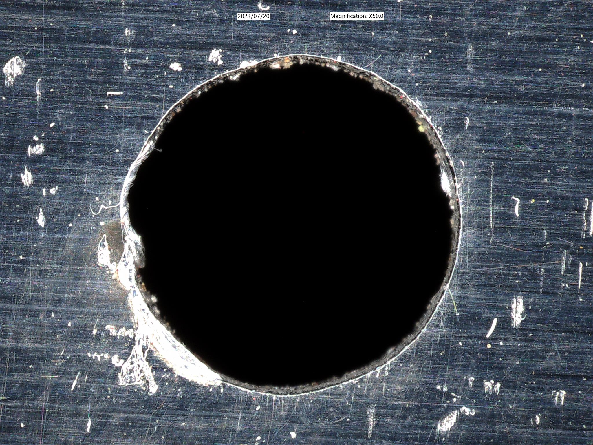

Good afternoon,
I'd like to preface my post by saying I am in no way a materials scientist, and these opinions are mine. I don't know what 'normal' dimples should look like under a microscope, or what size of imperfections would be considered acceptable. We should wait for the reputable lab, and Vans to draw conclusions.
However, the curiosity got the best of me. I took some parts to work and used our microscope to take some pictures of parts I was about to install. I noticed that nearly every hole that was dimpled on my F-1009, manufactured on 10/12/22, formed cracks. Some are worse than others. They all seemed to originate around the discoloration on the surface.
Image of an untouched hole from F-1009;
Image of a dimpled hole from F-1009;
Image of the same dimpled hole, 45 degrees;
b3z8UPo
View of the same dimple from the reverse side;
3D render of the same dimple from the reverse side;
Thanks for taking to time to post these. That's an impressive microscope you have there. Do you happen to have any photos of holes that had to be final drilled before dimpling? I'm very curious to see how those look under the microscope.
