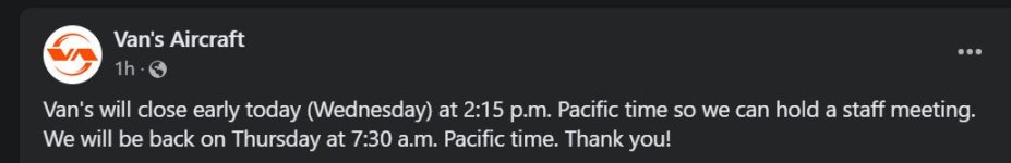

This was posted earlier today. Maybe this thing is about to move off bottom dead center?
I've just spoken with Vans re the current situation (I have a 10 QB for wings and fuse plus the finish kit paid for and was meant to have been delivered in September).
I was told that there's going to be an announcement in the next week as they've been gathering up the stats for the various orders that they have for both parts and QB's.
So hopefully we should hear something in the next 8 days.
Fingers crossed:)
