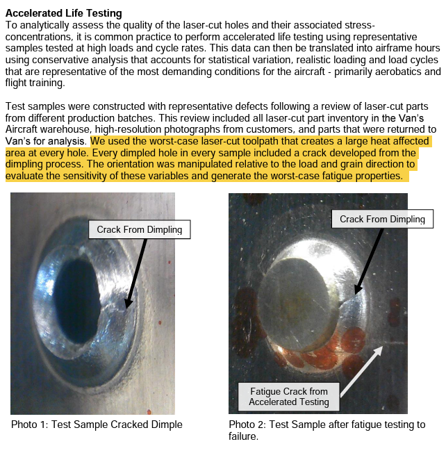

My opinion of the report is that it was done as a cost benefit analysis. The QBs are what has things mired up because reworking involves parts plus manhours. Many potential QB owners are likely to reject the QB assembly in its entirety and cancel the order and switch to slow build. I know I would. Leaving Van with a warehouse full of aluminum recycling which last I checked is less than 50 cents a pound.
They need to donate those things to a bunch of A&P schools and take the tax write off.
My opinion of the report is that it was done as a cost benefit analysis...
In my view, the report seems crafted to create a misleading impression that Van's would endorse the installation of parts with cracks. I find it highly unlikely that they would endorse such a practice, considering the extensive literature available and their own instructions condemning it.
They referenced AC 23-13A at the bottom of the report. That reinforces my suspicion they will never approve the installation of a parts with a crack given how clear AC 23-13A Chapter 6 is with "Flight With Known Cracks."
I have the exact opposite impression, which reinforces that the communication & documentation to date is falling short.
I know that nearly 100% of my LCP crack after reaming to final size, deburring, and dimpling. Even if I file that small crack(s) out, I know from others on this thread that many will crack at riveting - and with the primer and rivet, will be hard to spot.
Vans, to my read, is implying that these small cracks in LCP are OK. If they were to actually update section 5, etc. with acceptance criteria (how many, how big, which parts, etc.) I'd consider it - but this vague guidance is not acceptable.
On the upside, if Vans says it’s ok to fly with cracks, I’ll be heaps happier if my HS has stress relieved its attach points :D
If you read it carefully it’s very grey on that issue. In fact it never really mentions existing cracks from heat affected zones.
All references are to the chances of fatigue cracks forming. In the summary it says “it is very unlikely a fatigue crack should ever develop”. But that’s not the question you have. The cracks are already there. The question is, is it ok to install a part with an existing HAZ crack? Also what is the propagation rate of a HAZ crack and as you mentioned what is the limits. But if you follow the guidance of AC23-13A it’s all rather irrelevant. Unless you do an acceptable repair to every part that has cracks.
They claim to test a worse case scenario but don’t define what that is. Does that include parts with HAZ cracks? Or are those rejected because they didn’t meet the requirements of AC23-13A? I’m pretty sure they were not testing parts that look like the ones I’ve posted before. I’m also sure there is a near infinite combination of defects
Every hole in every laser-cut test sample has had a crack. We have updated the assessment document and posted it today, to help clarify this. See earlier post.
