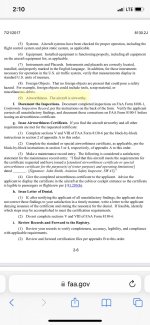

Incorrect. YOU alone are signing the document stating it is airworthy. No DAR signature involved. He may or may not give an inspection, but IT IS NOT an airworthiness certification. That is provided by your signature. I got my AWC from a FSDO guy. He may have looked at the plane for 10 minutes. He was clear that he didn't care, as it was ME that was signing off on the airworhiness of the aircraft, NOT him. This part he made VERY clear.
Your description seams to differ from the FAA’s

No, I didn’t “dodge” anything; I choose to try and stay out, as much as I can…your reply is telling of the reason why I choose to stay out.
If the engineering data said that in the worst possible, truly unrealistic case, the aircraft was safe for five lifetimes instead of seven, you would still feel that it wasn’t safe. It is, therefore, fruitless to attempt to “discuss” anything, as you have already made up your mind. That’s fair, it’s your build; build what you want.
As far as “hiding imperfections”, your words, I said no such thing. It is a widely known fact that the FAA and most DARs do not do an in depth inspection before they issue an A/W certificate… it is up to the builder to determine the airworthiness. Consequently, you are free to determine if you think the aircraft is or is not airworthy if it has “acceptable” LC parts regardless of what the engineers and third party firm say.
And you would be absolutely correct. I have made up my mind. As would most buyers when it comes to selling…..”so does yours have any LCP parts in it?”……yes but the engineers said they were ok……..now you decide……am I wrong?
Did he not sign form 8130-6?
Maybe others will actually take time to understand what the regs say vs what they just think they say.
What’s the point of an inspection if there is no point to the inspection? Can a DAR deny an airworthiness certificate?
8130.2j 2-3 seams straight forward to me. I haven’t seen a source that shows the DAR doesn’t inspect anything.

You posted the snip of the rules…yes they can. To your point, if most inspections really aren’t, what is the point?
That said, my inspection was done by a MIDO guy, and it was indeed an inspection…
Yes, the DAR confirms that the aircraft is airworthy. How does he do that? He has you sign a document stating that it is airworthy and place a similar set of words in the log book and sign it, stating that the plane is airworthy. Yes, the airworthiness must be confirmed before the AWC is issued, but his job ends at the part where you put ink to paper making your sworn affirmation that it is airworthy. The DAR signs no similar document attesting to the planes airworthiness and has no obligation to confirm that it is airworthy. He may do a detailed inspection as a value add contribution for hte $ you paid him, but that IS NOT an airworthiness confirmation. Ask an A&P how long it takes him to confirm airworthiness on a plane brought to him for annual. It is NOT the 1-2 hour walk around that the DAR does. I don't even think that being an A&P is a requirement for being a DAR. There job is mostly one of paperwork.
They MAY do one and even deny based upon what they see, but they aren't REQUIRED to do so. My FSDO guy looked at my plane for 5-10 minutes, then straight to paperwork and lectures. He knew less about airplane construction than my wife.
I believe many go to an experienced DAR for the value that they add in getting a second set of eyes on the plane for the builder to help catch errors prior to flight. This is quite valuable for many, but we should not confuse it as an initial airworthiness certification, as that comes ONLY from the manufacturer of the plane. The cert will only be issued by the FAA after the manufacturer states in writing that the plane is airworthy.
Anymore there is so much misinformation on this forum that I question even continuing to contribute.
I can only speak for myself but I’m sure most DARs will feel the same. Yes, the builder does the inspection and makes a statement in the logbook that they have found the aircraft in a condition for safe operation. The DAR makes a statement that the aircraft meets the requirements for the certificate requested. Before doing so, I give the aircraft a very thorough inspection, and it’s amazing what I have found over time. At least three times I know I have save someone’s life. No, I won’t go I to detail here and no I don’t lower my own build standards so stop with the silly responses). I take the inspection very seriously. I have a moral and ethical obligation to ensure to the best of my ability that the aircraft is safe, at least for the one time that I see it.
Yes, DAR requirements still require the A&P. Comparing the DAR inspection to an IA inspection is ludicrous. During the annual/condition inspections not only are discoveries made, but they are fixed. Maintenance is done. Repairs are made, ADs are checked for compliance, etc. Yes, that takes more than 1-2 hours. On a brand new airplane, none of that is necessary. We can focus on the construction and safety aspect.
Yes, a DAR can issue a Denial. I’ve only done it 3 times in 15 years, and all parties agreed. It’s not a big deal. One has to rectify the problems and then reapply for the airworthiness certificate.
This is way off topic for this thread, but I wanted to correct the misinformation.
For those who wish, take the time to read FAA Order 8130.2J. It will help you understand the list of things DARs/Inspectors are required to check. In fact, we have to fill out and sign a 8100-1 conformity document listing all of those required items and stating we checked them.
Sorry, but you don’t understand the term Airworthy as it plies to E-AB’s. A DAR does not attest to the fact that an aircraft is in a condition for safe operation - the builder does that. I recently spent a week at the FAA academy (where I did actually stay in a Holiday Inn….) going over the rules, and I can assure you that’s the case.
Ok I admit the term “airworthy” has a different definition when it comes to E-AB because there is no definitive guidance for experimental airworthiness. I always understood the term was vague at best when it comes to experimentals.
I thought it was the DARs responsibility to conduct the inspection outlined in 8130.2j 2-3(e) but now I’m not so sure. Whoever does it, one item says “the aircraft is airworthy”. It is irrelevant if that means “safe” as opposed to a well defined term

Yes, the DAR confirms that the aircraft is airworthy…
