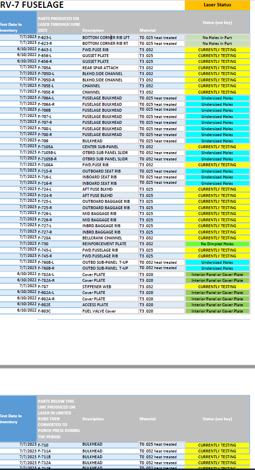

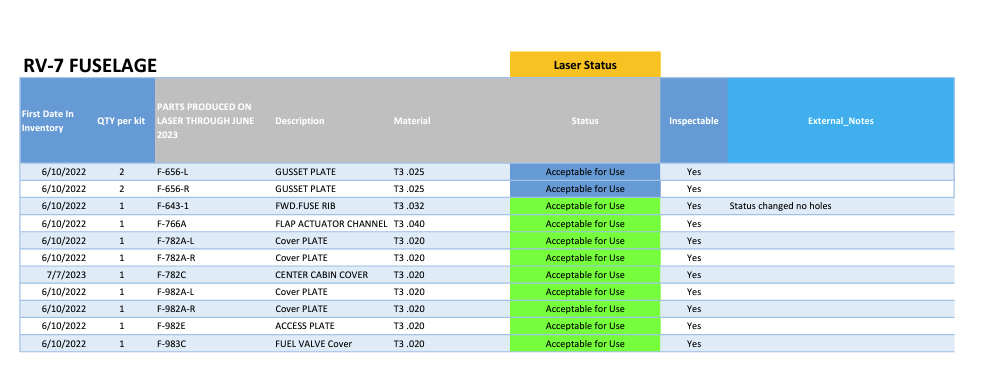

Do we know why the RV7 fuselage is so much shorter than it was?
Current list:
Old list:
