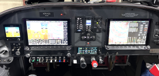

Panel Prep …Biggiesauls
Six months after Phase 1 I decided to add IFR capabilities and start training To my existing dual Dynon HDX panel. Added Garmin GPS-175 and G5 all tied into the Dynon and autopilot. Works sweet.
