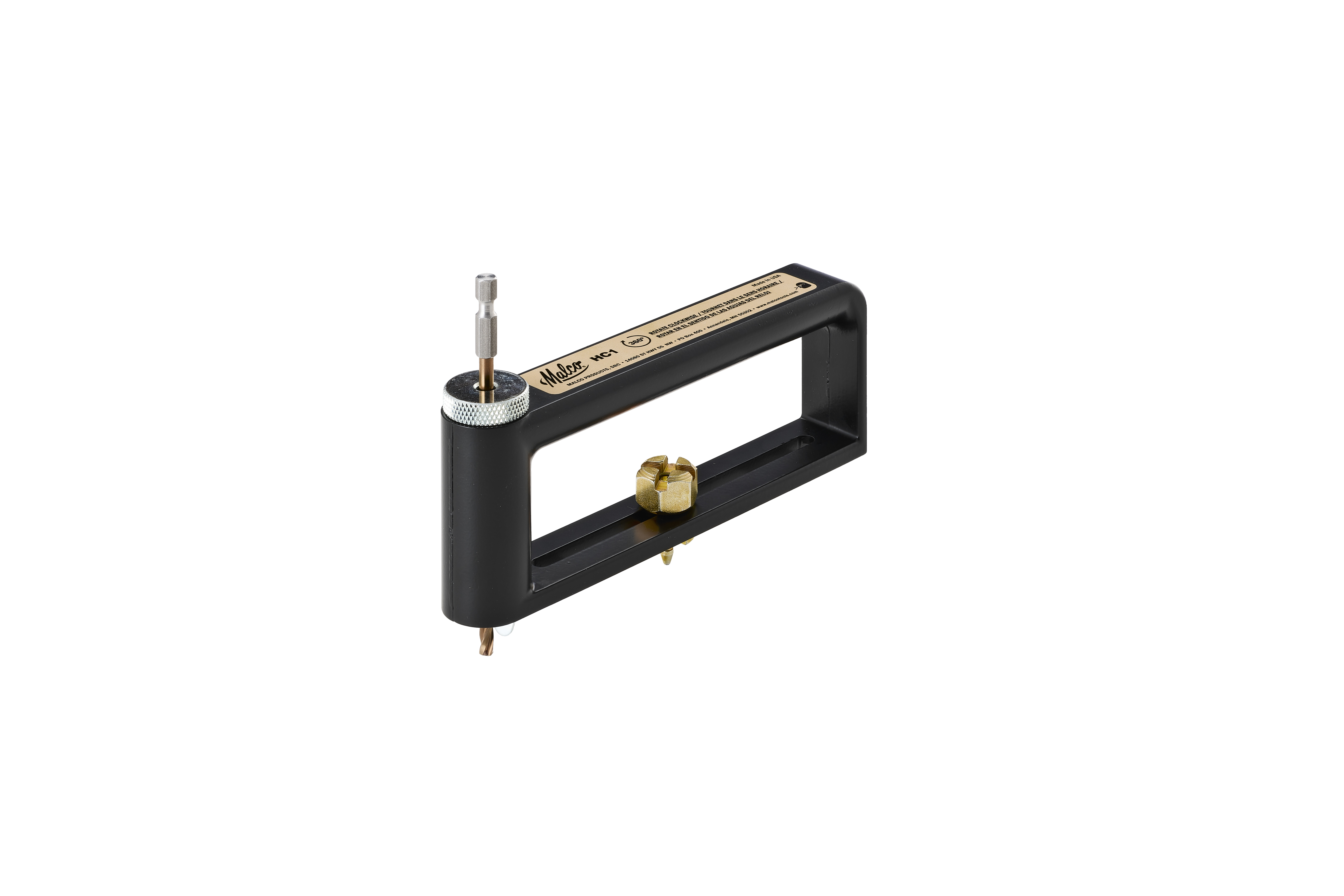

I decided to add an extra access port in the bottom of the port wing. Two reasons: 1) obtain better access to the pitot and AOA hoses and wiring of the pitot heater and, 2) obtain better access to rivets for riveting the pitot tube and the forward-most skin rivets which otherwise can't be reached (at least by me).
Thanks to Wirejock for the hole cutter. It did the trick.
