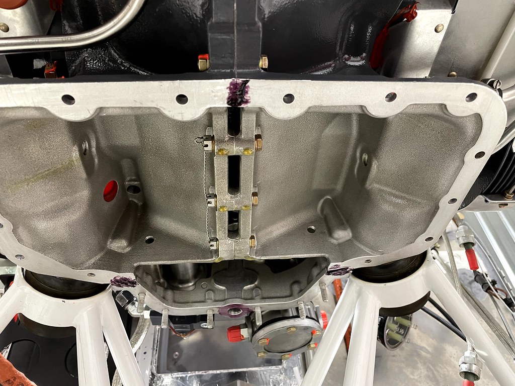

It has been awhile since I posted an update. Long story short after getting my engine back from the builder there was a problem with an impulse coupler on the left mag. This was after I had it aaaalllll hooked back up again. Here is the thread detailing that incident if you missed it. (pictures on second page) I sent the mag back to my builder for evaluation and eventually it will make it's way back to Champion. I'll update the findings later but at this point everything is pointing to a manufacturing defect.
When the impulse coupler decided to take a **** it also put just enough side load on my crankshaft idler gear and deformed slightly the tips of two teeth. The damage to the teeth is subtle but in my opinion it needed replaced. I unhooked the engine yet again and pulled the sump and accessory cover. The idler gear needs replaced (waiting on new one) but luckily everything else looks perfect! I also took the opportunity to search the sump and accessory housing looking for metal. Not a single spec of metal was found. Thank goodness! The repair is also being performed following recommendations from Lycoming. Check the other thread for a later update.

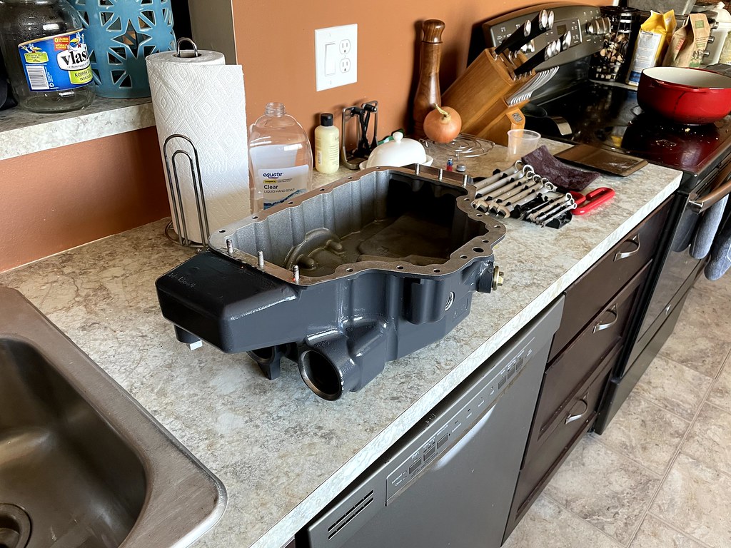

Since I had to take my sump off and the hangar has been cold lately I decided this would be the perfect time to install the new Reiff sump heater I got! :)
After bagging the engine to keep moisture out here we are. Don't tell the wife I did this on our kitchen counter. :D

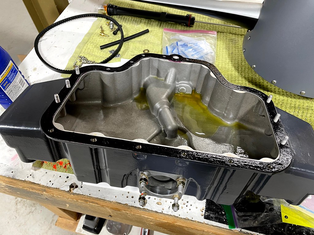

Here I am taking all of the fittings out of the sump so I can wash it with some dawn dish soap and water to keep the oily mess down.
IMG_0370 by Jereme Carne, on Flickr

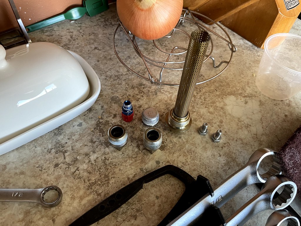

Here are all the parts that came out of the sump. They just happen to be sitting next to my dinner. :D
IMG_0372 by Jereme Carne, on Flickr

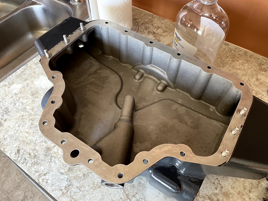

Here is the inside of a clean sump if you have never seen one.
IMG_0373 by Jereme Carne, on Flickr

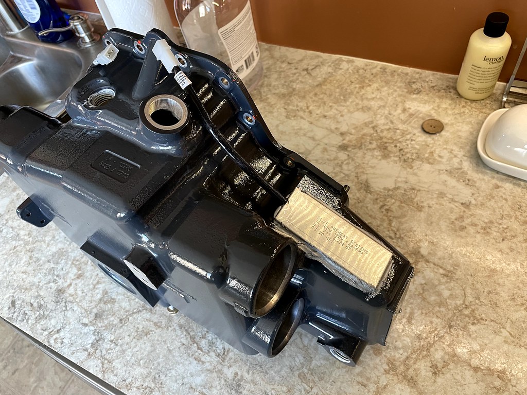

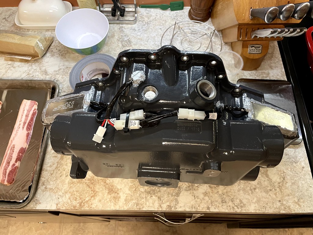

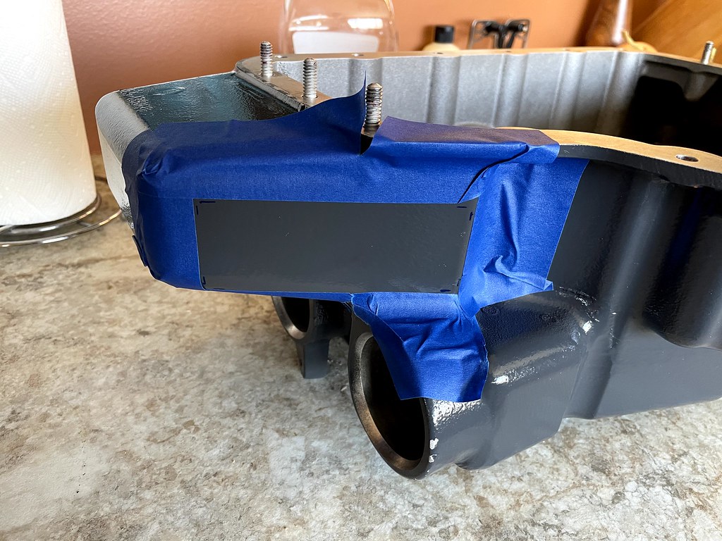

Next up, tape the perimeter of the sump heaters in preperation of removing the paint.
IMG_0374 by Jereme Carne, on Flickr
Next mix some of the fancy Aremco epoxy that is just about as thick as proseal. Apply and place the heaters.
IMG_0375 by Jereme Carne, on Flickr
Now I wait for the epoxy to cure and then I will go back with more epoxy and cover the perimeter of the heating elements per the instructions.
This is my version of "when life gives you lemons".

Here is the finished product. Everything is better with bacon. :D
IMG_0377 by Jereme Carne, on Flickr

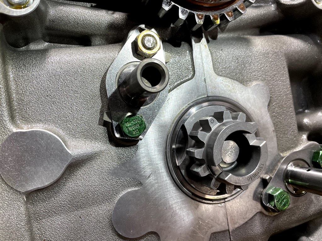

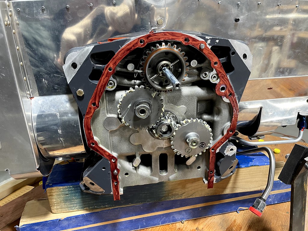

Okay, as many of you know I had an impulse coupler decide to break apart on my newly rebuilt engine. The engine had to once again come off so that I could take the sump and accessory case off to change a gear and look to see if any metal entered.
Luckily not a single piece of metal was found anywhere inside the engine; it was totally captured by the mag spacer.

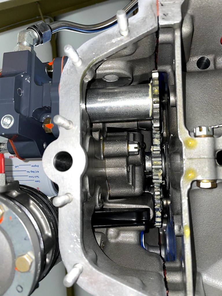

Long story short there appears to be a manufacturing defect on the impulse coupler flyweights. See this thread for more details/closure on that topic.
Darren at Aerosport was awesome to work with and answered all of my questions so I could get the engine fixed. They warrantied most of the parts as well. (I chose to change two out of my own piece of mind) They even let me credit the bad mag towards a Pmag (no more impulse couplers for me!!!)
In the end I replaced the crankshaft idler gear due to two slightly deformed teeth, the idler gear shaft and bolts/nuts out of caution, and the crankshaft gear out of caution. While replacing the crankshaft gear I followed Lycoming 475C and the supplement. They provided an awesome amount of detail on how to do it properly. I sincerely doubt anything was wrong with the crankshaft gear but I changed it out of piece of mind and Lycoming recommended it come off to inspect the dowel pin (which was undamaged).
Here is a shot of the crankshaft gear and idler shaft after replacement.
IMG_0409 by Jereme Carne, on Flickr
Here is a shot of everything put back together with a new gasket ready for accessory case mating.
IMG_0420 by Jereme Carne, on Flickr
After quadrouple checking to make sure everything is in order (cam timing marks, etc.) and prelubed the accessory case was bolted on. Following is a picture showing how all the gears mate together, you can also look closely and see how the oil pump shaft mates with the crankshaft gear.
IMG_0424 by Jereme Carne, on Flickr
Next it was time to make sure everything was in order for sump mating. There are just a few areas that need a bit of sealant first.
IMG_0426 by Jereme Carne, on Flickr
After the sump gasket is ready it was bolted on.
IMG_0425 by Jereme Carne, on Flickr

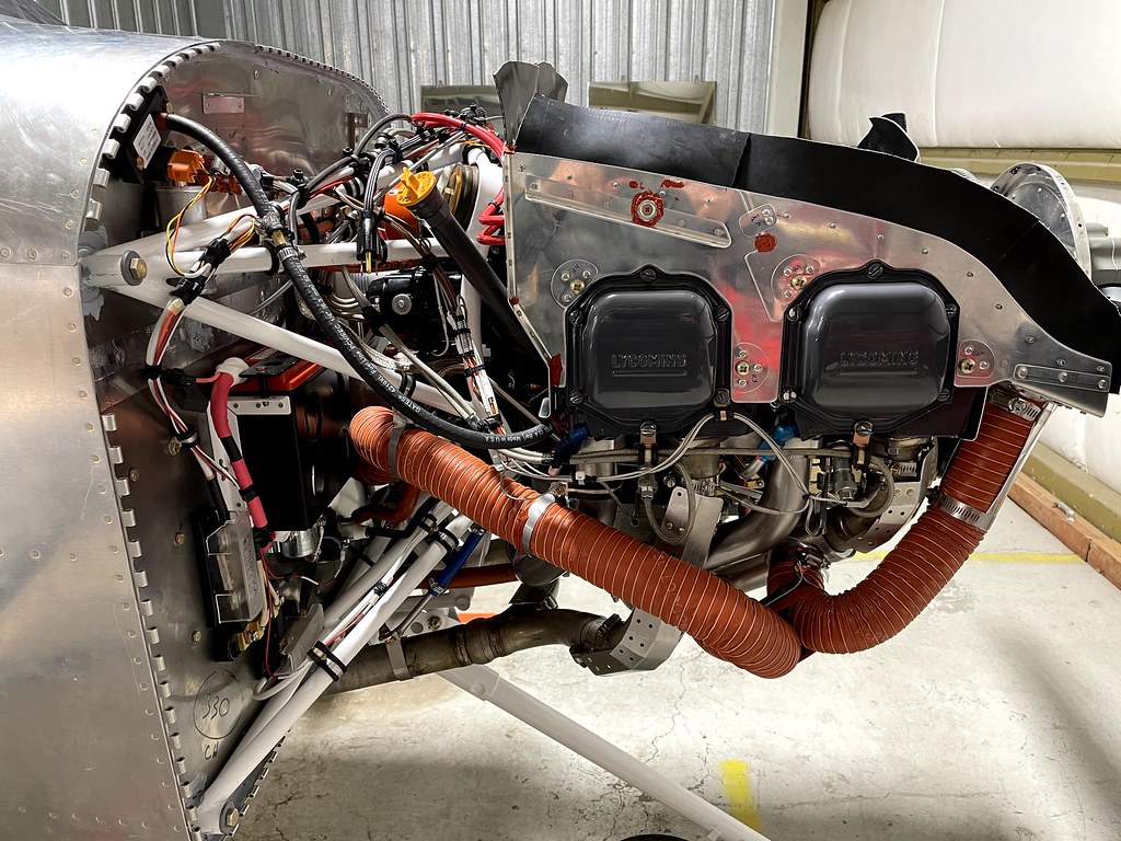

Well I'm currently waiting on my airworthiness inspection which should be Tuesday of this week. It was supposed to be two days ago but we had to resubmit the application to the FAA in order to make some changes. The new AWC system isn't too bad but it is TERRIBLE if you need to make any changes!!! Good thing my DAR has a contact at the FAA because he had to call them to cancel the old one.

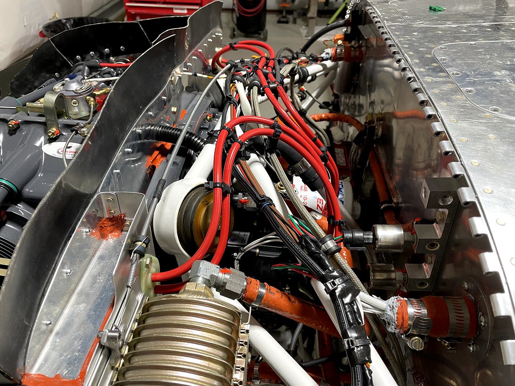

In the meantime I realized that A. I have nothing better to do at this point and B. I forgot to post pictures of the new FWF setup.

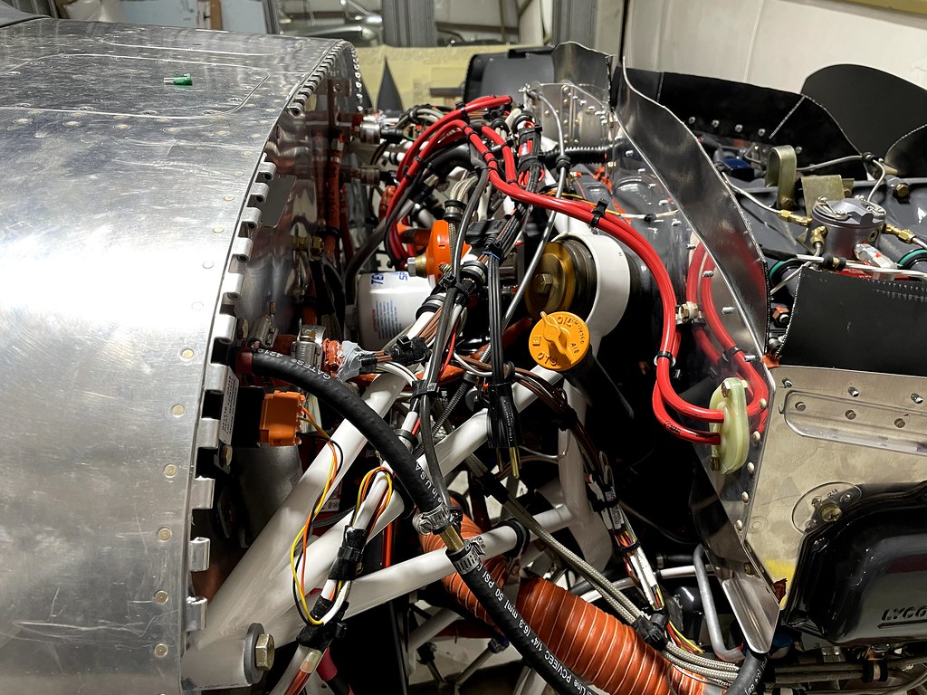

Here is the new setup on top of the engine. Sooooo glad that I can get a socket AND the torque wrench in there to tighten them plugs now without taking any baffle pieces apart! :D
IMG_0472 by Jereme Carne, on Flickr

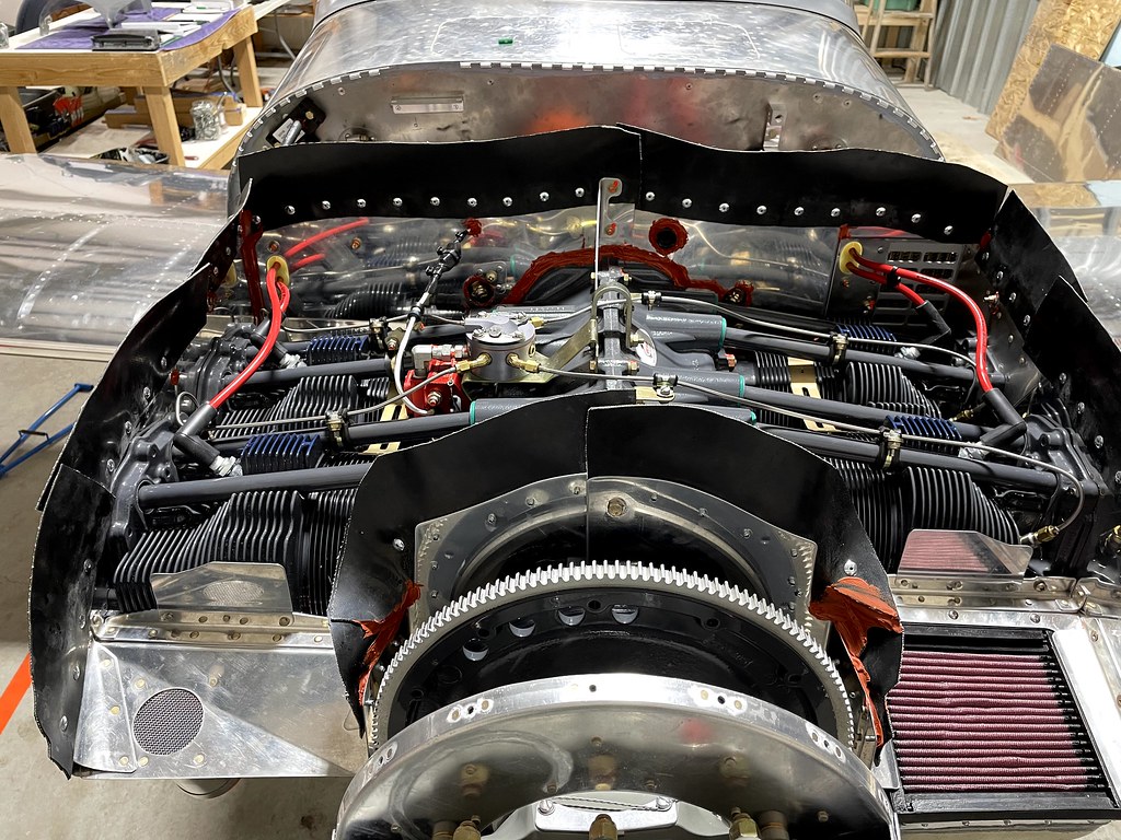

Starting from the right now...
IMG_0471 by Jereme Carne, on Flickr
IMG_0470 by Jereme Carne, on Flickr
Over to the left side now. You can see that sweet new oil cooler heater here!
IMG_0473 by Jereme Carne, on Flickr
In this one you can really see the cable routing on them new Emag wires. Kind of a pain that you have to separate them but no big deal.
IMG_0474 by Jereme Carne, on Flickr

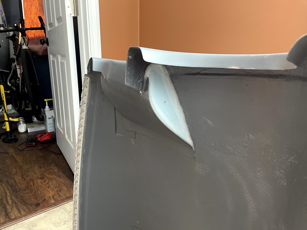

I also decided to close out the cowl inlets with a bit of foam and a bit of epoxy/cab/flox mix. The baffle seals in this area were already pretty good just by feeling it but I think this will make it better!
IMG_0443 by Jereme Carne, on Flickr

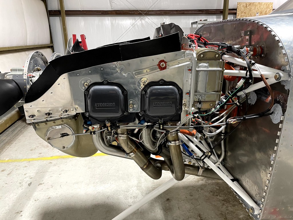

It has been snowing like crazy out here lately but I even got some time to get out and about!
IMG_0467 by Jereme Carne, on Flickr
As always, let me know what you guys think and especially if there is anything you think that could be better! Inspection is only a couple days away!
Very neat Jeremy good job! I like how you shielded the heating scat from exhaust pipe. Good luck on airworthiness inspection.
Hey there Jeremy- On the 4th picture down, it looks like there might be a line of some kind that could rub on the breather tube. Might just be camera angle, but if it's close, some kind of standoff there might be appropriate.
Great looking install. I've been following your build since I pulled the trigger on building myself. best of luck.
Thanks Vlad! When I get this thing out of phase 1 you will have to show me around the better parts of Utah! You will also need to pop on up here to explore the Big Horn basin.
Thanks for taking a close look Terry! It is definitely a camera angle thing going on there. If you are talking about the black wire it is about a foot away.
When I look at all the wiring I almost shat myself...how will I ever get all that done!
Holy Moly!
Well one connection at a time I guess...
I was talking about the gray line behind the black wire. looks like it might intersect the vent line down low where it starts to turn fwd.
Buy in any case, you're welcome. second set of eyes and all that :)
Every time I see a picture of a engine installation (your looks great BTW) my mind explodes with all the tasks and decisions that await me that I don't even have a clue about now....
My engine arrives in 6 weeks and firewall forward kit to be ordered today.
I think he's talking about what appears to be the fuel pump overflow/vent line.
I think you will find FWF to be the most fun part of the build! One thing at a time. Although this time you can finish multiple things in one day unlike most of the rest of the build!
Ah yes, I think you are right Mel. In that case DesertRat it too is a camera trick. There is quite a gap between the two. I would estimate 2-3 inches.
Thanks again for the eyes!

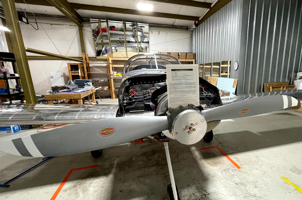

Well, only one more big milestone left I suppose! Followed by mass quantities of fun I hope!
The DAR inspection went great! I had everything ready for him and a lot of the paper work was taken care of before he even got there. His help in dealing with making changes in AWC was big!
Tim Mikus did a great inspection on the plane and the 2.5 hours he was there was quite a joy actually; had some great conversation during the process. He said the work looked great and the only thing he found was that there needed to be labels on the throttle, prop, and mixture controls. No biggy to add.
It sure was a rough journey to get to this point at times but I'm glad that one is behind me now! Next up, transition training in a little over a week and then first flight! :D
