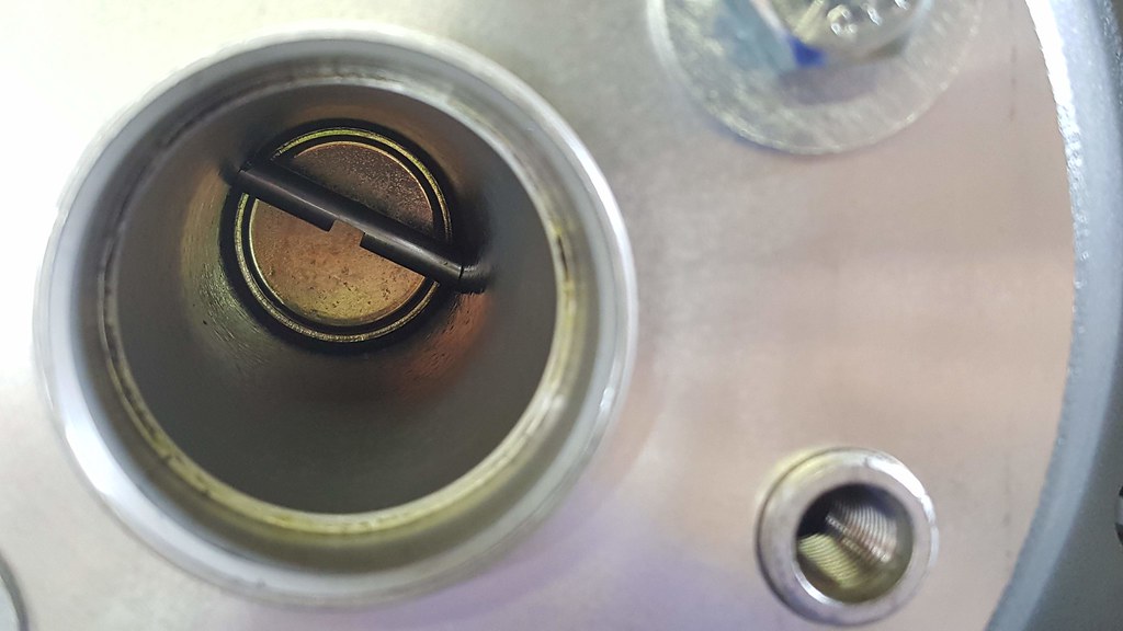

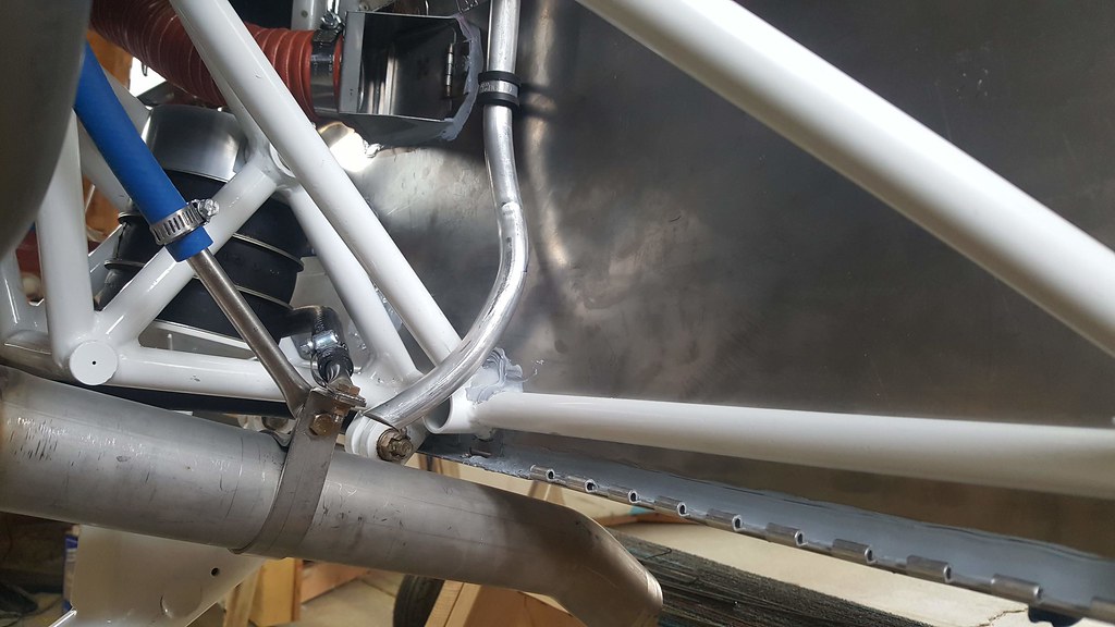

Before installing the exhaust I decided to reverse the intended direction of the throttle bracket. It sounds like this is quite common. There is virtually no clearance with it the other way.
20200716_103323 by Jereme Carne, on Flickr
However, you have to bend the bracket a bit so that the flange doesn't hit the bottom of the engine. Just wrap it with some tape and bend away. Seriously, get the bend spot on pointed where you want it! I had to take it alllllll apart again after getting the cable hooked up because there was a little binding. Now that it is lined up perfectly the cable moves smooth as silk.
20200716_102824 by Jereme Carne, on Flickr
Here it is all hooked back up.
20200716_124536 by Jereme Carne, on Flickr

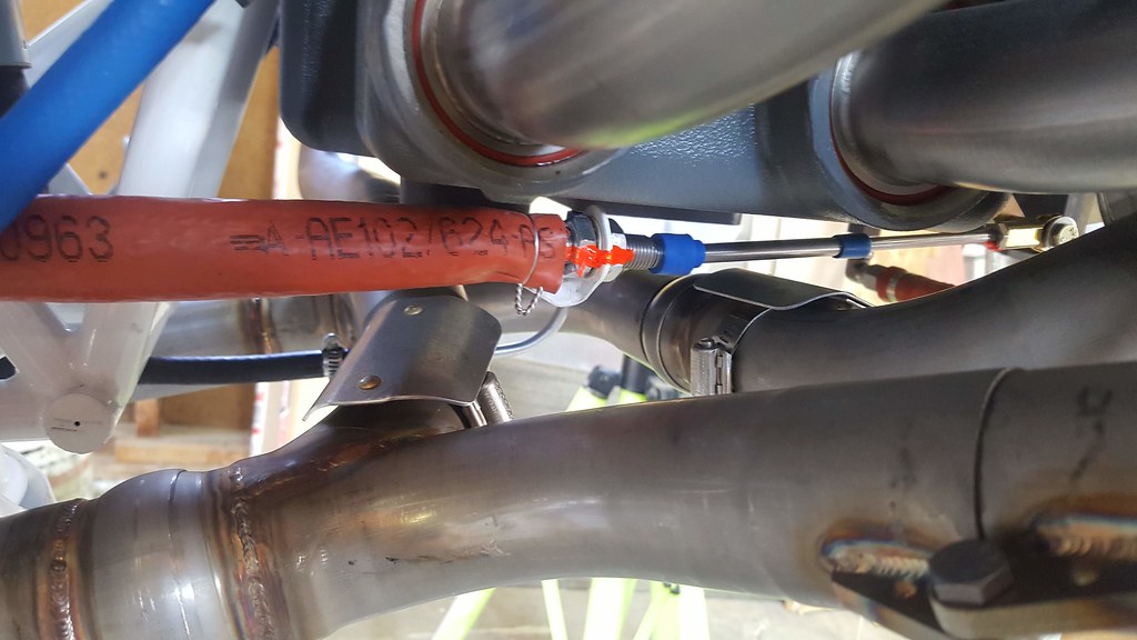

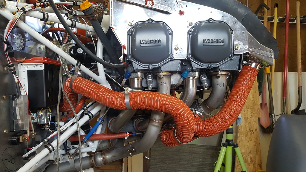

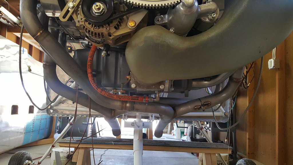

Then it was on the the Vetterman exhaust. Clint does a stellar job making exhausts as many of you know, it was well worth the wait for it!
20200716_124528 by Jereme Carne, on Flickr
Another view. Don't worry about the wiring, it will get tidied up in the next post! :D
20200716_124551 by Jereme Carne, on Flickr

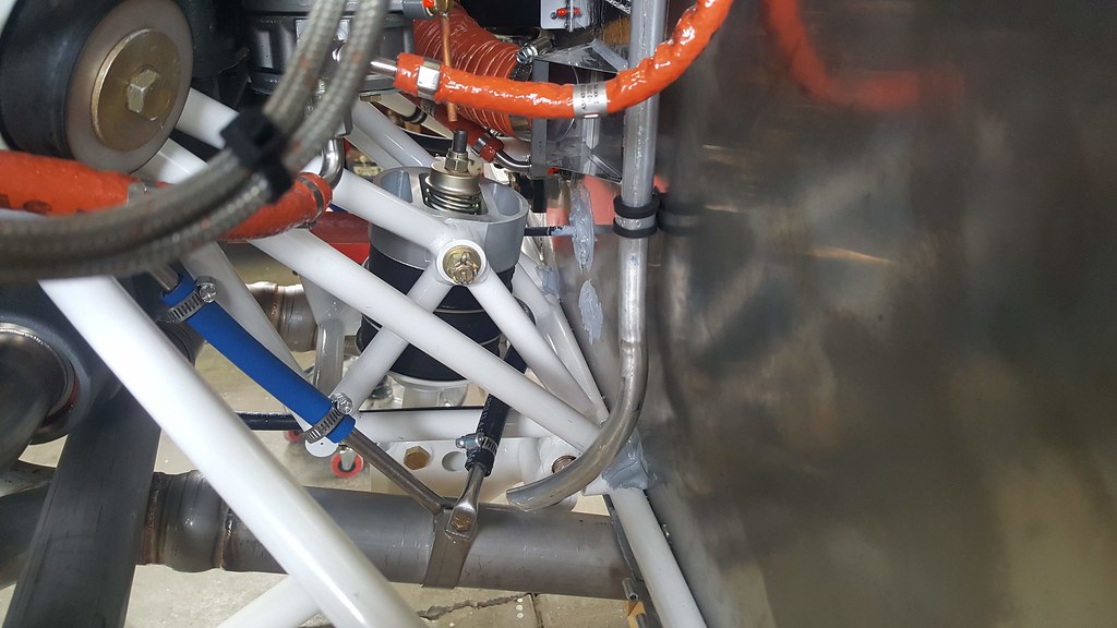

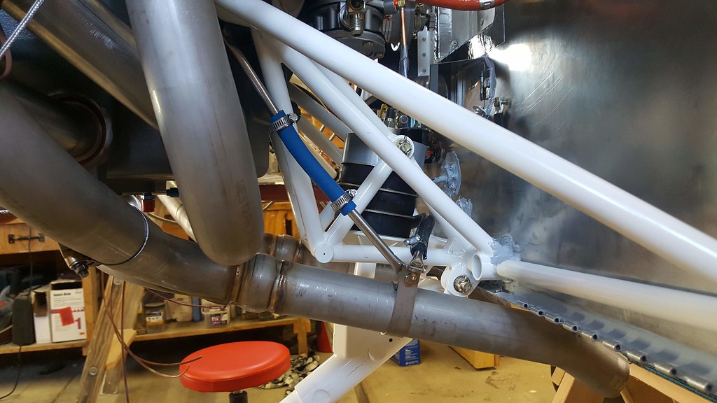

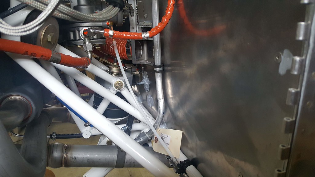

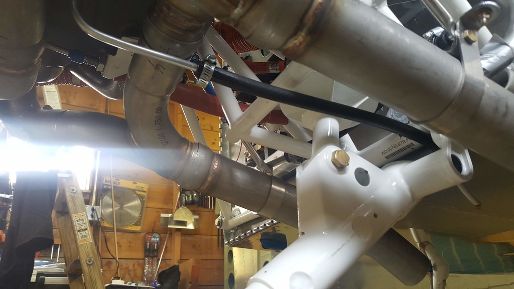

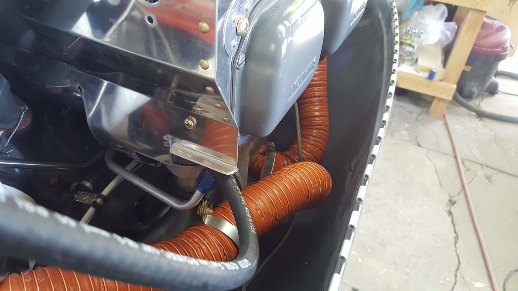

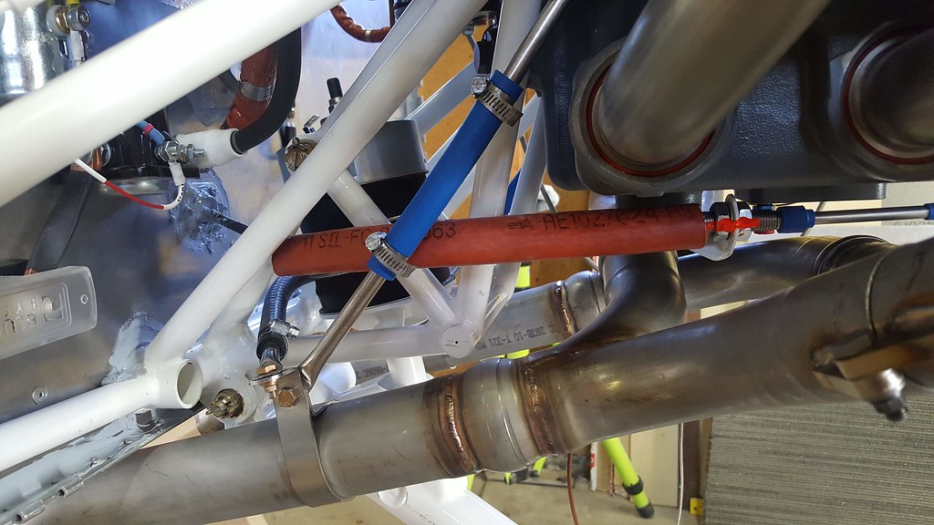

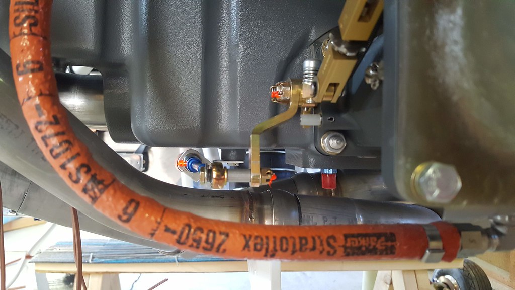

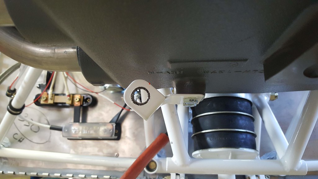

Here is where things get a little tricky. I have the new nose gear and Van's basically says, hook the exhaust up like in OP-54. Ummmmm, yaaaaah, that's not going to work... I gave Clint a call and we did a bit of brainstorming as it sounds like he hasn't seen a final finished job on the new nose gear yet. He said the horizontal support is no where near as important as the vertical. I came up with this idea and text him a picture. He said it looks good and it will work.
I will probably throw some RTV on the engine mount just to make sure the rubber hose does not rub the tubes.
Also worth mentioning, I had to go down to NAPA and buy some 3/8" fuel line as the blue stuff Clint sent wasn't long enough for this approach.
If anyone has a different method they did on the new nose gear I would love to see it.
20200716_170425 by Jereme Carne, on Flickr
Here is the other side.
20200716_170357 by Jereme Carne, on Flickr

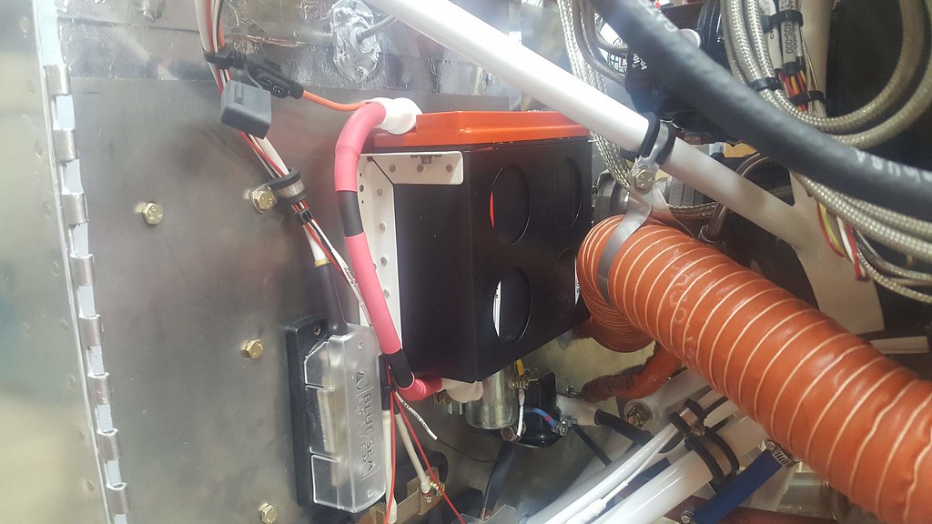

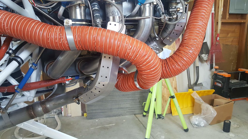

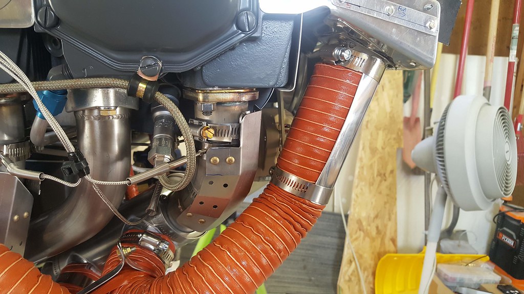

Thanks to some help on VAF I also finalized the routing on the cabin heat scat. For those of you not to this point yet I strongly recommend you get a custom heat muff that will not take the intake outboard. Not that it won't work like this, it's just a pain to install as the clearances are close.
20200718_123553 by Jereme Carne, on Flickr
Here you can see the clearances.
20200718_123246 by Jereme Carne, on Flickr

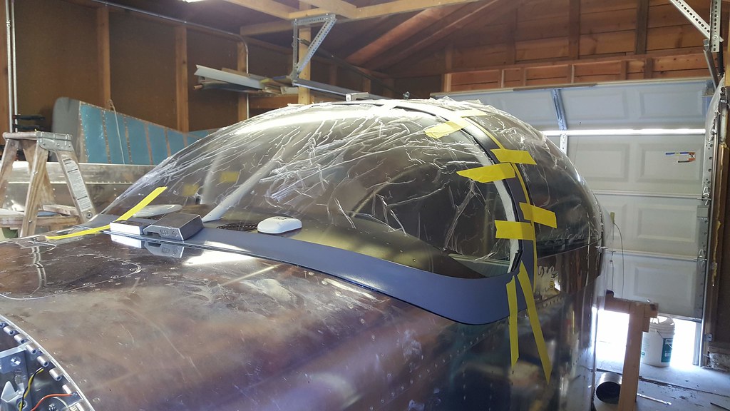

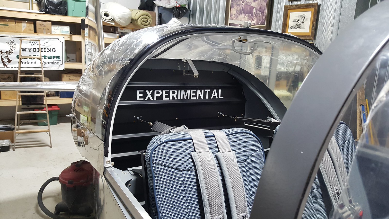

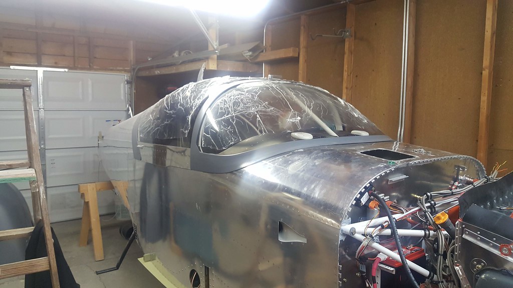

As promised the windscreen trim is bonded on with Sika. I have a little edge cleanup to do inside the canopy but the canopy at this point is done!!!!!!! :D
20200721_120432 by Jereme Carne, on Flickr
20200722_222531 by Jereme Carne, on Flickr

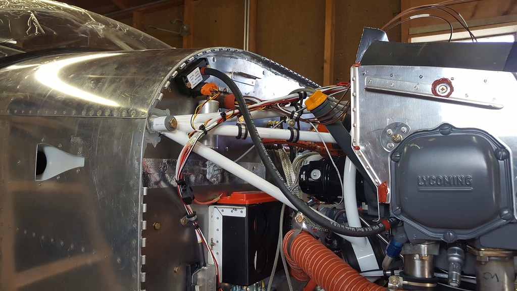

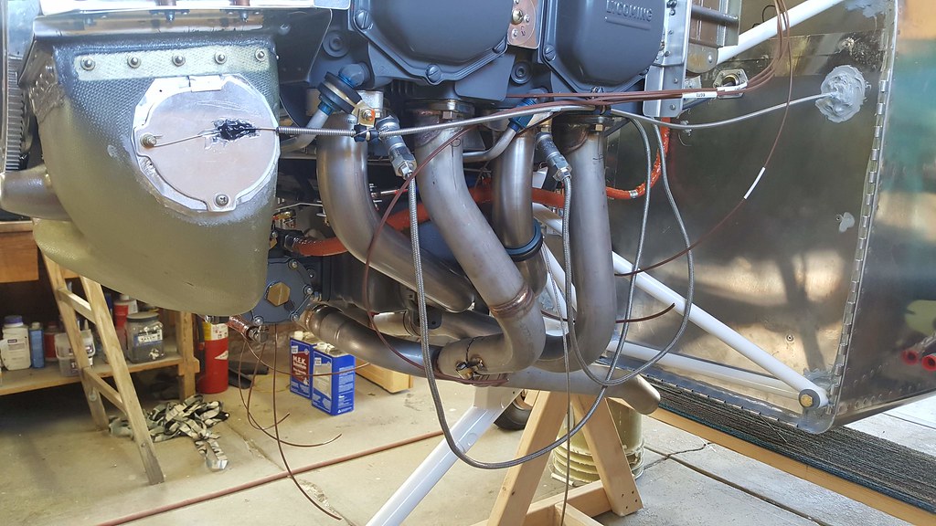

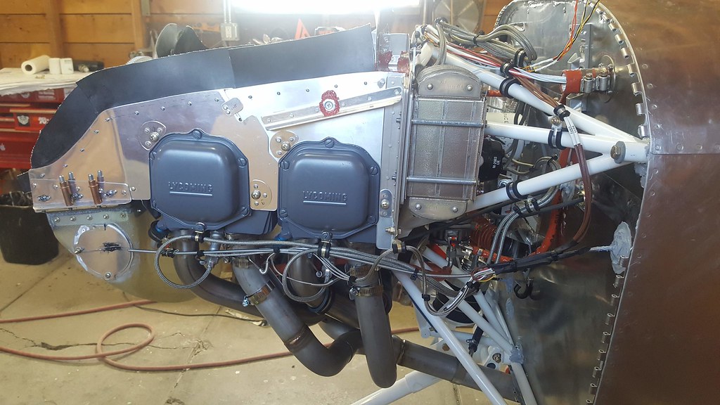

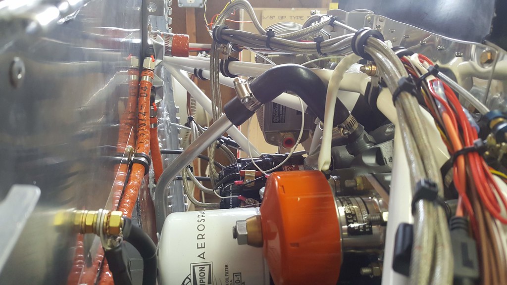

Next I installed the CHT and EGT sensors so that I could finally get some of this wire cleaned up. Drives me nuts having wires just laying all over.
20200718_185007 by Jereme Carne, on Flickr
Here is the far out view of the right side.
20200719_140416 by Jereme Carne, on Flickr
The other side for you.
20200719_140429 by Jereme Carne, on Flickr

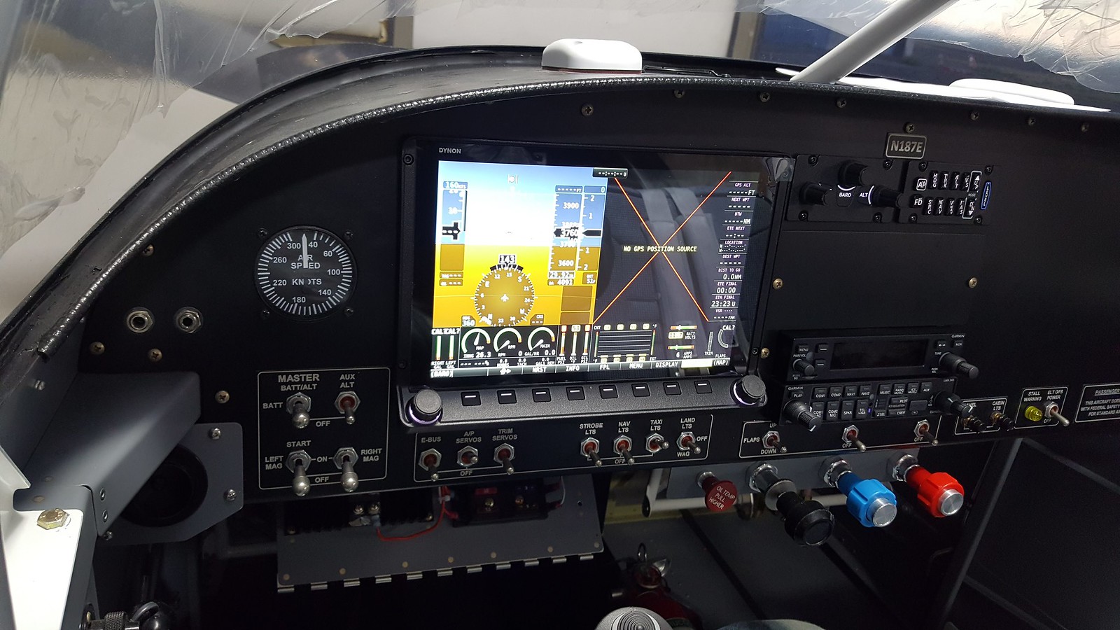

Even got my new PC-680 battery installed and hooked up. Everything so far seems to work and there is no smoke being released from the panel so I must have done something right. :D Also notice how I undid the connection to the start relay just in case...
I did have two minor issues to sort out though. The first was I tried to interrupt the ground on pin 2 going to the A/P panel with a switch for emergency cutoff but the motors are still getting ground somehow; I'm betting the network ground is interconnected. I changed the switch to interrupt the power on pin 9 instead, only took about an hour or so to change and it works perfectly now.
The other issue was I had a jumper wire slightly wrong on my E-bus relay and it wasn't switching with the main bus off. A simple move of the jumper and that issue was fixed.
At this point it doesn't appear there are any other problems but we will find out when I have ALL of the avionics plugged in.
20200722_222557 by Jereme Carne, on Flickr

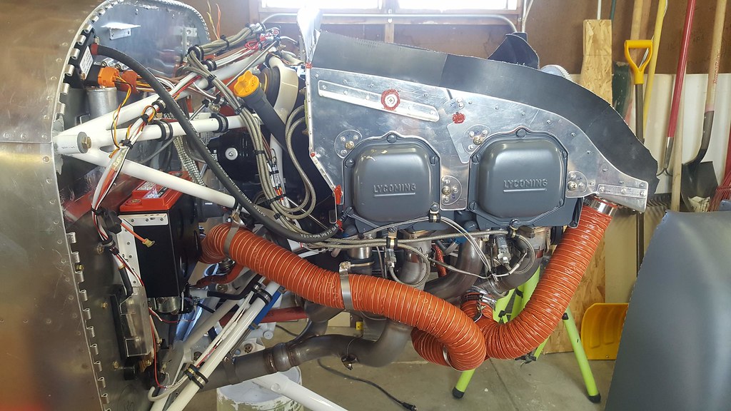

More firewall forward stuff completed today.
I installed the heat shields that I got from Anti-Splat. These things are awesome! Very easy to install. The only problem I had was that the rivets they included seemed a bit on the short side. I used some larger AN470s, no worries.
I think I will try a flight or two with the clearance between the shield as shown in the pic. If it is too close I will go with Dan H's fiberfrax trick. Who knows, I may change my mind before then and just put some fiberfrax on it.
20200723_103439 by Jereme Carne, on Flickr
The other heat shield was intended for the outflow scat but I thought what the heck, let's extend that puppy on down and protect the cowl even more. I'm putting fiberfrax on the cowl so this is just a little extra insurance right there.
20200723_103443 by Jereme Carne, on Flickr

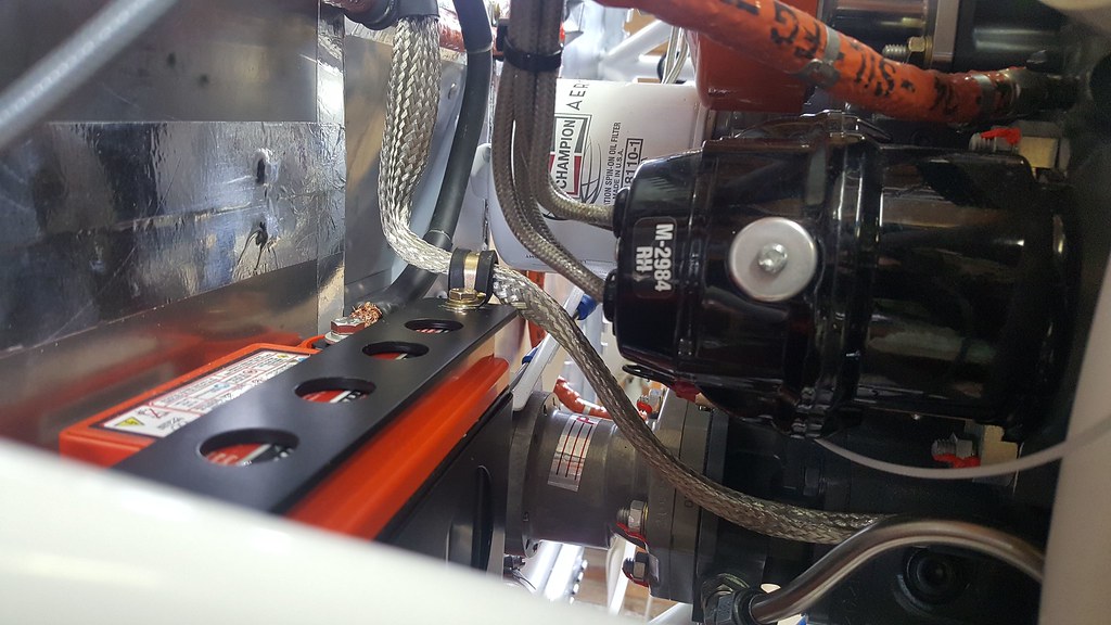

I put the battery retainer in and used an adel clamp to secure the engine ground so it wouldn't flop around and rub on some parts. There is still plenty of room for it to move, I think I just made the cable a little too long in the first place.

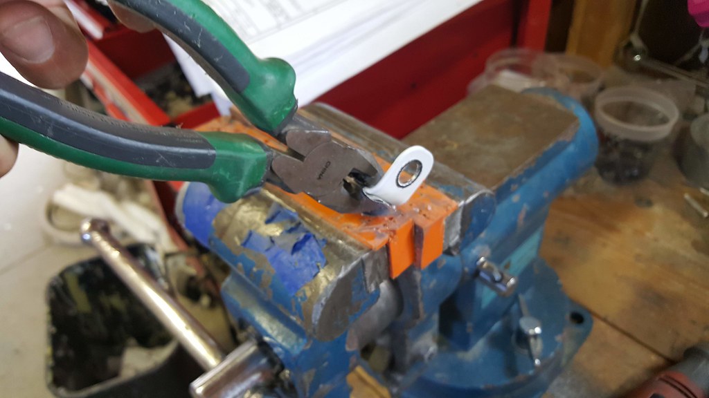

Now the breather tube... I feel that Van's does a truly good job in manufacturing these airplanes, but there are some things that are less than ideal. The breather tube was one of them. The bends on the breather tube interfered big time with the new nose gear design. I tried my best to bend it but in the end I got seriously mad and folded it in half. I proceeded to get even more mad when I discovered I paid 30 bucks for something that cost me about 96 cents to make.
I went back to my HVAC days and borrowed my dads bender and swaging tools. 20 minutes later and I had a breather tube I could be proud of. If any of you have access to these tools, do yourself a favor and fabricated your own. End rant :)
20200723_133030 by Jereme Carne, on Flickr
20200723_133043 by Jereme Carne, on Flickr
20200723_133047 by Jereme Carne, on Flickr

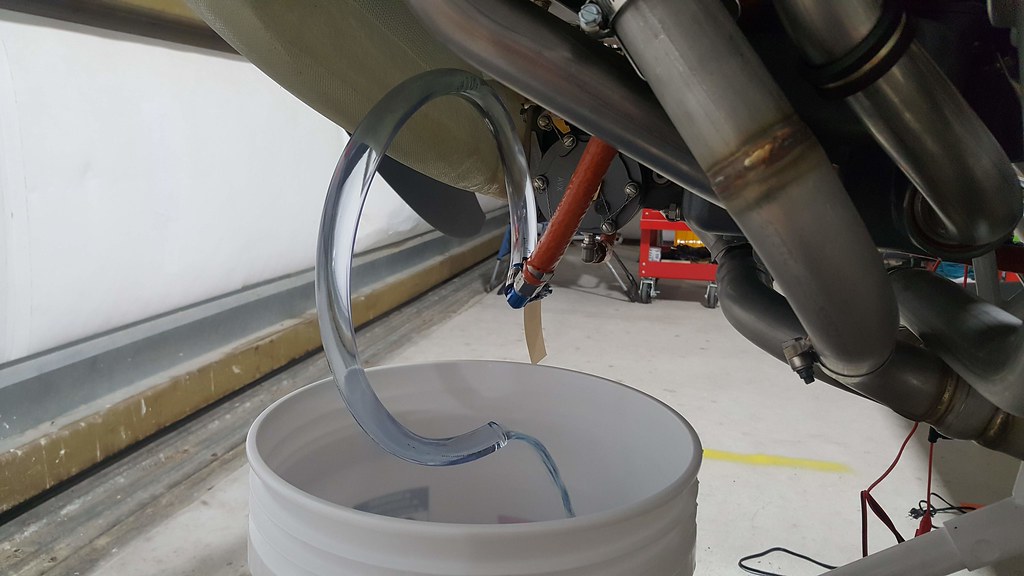

I also installed the fuel pump overflow and manifold drain line but forgot to take pics, I'll see if I can post these tomorrow when I finish fiberfraxing the cowl.
At this point I am ready to move to the hangar but I'm waiting on signing something with the guy before I move that much money in there. So, I have been doing odds and ends here and there to get as much done as possible before the big move. I was planning on waiting to put the prop on until after the move but at this point I'm running out of things to do.
Here is a pic of the fuel pump overflow as promised, just like the plans.
20200724_092042 by Jereme Carne, on Flickr
I had to go a little off script on the manifold drain as the gear leg is mostly in the way of the pipe exiting. I had to drill a hole in the firewall flange and make a little S piece that was Prosealed in that the hose attaches to. You can just see in the right of the picture it is dripping a little oil. I also debated putting a shield on the exhaust but Van's doesn't appear to have one on the -14 and the rubber hose on that one is as close if not closer to the exhaust.
20200724_092058 by Jereme Carne, on Flickr

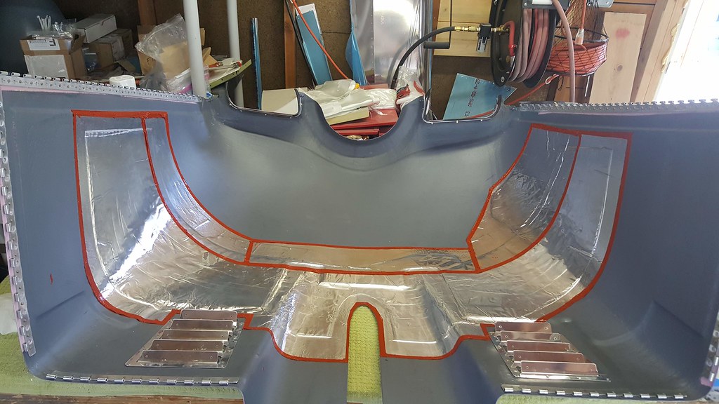

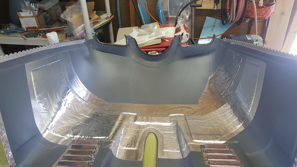

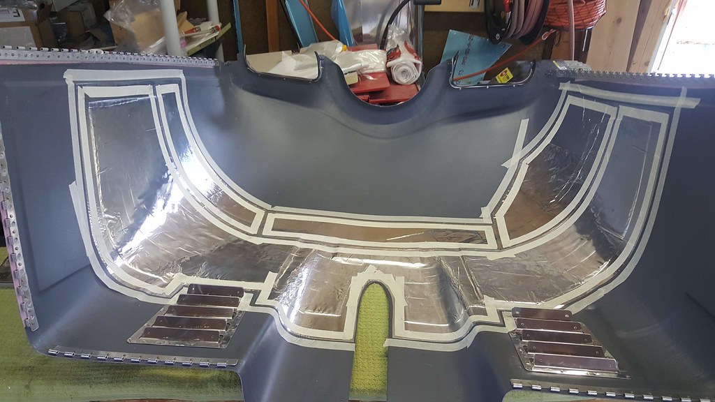

Next up was cowling heat protection. I used Dan H's trick and put some fiberfrax underneath some of the Van's self stick reflecting material. I think it came out pretty respectable. I debated how far back to take this stuff and in the end it seems like no one has problems around the exit area because of the heavily increased airflow. My Vetterman pipes also have very good cowl clearance in this area.
20200724_110316 by Jereme Carne, on Flickr
I then taped the seams to apply some RTV so the edges don't lift.
20200724_113134 by Jereme Carne, on Flickr
I wasn't fast enough pulling the tape so some of the RTV isn't perfect but it will do it's job.
20200724_120216 by Jereme Carne, on Flickr

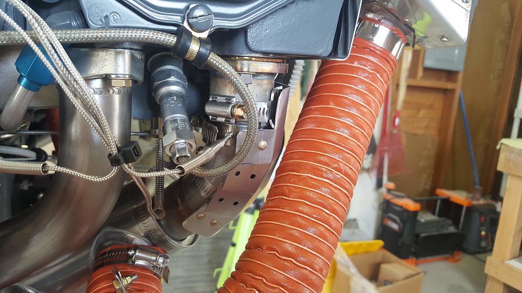

I installed a couple more heat shields on the exhaust. I'm not sure if the one on the right is really necessary but better safe than sorry I guess.
20200724_130255 by Jereme Carne, on Flickr

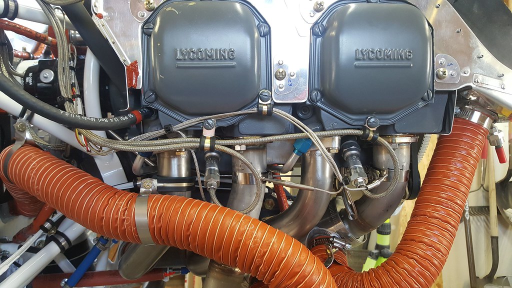

I also toyed around with ideas to get more clearance on the number 1 exhaust to scat. I'm pretty dang sure it would work without doing this but I wanted more clearance. This little tweak not only gave more clearance to the exhaust heat shield but also more clearance to the cowl. I'm pretty pleased with it but I will still be watching this area.
20200724_130746 by Jereme Carne, on Flickr

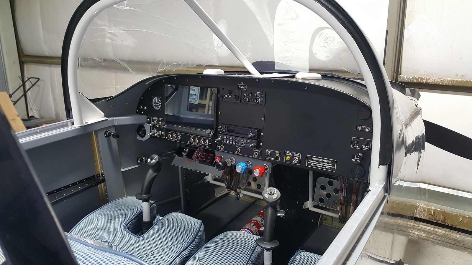

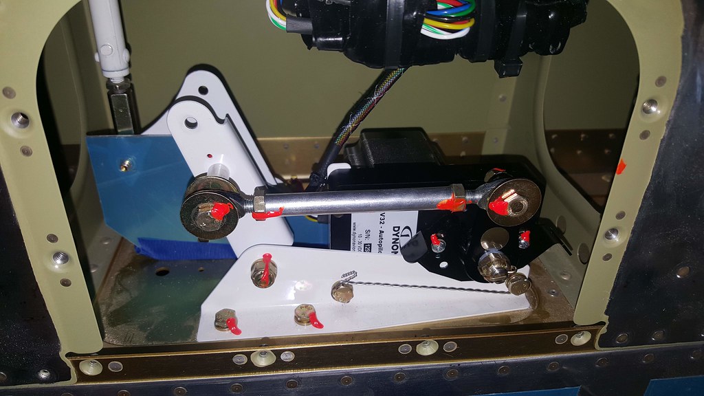

I got my autopilot servos shipped in from Spruce and had them installed that day. Installing stuff like this is fun for sure. (p.s. some of that torque seal is just to show me I torqued it, not to see if it loosened)
20200724_172531 by Jereme Carne, on Flickr

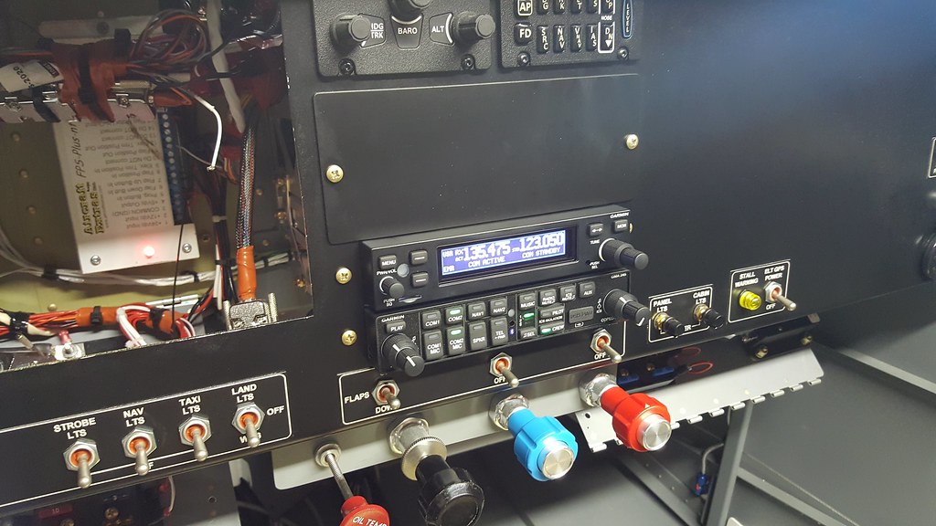

I also installed the comm antennas, radio, and audio panel. Everything powered up nicely and all the switches and functions are working. I was even able to very clearly pick up the local AWOS which is a couple miles away and up hill.
20200726_094951 by Jereme Carne, on Flickr

So when you get to the airport, will you be able to run the engine without the EFIS installed? Or would you even want to?
Ya a guy could run the engine without the EFIS but I wouldn't be able to see the RPM. I should have the HDX installed here in a month or so though so no worries there.

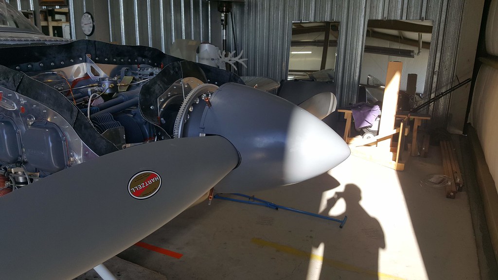

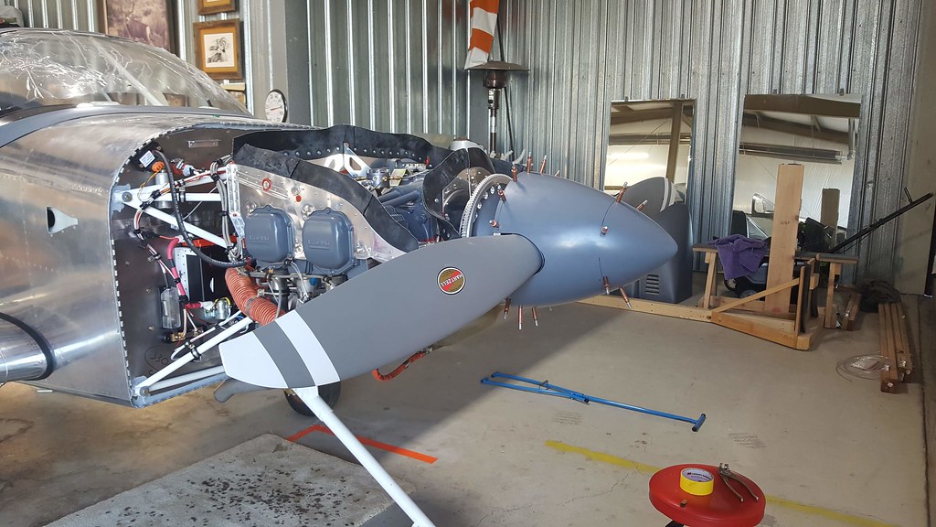

After bashing the front plug with a screwdriver and hammer it came out. Be prepared for a bit of nasty oil to come out. Here is what the inside looks like all cleaned out.
20200729_170958 by Jereme Carne, on Flickr
Prop all installed. I even fit the cowl again to see how putting that bottom cowl on is. It's definitely not as easy to install anymore with the baffle seals attached but still doable.
20200730_201248 by Jereme Carne, on Flickr

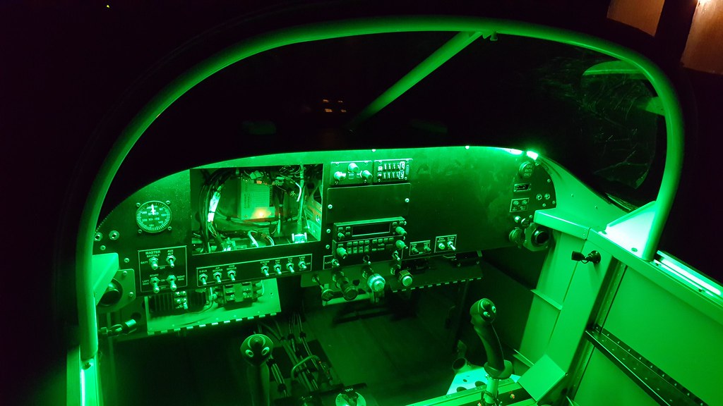

I also got my panel lights installed. Bought some green strip lighting off of amazon. They work great. This picture has the lights on full blast. They can get quite dim too.

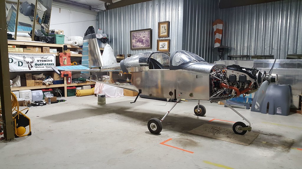

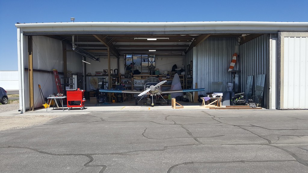

Been a little bit since I updated but I was somewhat in a waiting game for a hangar. I had a verbal agreement with a guy on a hangar but he was taking a long time getting some paper work to me. I happened to be out at the airport getting oil for a friend out of his hangar when I ran into the owner of said hangar. It is a T-hangar with 2 spots and turns out he just bought another hangar and moved his plane out. I knew this would happen eventually but didn't think it would be that soon. Long story short we talked and I agreed to rent from him instead. He has been a great guy to me for over a year, even came to my house a couple of times to check out the project.
Back to the project now.
I safety wired the prop and managed to slip and really butchered up my hand. Hartzell actually doesn't require you to safety wire it and they recommend at least 0.032 if you do. I went with 0.041 just to avoid a potential argument with the DAR. Although he seems like a really reasonable guy so far when I have had questions.
20200803_124553 by Jereme Carne, on Flickr

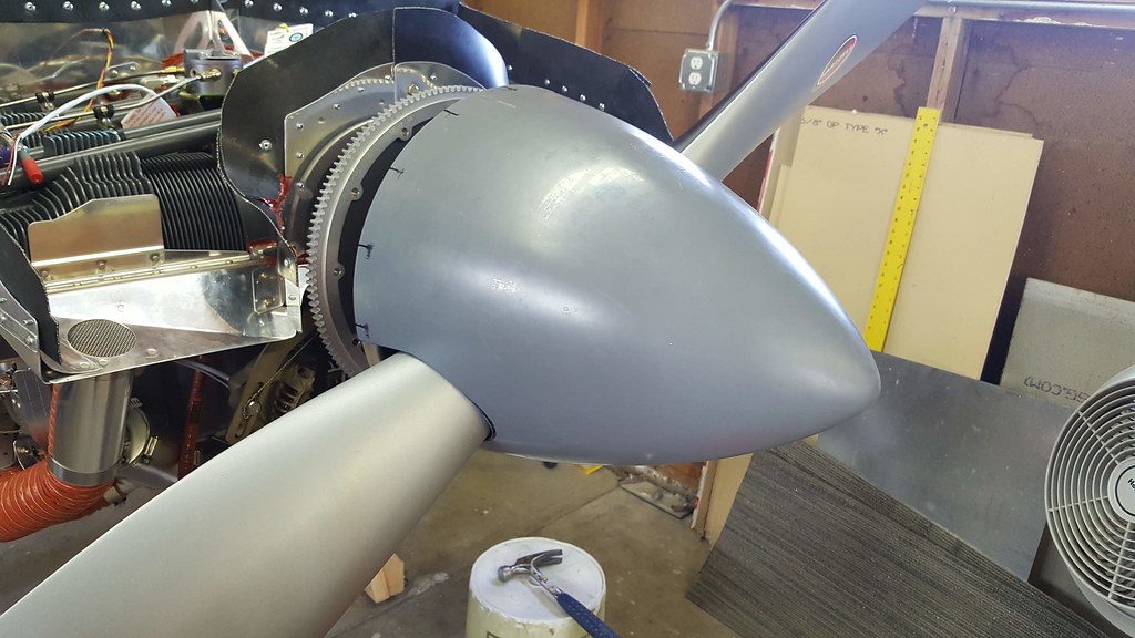

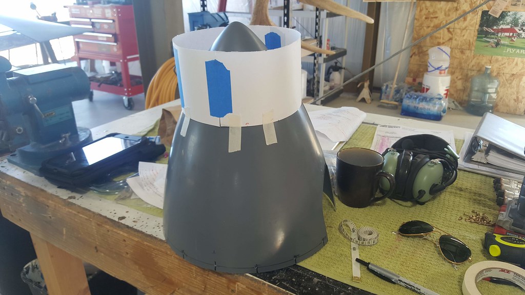

While I was still playing the waiting game I did a bit of preliminary trimming on the spinner. I used the Hartzell template I found online, it appears to be quite accurate. I will have to touch this up a bit more and finish installing it but I will wait until just before engine start to finish that.
20200803_163958 by Jereme Carne, on Flickr
And then it was time... :)
20200811_141745 by Jereme Carne, on Flickr

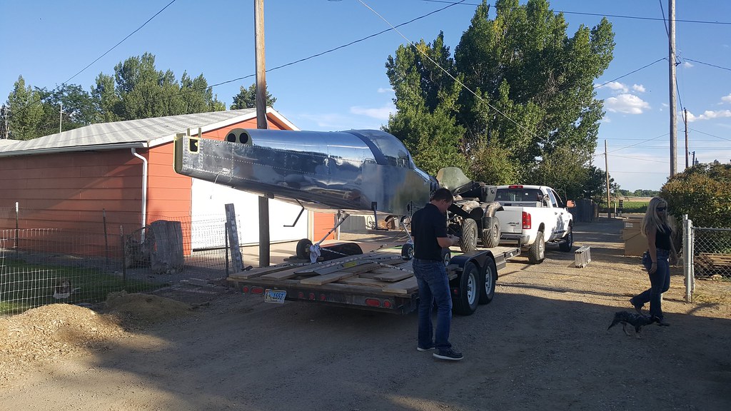

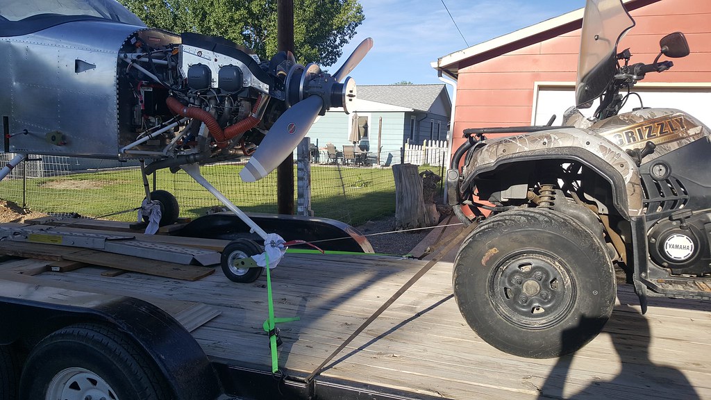

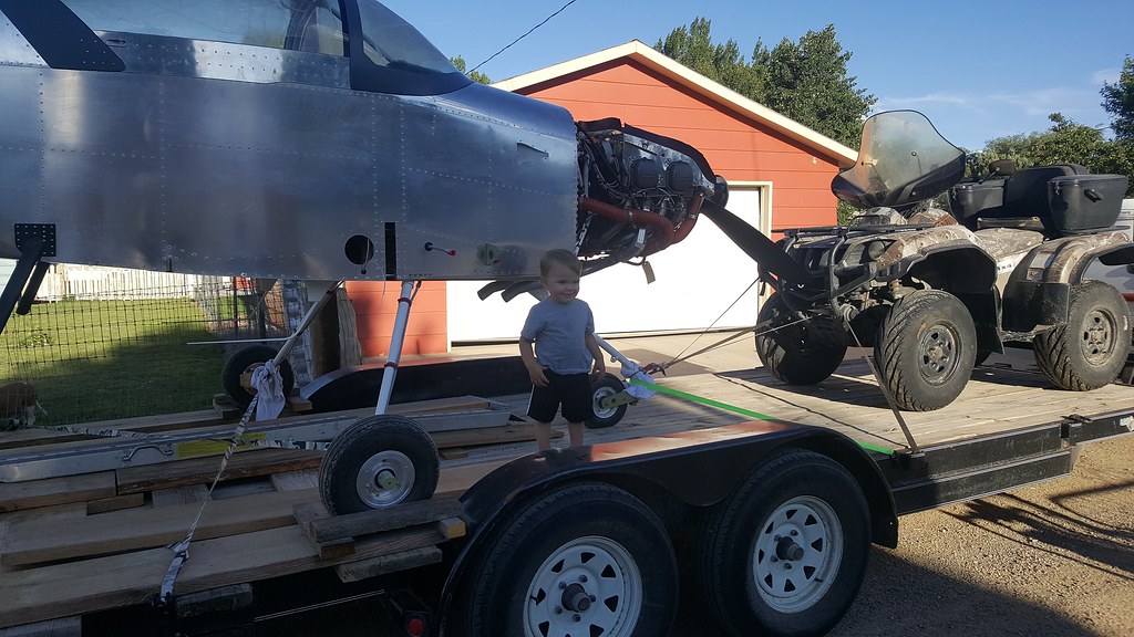

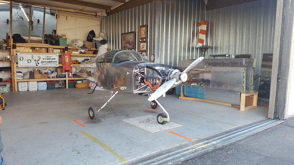

As you can see above I had to modify a trailer to gain a few more inches on the sides.

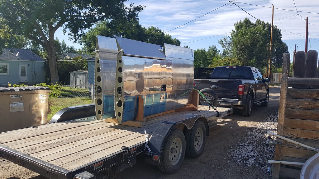

A few short hours later it was time to make the BIG MOVE. :) While waiting for friends to arrive I felt like I was going on a first date my nerves were so high. Hard to not think of what could go wrong moving down the road. haha
My buddy arrived with trailer number 1 so we could move the wings. Got em loaded up and drove the roughly 2 miles to the airport. We may of had a line of cars behind us due to our slow speed but hey, they made it safe and sound.
20200811_173844 by Jereme Carne, on Flickr
Shortly after getting back to the house trailer number 2 arrived. We ramped it up on the trailer and all went quite well. We used a four wheeler with a winch to help us out. The winch idea worked slicker than snot!
20200811_183622 by Jereme Carne, on Flickr
20200811_183645 by Jereme Carne, on Flickr
My son Avden had to say good bye to the airplane. I don't think he knows he will see it again. lol Going to the garage and looking at the airplane after getting home for the day has been a ritual of ours for quite some time now.
20200811_183705 by Jereme Carne, on Flickr

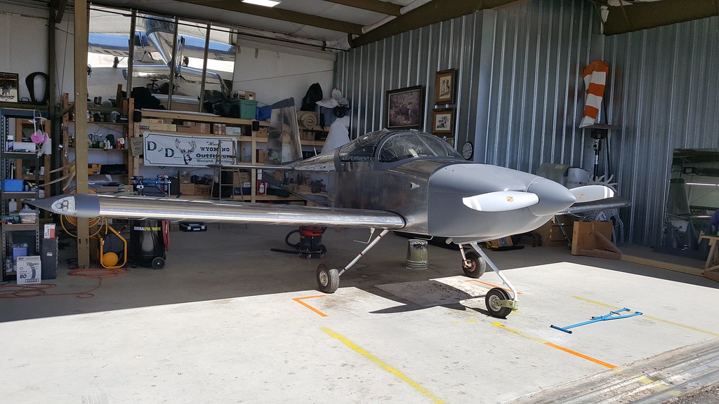

We made it safe and sound up to the airport. On the way up it was fun to see the reactions of other drivers. We once again had a long line of cars behind us, no one even tried to pass. I'm assuming they were just appreciating the very abnormal sight. haha
20200811_190325 by Jereme Carne, on Flickr
My buddy had to make one last pose before closing up the doors.
20200811_190345 by Jereme Carne, on Flickr

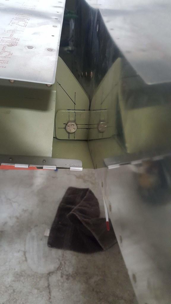

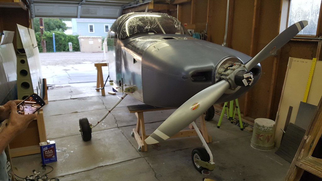

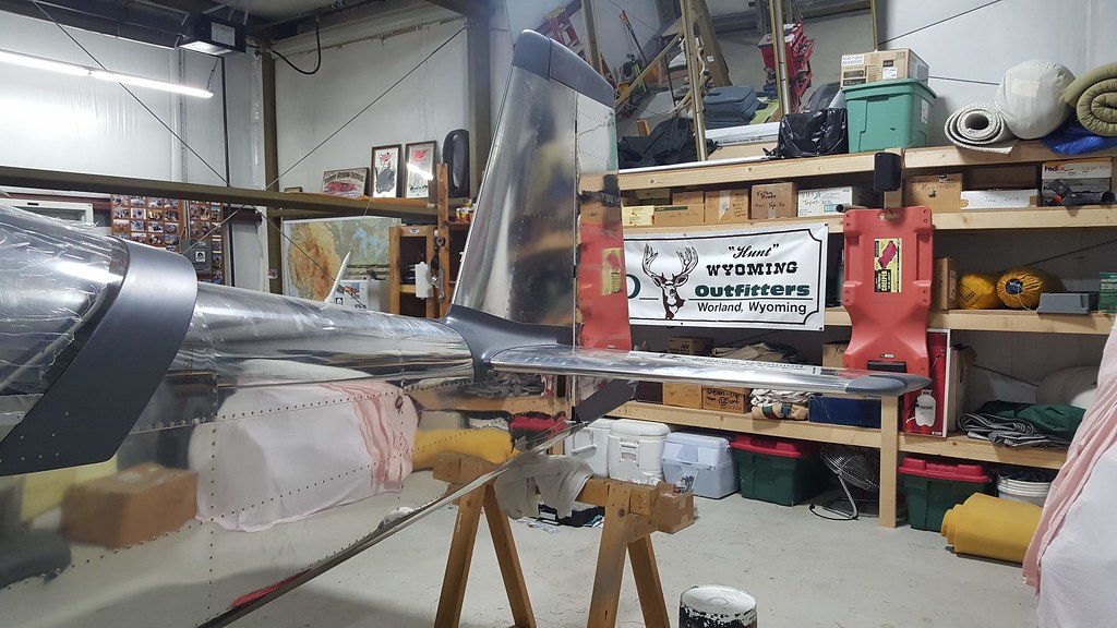

The following day I made some progress on getting the tail bolted back up. I'm really glad I fit the tail already, it sure was nice just having to bolt it back up.
20200812_162616 by Jereme Carne, on Flickr

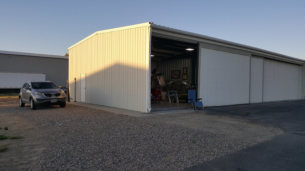

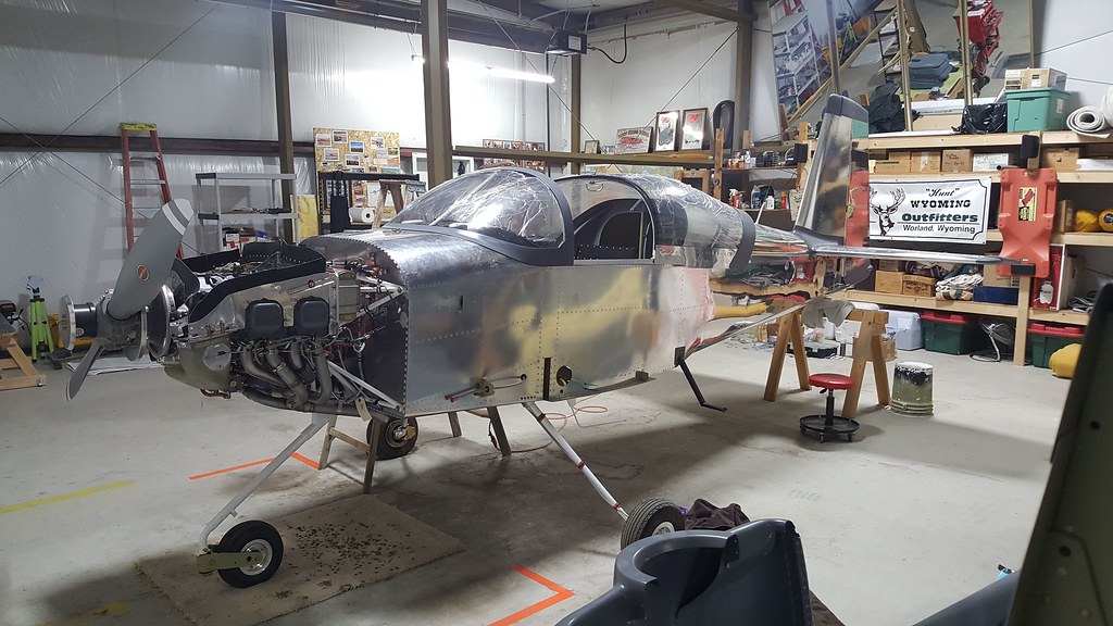

All in all the move went really quite successfully and I'm pretty ecstatic about finally having a hangar! I was really worried about getting one for quite some time. I also got my registration in the mail. This thing might be flying even sooner than expected! :D
Moving the plane to the hangar has really put me into overdrive! I have been working like crazy on it.

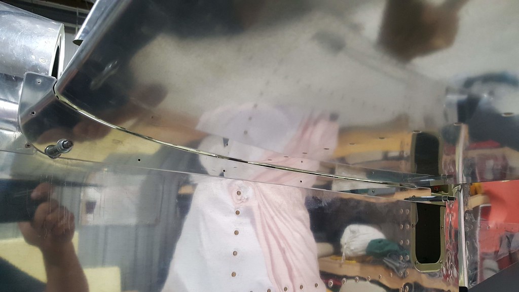

First I mounted the tail feathers. Okay, actually I did this twice. For those of you that haven't done this, make sure you trim the bottom part of the HS rear spar for clearance to the elevator horns. If you forget to trim this you will not have the range of motion you are supposed to. Needless to say I had the entire empennage on before I figured out I forgot to trim that...
Now she is all good to go and everything has the range of motion required. In fact mine fall right smack in the middle of the min/max rotation angles.
20200815_192711 by Jereme Carne, on Flickr
I wasn't entirely happy with the lower gap covers so I decided to redo them without any rubber trim. I have no idea how you are suppose to use the optional rubber trim since these these are shipped to you flush with the aft top deck towards the center. I elected to do the 1/16" gap all around. I may caulk this with something in the future but for now I think I'll just leave it like this. Anyone with experience on this area I would love to hear it.
20200815_144331 by Jereme Carne, on Flickr

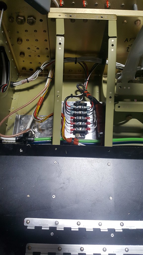

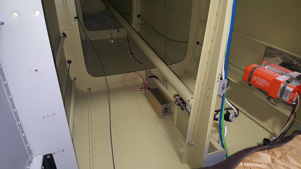

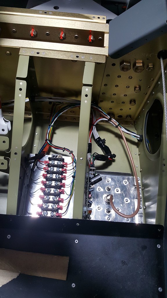

Next I wanted to finish up everything in the aft fuselage so I can stop crawling back there. First up was the ADSB box from Dynon. It is behind the bulkhead where the four screws are.
20200815_192635 by Jereme Carne, on Flickr
Next was the transponder. I like to call it the mighty little box; small box, mighty price!
20200815_192602 by Jereme Carne, on Flickr

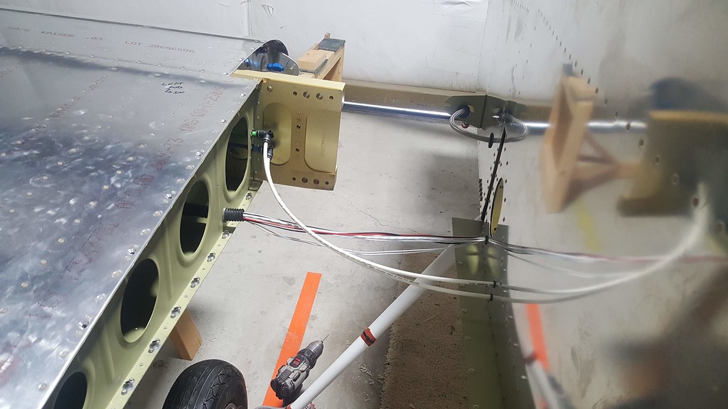

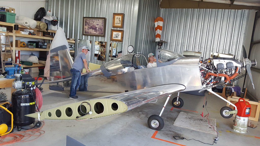

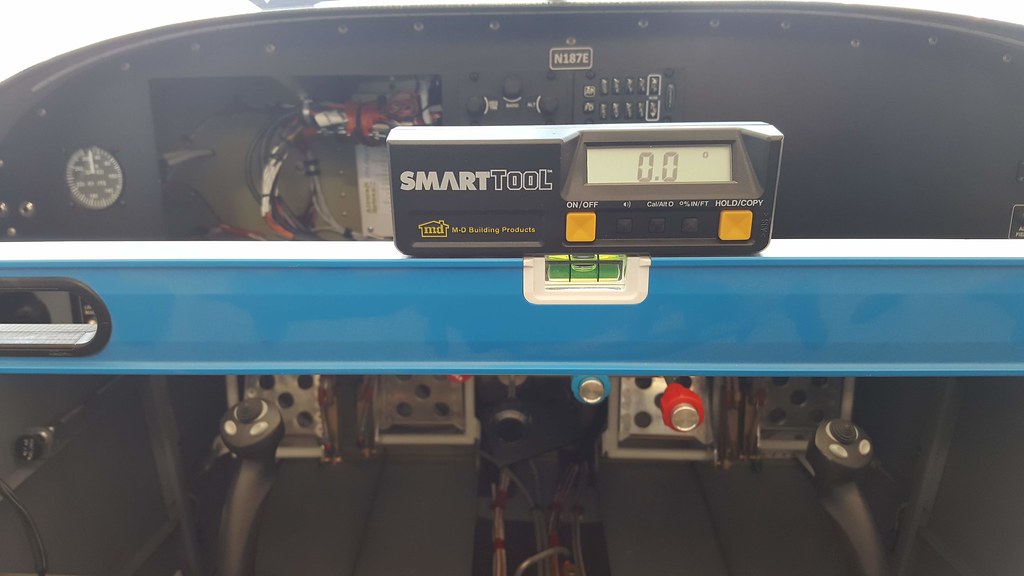

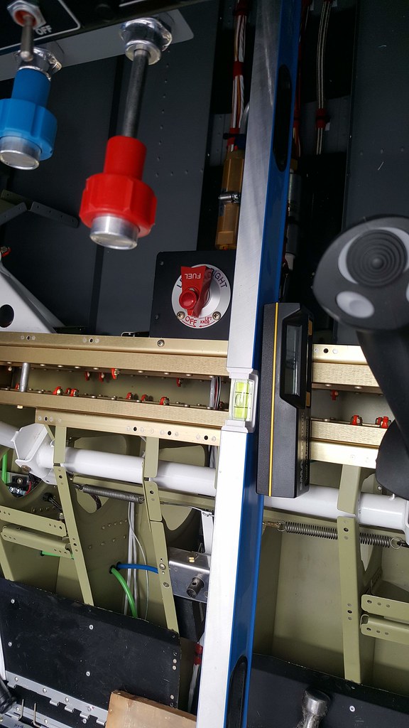

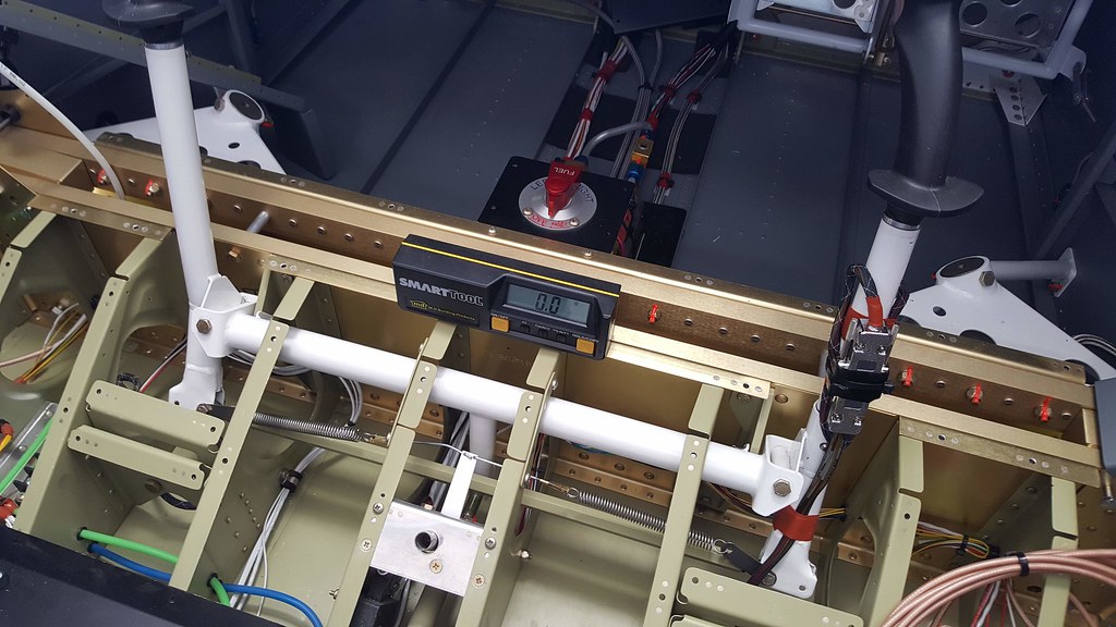

Big day today, got the wings temporarily installed and the aft spars drilled.
After getting both wings bolted in with the hardware store bolts it was time to do some fuselage leveling. Since this baby is already on gear it took some considerable jacking of the rear part of the fuselage to get the longerons/center section level laterally. I had to jack the tail up about 10-12 inches.
20200816_114036 by Jereme Carne, on Flickr
20200816_113839 by Jereme Carne, on Flickr
20200816_115120 by Jereme Carne, on Flickr

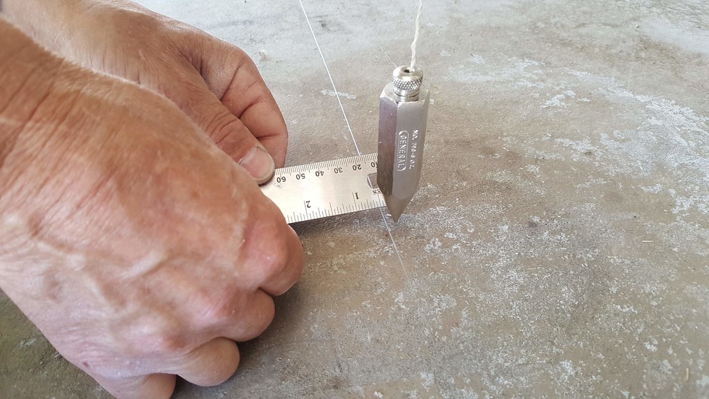

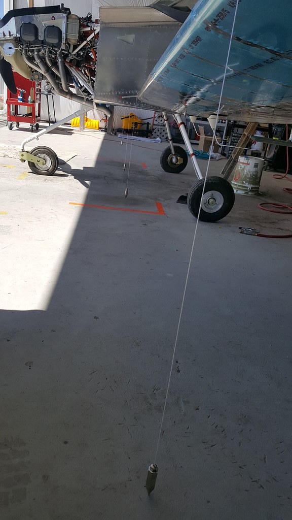

Next up was checking the sweep and triangulating the wings to a center point on the fuse. I couldn't believe it when the tape measure read the exact same measurement when we triangulated, good job Van's on manufacturing these kits.
20200816_120712 by Jereme Carne, on Flickr
I have a very slight forward sweep of about 3/16 of an inch which is well within the 1/2" Van's wants you to be within. I would have had to remove the wings again to "correct" this but clearly it isn't necessary given the spec Van's gives, I'm happy with only 3/16" sweep.
20200816_121237 by Jereme Carne, on Flickr

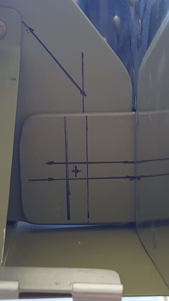

Here is what one of the rear spar areas looks like all marked up to make sure a guy gets the 5/8" edge distance required.
20200816_121930 by Jereme Carne, on Flickr

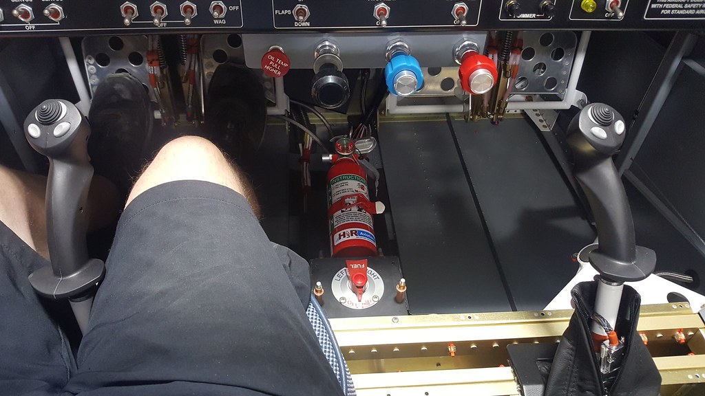

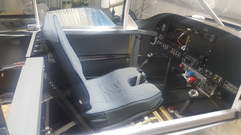

Finally, I got to put my seats in and sit on them. I scored these a couple of months ago on VAF at a good price from someone in Florida where my parents live. I finally got them up here and couldn't be happier with how they feel and put me right at the perfect height! These cushions are only temporary until I can later afford to buy an interior that better matches my paint scheme.
20200816_172343 by Jereme Carne, on Flickr
All in all I'm really quite happy with how the wing mating went and can't wait to finish up some tasks so I can get them on permanently. :D

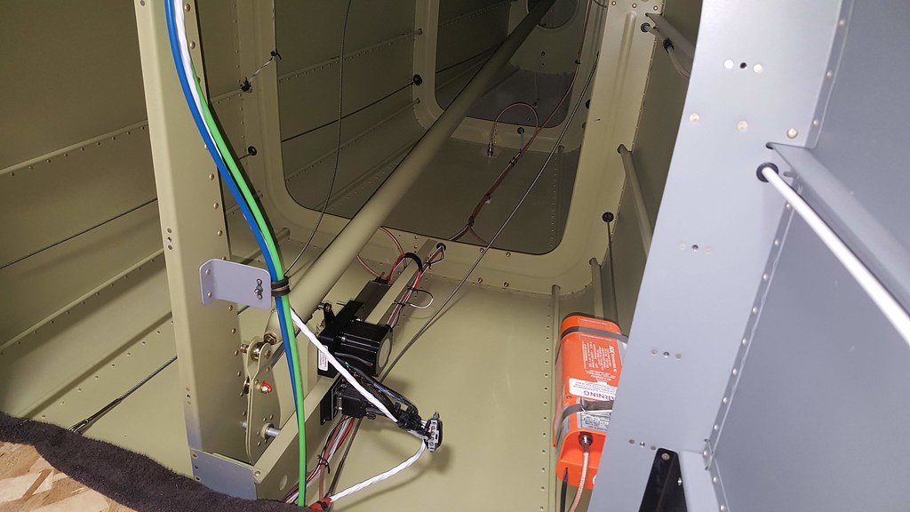

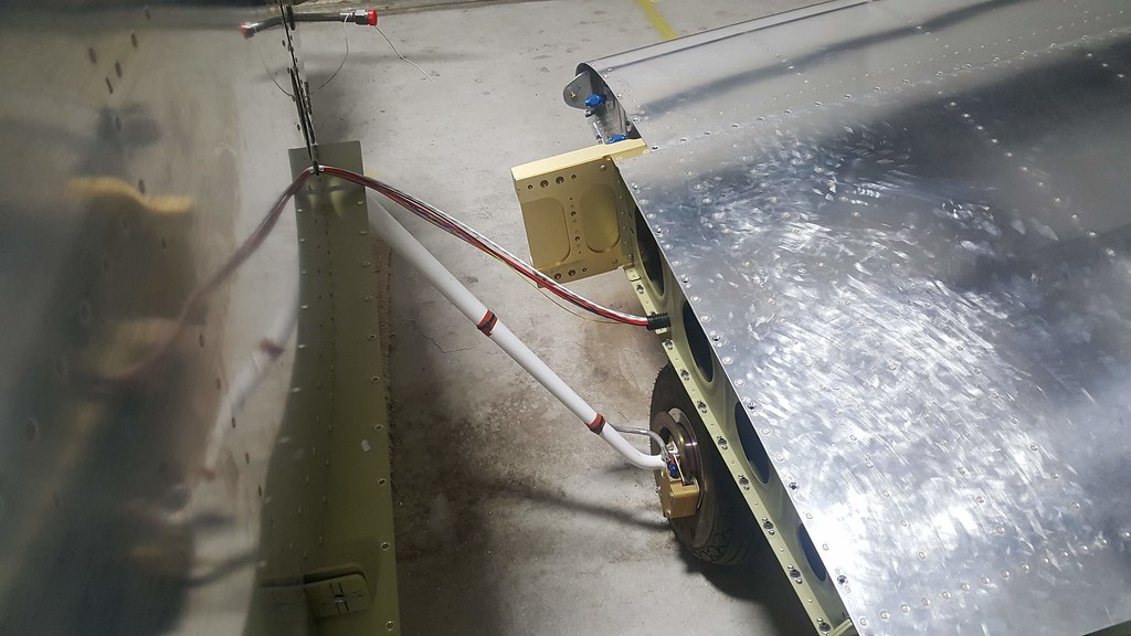

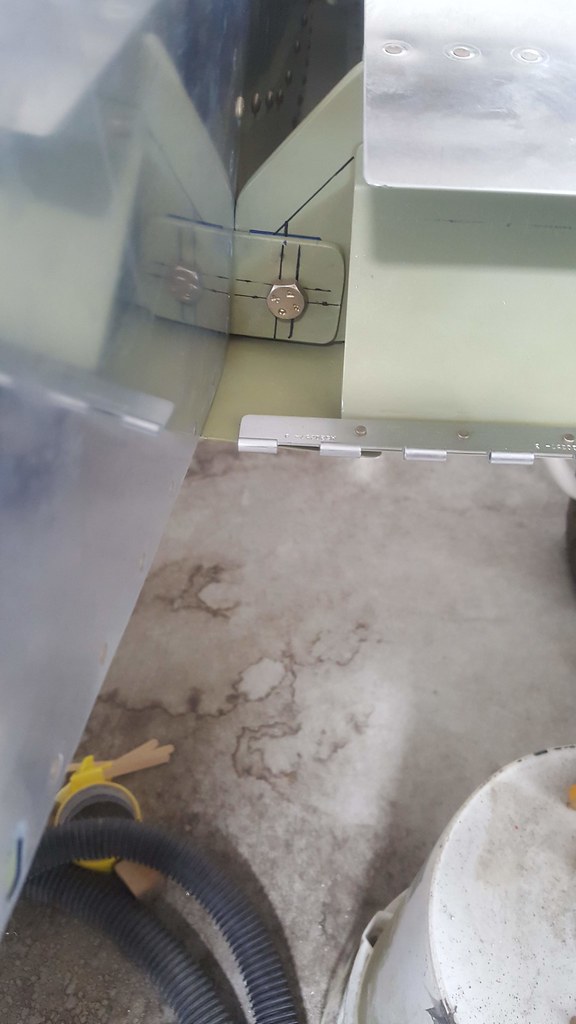

Aileron trim...
Is the aileron trim hardware installed correctly? I don't recall that the WD-756 sticks up through the delrin block.
Thanks guys!
Brian you are correct, I initially installed the manual aileron trim but didn't like the friction required to keep it from moving so I installed the electric version. The only difference is the shaft is cut down for the electric version and it is slightly off center. Mine is not off center but still functions fine and I am going to keep the handle on there as an indicator. Nice catch btw!
I have been working on getting my wings on for good and finalized. Progress is going good but I'm back to teaching now so it's a little slower than usual. I have a planned final inspection at the end of September, I think I can make it in time but won't hesitate to push it back if needed.
After taking the wings back off and installing way too many nutplates it was time to put them on permanently. Got all the wires and other accessories ready for the mating first.
20200823_141955 by Jereme Carne, on Flickr
20200823_141938 by Jereme Carne, on Flickr
After mating them and installing the bolts that I had it was time to start connecting wires (seem to be missing two 1/4" bolts and I nicked a couple of 7/16" ones on accident so I decided to replace them). Hence the two empty holes on each side while I wait for a Van's order.
20200824_203054 by Jereme Carne, on Flickr
20200825_203511 by Jereme Carne, on Flickr
Tested out my FlyLED wingtip "the works" lighting kit when I finished as a reward. Everything worked beautifully! Sorry, forgot to take pics of this... :(

Man I have really been slacking on taking pics lately.
The wings are permanently on and bolted up. The wing root fairings are finished, the elevator control train is finished. The rudder rigging is finished. Flaps are rigged. I'm currently working on rigging the ailerons. I pretty much have them rigged and just need to install a few nuts and torque em up and they will be done.
The only picture I managed to get this week was after I installed the fire extinguisher. I really quite like this location. It is out of the way but very accessible! I used four nutplates and mounted it to the top of the fuel pump cover. Speaking of fuel, I put fuel in my tanks and they are holding strong. Also tested the fuel pump and it seems to do it's job nicely. I still need to run actual flow calculations though and figure out unusable as well.
20200830_200756 by Jereme Carne, on Flickr

Just got done doing some fuel testing. I just did a wide open flow test and may decide to do one with pressure in the days to come just to make sure it is good at pressure as well. I also need to do a tail low test, although I am sincerely not worried about it after reading others reports and seeing my wide open results.
Long story short the backup pump will do about 63 GPH which is well over the 125% max engine requirement. Actually, it's about three times as much. I verified this with four different runs from both tanks and used a weight method as well as a volume method for it. All numbers were very close to eachother. Very happy with the results.
Here is the test in progress. I put that clear piece of plastic tube on there so that I could see if/when air was getting into the line.

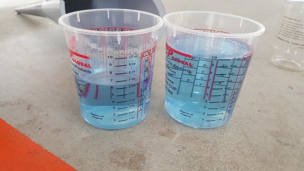

After flow testing I ran the tanks down and measured the unusable fuel. There seems to be a bit of controversy on how best to do that but honestly people do you really even come close to getting that low on fuel? I get uncomfortable if I have less than a full hour on board when I land and I prefer more. I digress...
Anyways this is the unusable in the left tank while the plane is about 2 degrees nose up.
20200904_191415 by Jereme Carne, on Flickr
Here is the right tank. This tank has the standard pickup instead of the flop tube in my left tank.
20200904_193011 by Jereme Carne, on Flickr
I also got the seats and seat belts installed as well as various covers. Only a few more covers to go and all she will need before weight and balance is to install the EFIS (should be here Tuesday) and to put on the cowl. Tomorrow I will be working on installing the stick boots.

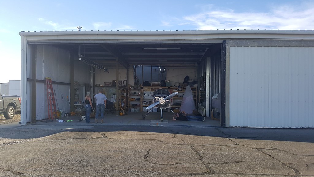

Just a little more fuel testing being done with some friends. By bringing the tail all the way down it put the fuse at 15.3 degrees. Good enough for me especially since the fuel flow didn't change from before, 63 GPH.
20200905_103236 by Jereme Carne, on Flickr
Dear Jereme ... just a word of caution:
I did no see a GND cable, but a lot of plastic cans and hoses!
Would not be the first one that burn down before it fly!
static charges - danger
I agree - a good article here:
https://cafe.foundation/v2/research_reports.php
https://cafe.foundation/v2/pdf_cafe_reports/Fuel Handling Safety.pdf
I was told that in the shared hangar I use, anyone caught handling fuel inside the hangar would be expelled. And getting hangar space here is not easy, so that's a pretty strong motivator to handle fuel outside, even in bad weather.

Okay, I came home from the hangar tonight and told my wife "I have a new love in my life" named Dynon Skyview. I spent a good hour setting it up and holy smokes it is sweet!!! I was worried that it was going to be difficult to setup but man it is pretty intuitive to use, don't stress too much about how complicated the manual looks. Everything seems to be working nicely so far and I couldn't be happier with going with Dynon. Anyways, a pic says it all...
20200908_193506 by Jereme Carne, on Flickr
20200908_210357 by Jereme Carne, on Flickr
Here is a fun interior shot I took too.
20200906_215627 by Jereme Carne, on Flickr

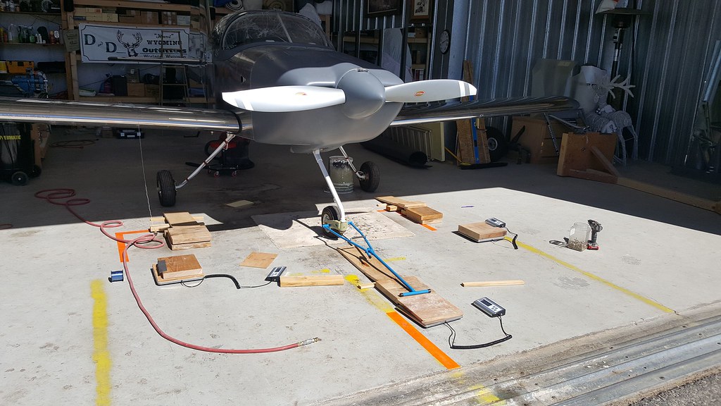

Here she is ready for weigh in. First I following Lycomings bulletin to remove the preservative oil and went on my merry way to adding 8 qts of mineral oil. I then ran the prop by hand for about 30 seconds. It makes an alarming clicking noise every 180 degrees but then I realized that must be the impulse coupler on the left mag. Would love to hear from others if that's correct. Anyways... I got a bit of oil pressure just from doing that so I went into the cockpit and cranked her with the starter for the first time. Very cool to see! She pumped up very quickly past 20 psi. After that it was time to put it all together for weigh in.
photo of aircraft N187E by Jereme Carne, on Flickr
I fabricated some ramps to get it on some blocks first. The mains had to be about 1.5" higher than the nose gear and I also had to let some air out of the nose wheel to get the fuse level. From there I set up three packaging scales and simply rolled it onto them. I rotated the scales and weighed it three times and took the average. The scales were very consistent and always within about .5 lbs of each other.
She is kind of a heavy gal coming in at 1,136.4 lbs but then again I'm sure that new nose gear adds a few as well as the firewall protection I added. The C.G. was a BEAUTIFUL 78.9 inches aft of datum. This is right at the forward end of the range and it basically makes it impossible to get out of the envelop without breaking the 100 lbs baggage limit. My wheel arms were a little different than what Van's uses in the their document but plump bobs and numbers don't lie.
20200912_120635 by Jereme Carne, on Flickr
Next up was starting the spinner installation. The hardest part here is making sure it is centered and drilling the forward plate blind. Getting the spinner centered sounds easy enough but it takes a long time and in the end I'm still not sure if it is perfect. The instructions say to place a mark at the center/tip of the spinner and then clamp a pen/something pointy to a ladder and see how that mark you made tracks. Sounds easy enough but the problem is ensuring you get it in the center in the first place. There isn't a real surefire way of doing that that I could think of. In the end I think I got it pretty dang well centered.
20200912_171933 by Jereme Carne, on Flickr
Here is how I marked the spinner to get even hole spacing, works great.
20200912_173856 by Jereme Carne, on Flickr
20200912_184755 by Jereme Carne, on Flickr
Next I will attach the gap fillers and all the nutplates to finish this guy out.
