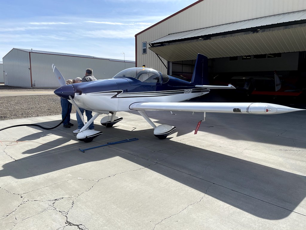

Here is a picture of Chris and his aircraft getting fueled up after my training was coming to a close.
IMG_0488 by Jereme Carne, on Flickr

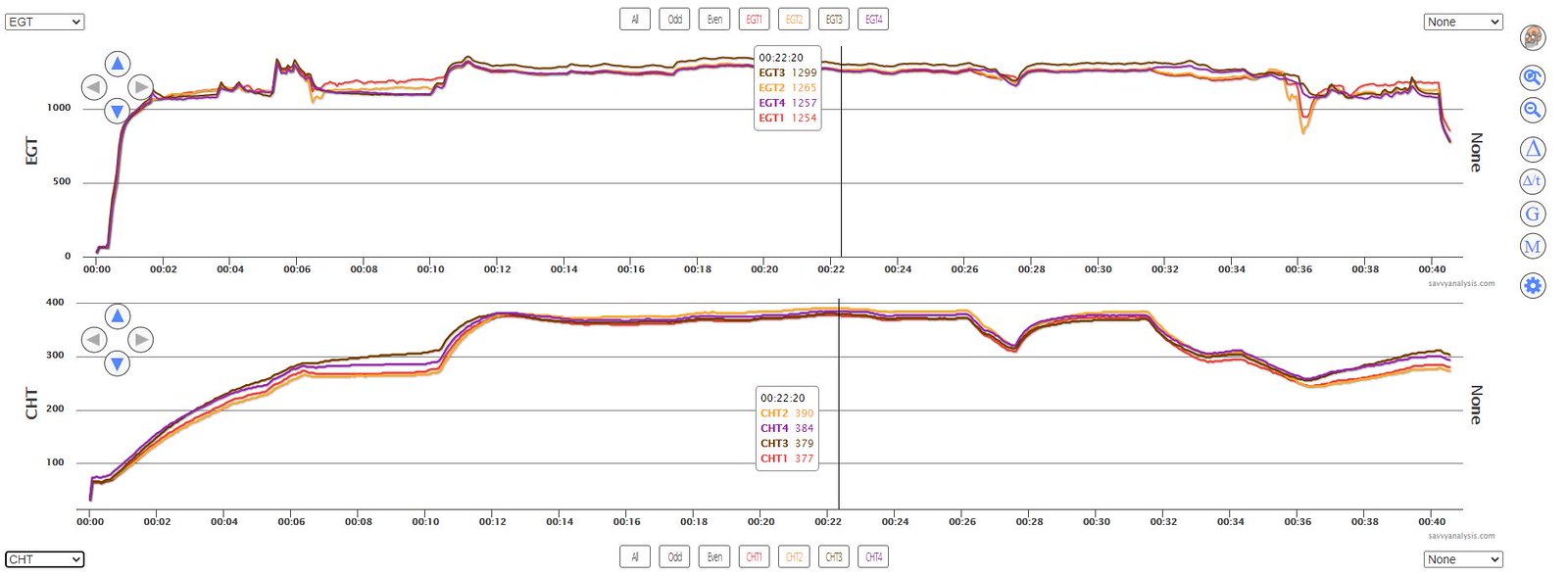

I continued to circle the airport at about 6500' (about 2000 AGL) and around 75% power which worked out to a little more than 23" MAP and 2600 RPM.
I had a blast zipping around the sky just practicing some coordinated turns. Here is a video from the ground that shows how fast I was going. My average indicated airspeed was around 155 knots.

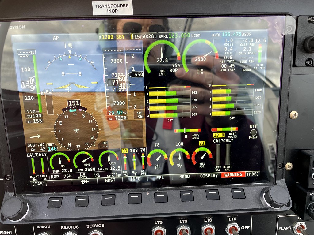

I was pleasantry surprised with all of my engine temps as well. I fully expected to see some ridiculous CHTs but they were awesome! My highest was #2 at 390 F. For pretty much all of the flight the average CHT was around 370s and I kept the EGTs around 1250-1300. The Savvy analysis tool does a great job at showing the data graphically.
data by Jereme Carne, on Flickr

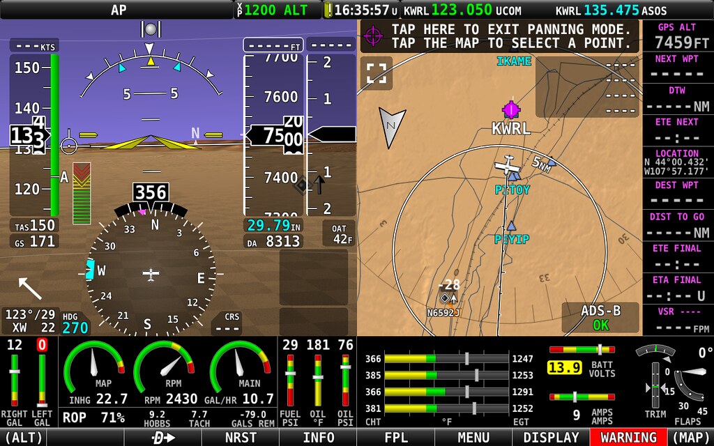

I didn't know at the time how to take a screenshot on the HDX so here is my quick and dirty version. haha
IMG_0496 by Jereme Carne, on Flickr

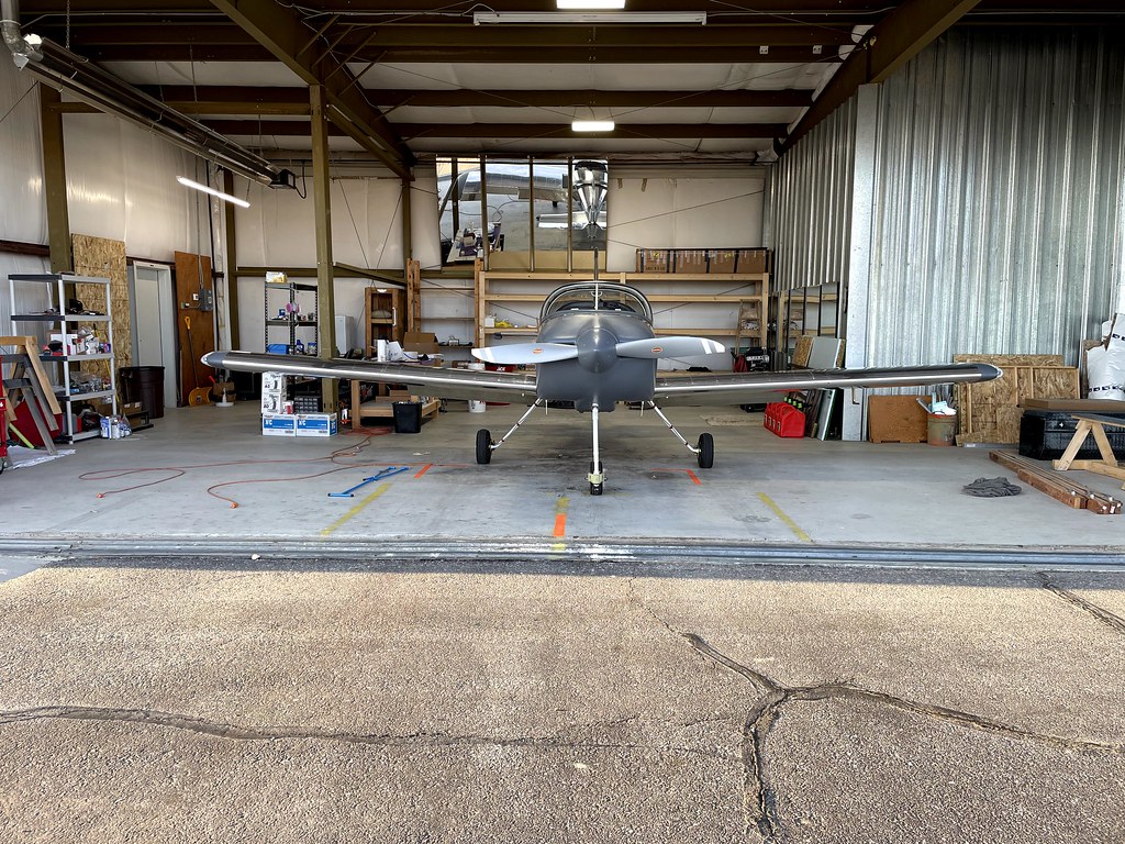

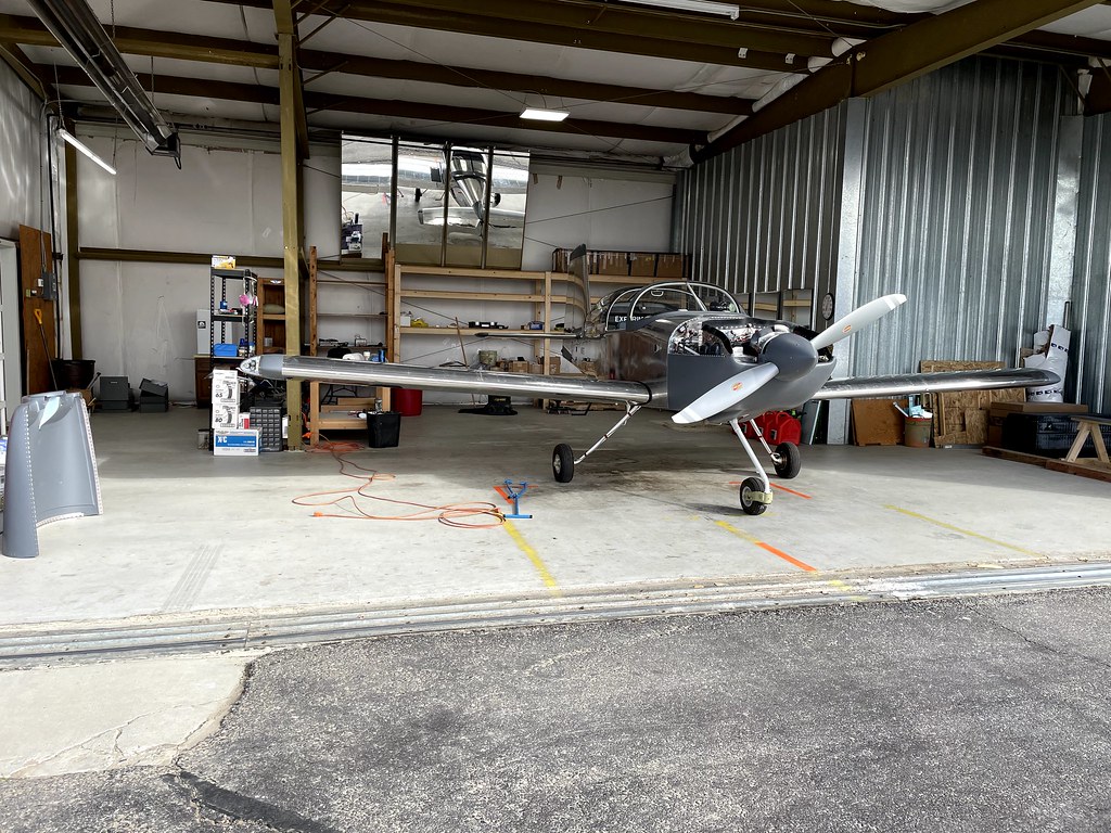

Here she is safely back in the hangar. (and yes I took the bottom cowl off too) ;)
IMG_0498 by Jereme Carne, on Flickr

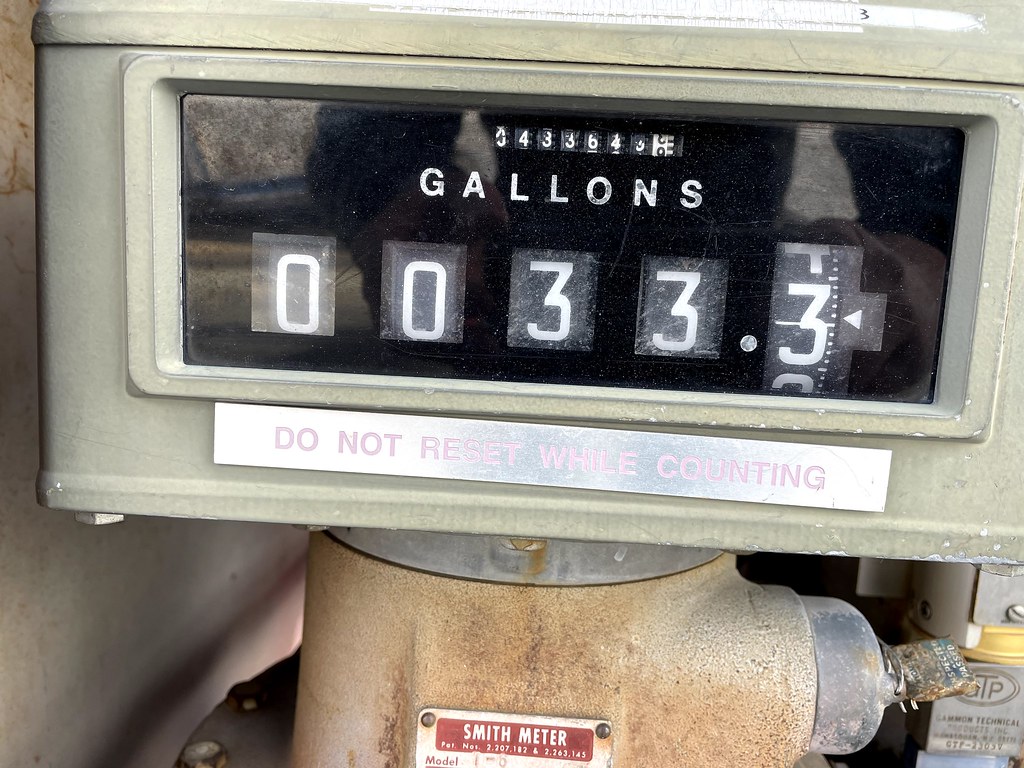

Man these fuel bills are really racking up! 131.5 gallons in the last 7 days. :eek: Man I hope my wife doesn't read this blog... haha
IMG_0538 by Jereme Carne, on Flickr

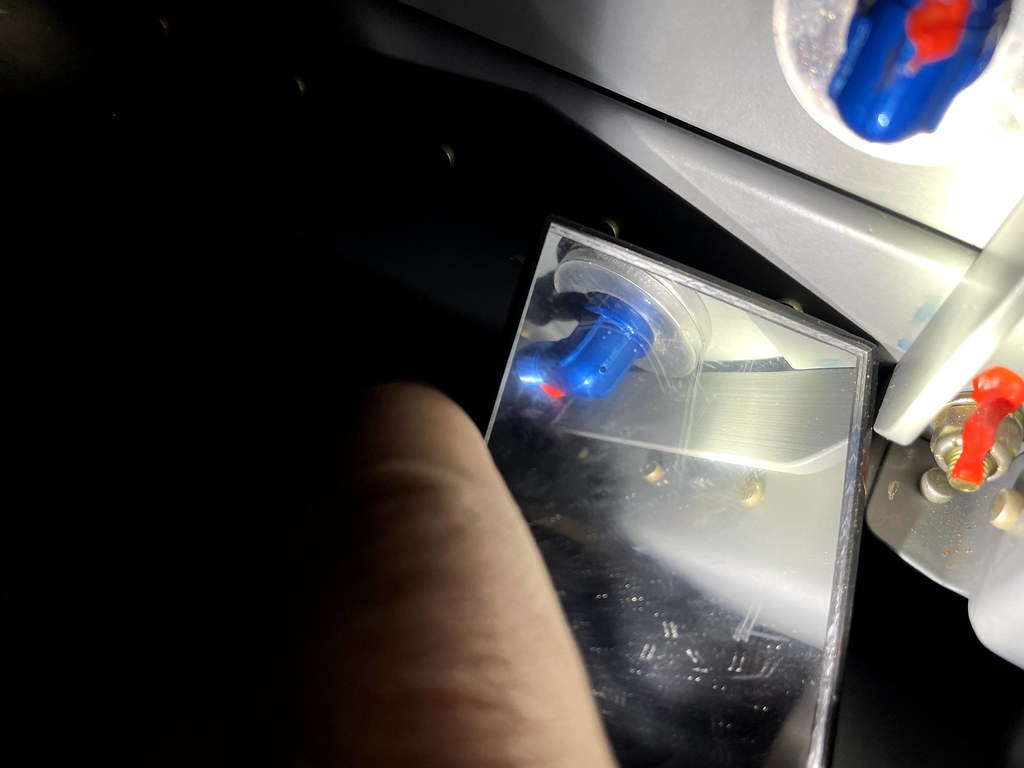

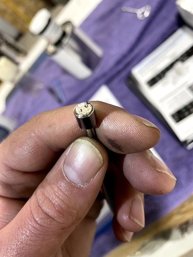

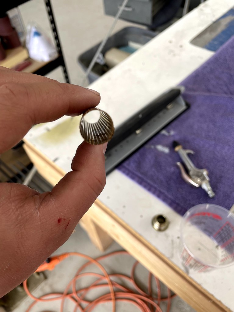

I had a fuel smell in the cockpit on one of my flights right after switching to my left tank after a top off. I said "I bet I know what that is coming from" and sure enough when I switched to my right tank it went away. Definitely something with the vent.
I tightened the fitting and no dice, it still did it. Time to crawl under the panel and cut off the flare and redo it. Once again it still leaked a few drips on a full tank after slothing about a bit. I thought well mind as well take out the mirror and have a look at the bottom of the fitting. Low and behold there was a flippin hole in the fitting!!!
I have absolutely no idea how that hole got there but it sure looks like somebody drilled a hole in it! Here is a picture. I do vaguely remember seeing a fitting with a hole in my bag of parts when I was building and made a note to not use that fitting. Apparently I didn't listen haha.
IMG_0567 by Jereme Carne, on Flickr
Temporary fix, clean it well and proseal it. It has worked flawlessly for the last few flights. No smell anymore. I got a new fitting on order and will change it out.

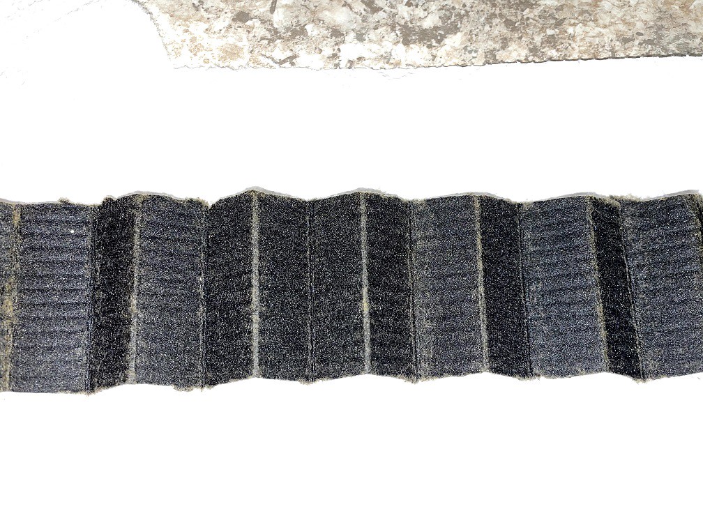

Here is what some of the pleats of the oil filter look like.
IMG_0571 by Jereme Carne, on Flickr

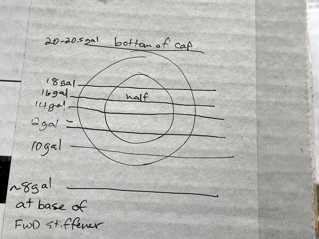

While calibrating my fuel tank senders I decided to also come up with a non-technical way to visually see how much fuel is in the tanks. The result can be obtained by looking into the tank and seeing how high up the fuel is on the rib stiffener ring. A flashlight makes it easier but I always carry a small one when I fly.
IMG_0555 by Jereme Carne, on Flickr
