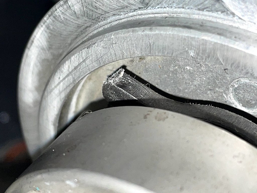

I pulled the mag, definitely a bad impulse coupler. The question now is what caused it? There was no lube at all on the impulse coupler assembly, specifically where the pawls and stop pin are. That seems like an area that would be lubed upon assembly due to the friction of metal on metal right there.

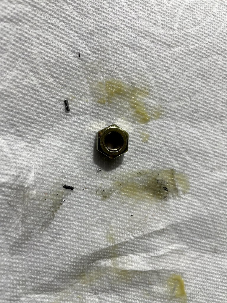

The pawls are definitely trashed. I found some metal on the mag spacer. Below is a pic of the two large fragments next to a 1/4" nut.
IMG_0121 by Jereme Carne, on Flickr
Next is a picture of one of the impulse pawls. Definitely damaged. Pretty sure this is where the large pieces came from. There are lots of tiny bits too magnetized to the end of the pawl as you can see.
IMG_0159 by Jereme Carne, on Flickr

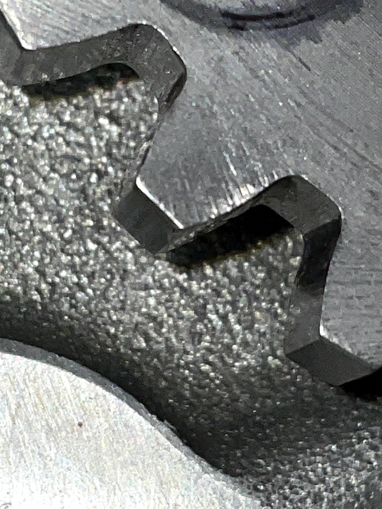

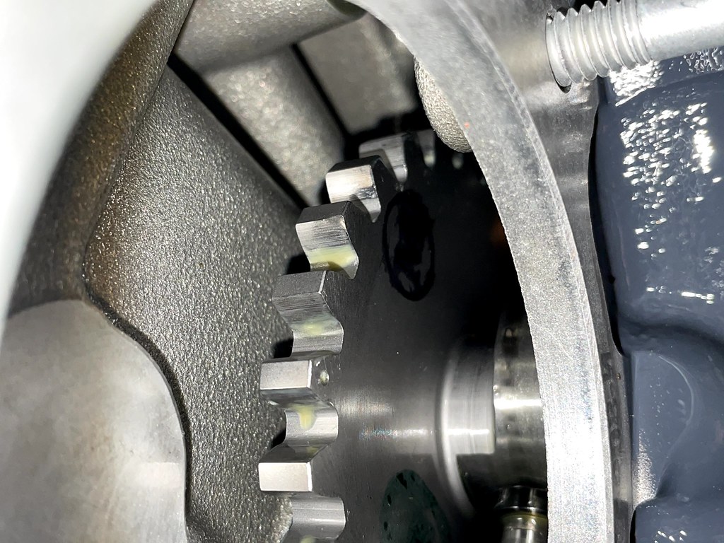

Now the big question. The gear train.
I looked it over as best I could as there isn't that great of access behind the engine and found one tooth on the mag idler gear that has me wondering. It looks like the corner of the gear is slightly misshaped. It is hard to tell though. It feels perfectly smooth but doesn't look like it in the picture below. I am also really confused as to why it is just on the corner. It almost seems like it was dropped onto that corner.
It looks really bad in this picture. But can't tell if light is playing tricks as you will see in the following pics.
IMG_0152 by Jereme Carne, on Flickr
Hardly noticeable in this picture.
IMG_0151 by Jereme Carne, on Flickr
Less noticable in this pic but definitely looks different than the other gears.
IMG_0157 by Jereme Carne, on Flickr
Any idea here guys?
Before you jump the gun and say that hand propping didn't generate enough oil pressure to lube the pawls lets keep in mind that Lycoming 1241C lets you spin the engine for more than a minute with the starter (taking breaks of course) and not obtain oil pressure before taking a closer look at things. Even then they say minimum oil pressure during pre-oiling is 20 psi. I hand spun the prop for about 10 seconds on two occasions and got the oil pressure in the 30s.
My concern, after seeing your pictures, is the pieces of metal you found - and what about the ones that you didn’t? Where are they now? A brand new engine with pieces and slivers of metal running around inside is not a good thing.
Paul
Paul
True Paul. Although I think most if not all was captured in the mag spacer. The gears were covered with a thick assembly lube and when I was wiping that off to get a better look at the gears I never found another piece of metal. Not saying it couldn't of happened but it doesn't appear to have. If metal did enter the rear case it should of dropped down into the sump which I would find in the screen eventually?
Unless anyone else has any ideas on course of action I guess all I can do is call Aerosport on Monday and see what they say.
If anyone knows why this may have happened I'm all ears. I can't find a similar case anywhere else on the web.

I think this is where you experienced some kind of debris dropping into the accessory gear assembly. That may have had nothing to do with oil pressure - just the rotation of the engine may have dropped something into the gears.
... I think most if not all was captured in the mag spacer....If metal did enter the rear case it should of dropped down into the sump which I would find in the screen eventually?
I think both are bad assumptions. You really don't know where the metal came from or how much. And whether there is still some there or some consequence of rotating the crankshaft when it seemed very tight. This might be just about the impulse coupling, maybe the gears as well. Maybe more.
There are a couple of possible failure modes here and I think the starting point is to discuss this with the engine builder before any further turning of the crankshaft. The photos are excellent, but they might want to see the actual metal debris you removed.

Good Find!! It takes a careful observation to find these things, you did well!!!
Regardless of what happened, calling Aerosport is the first action, That tooth is definitely deformed. Not acceptable.

Those small pieces look like they could possibly be pieces of cotter pin. Can you confirm that there is a cotter pin installed on the mag gear. For a Bendix mag that cotter pin is a Bendix part number and is not a standard fractional size pin. Also the mag cotter pins require trimming the ends after installation.

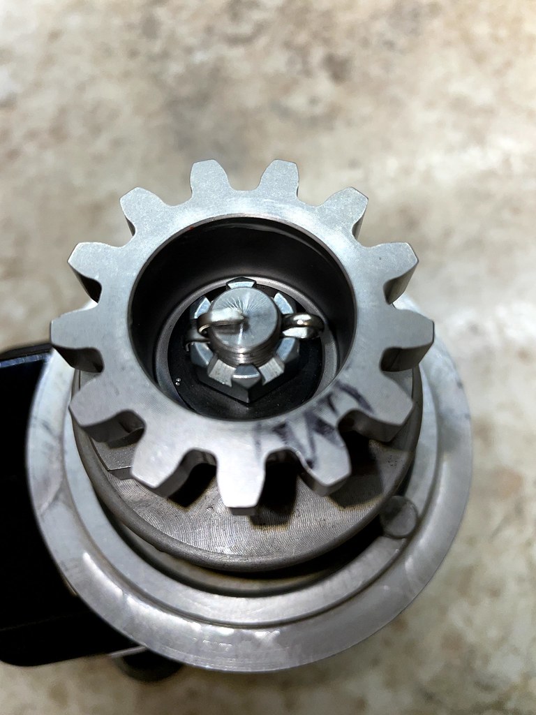

Here is a pic of the cotter pin. Looks normal to me but then again I have never installed one on a mag.
IMG_0162 by Jereme Carne, on Flickr
Since you verified the correct part #'s and rotation the only other thing I'm guessing it could be is improper heat treatment of the pawls. No it is not normal for the gear to rock like that. The rotor shaft end is a tapered shaft with a woodruff key. The gear should be tapped onto the shaft where it will lock onto the taper. The key is just a backup.
After the last Slick SB on the Impulse mags and the warnings, I bit the bullet and installed a SureFly on the left (impulse) side. Very simple installation and peace of mind.. starts better, too. Maybe the shop would give you some credit for the bad mag?
Something is wrong with that magneto to make the drive gear loose on the shaft like that.
My unofficial opinion is that it' likely that wiggle is what caused a misalignment, causing it to bind up and resulting in the rest of your problems.

I'm now thinking that a stray piece of metal got between the mag gear and the idler gear and damaged both the mag and the idler gear and perhaps more. There are very likely some more small pieces of metal in the sump.

One more thought-the mag gear nut is a special nut. It is a matter of luck if the cotter pin lines up within the torque specs for the nut. It is possible that the nut was loosened to line up the cotter pin.

The pictures you show of the accessory case gear in post 11 clearly show a damaged gear tooth. In my opinion, the accessory case needs to come apart at a minimum to replace that gear and search for remaining debris. I suspect the binding you felt when hand turning the engine was a piece of the debris wedging itself between the mag gear and the accessory case gear teeth which is what left the visible witness mark. If that’s the case it also may have excessively side-loaded the mag rotor shaft because the the debris would have been trying to force the gears out of mesh. The mag should also be disassembled so the rotor shaft can be checked for straightness.

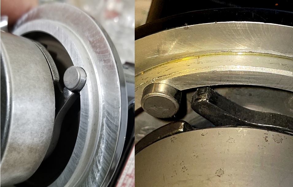

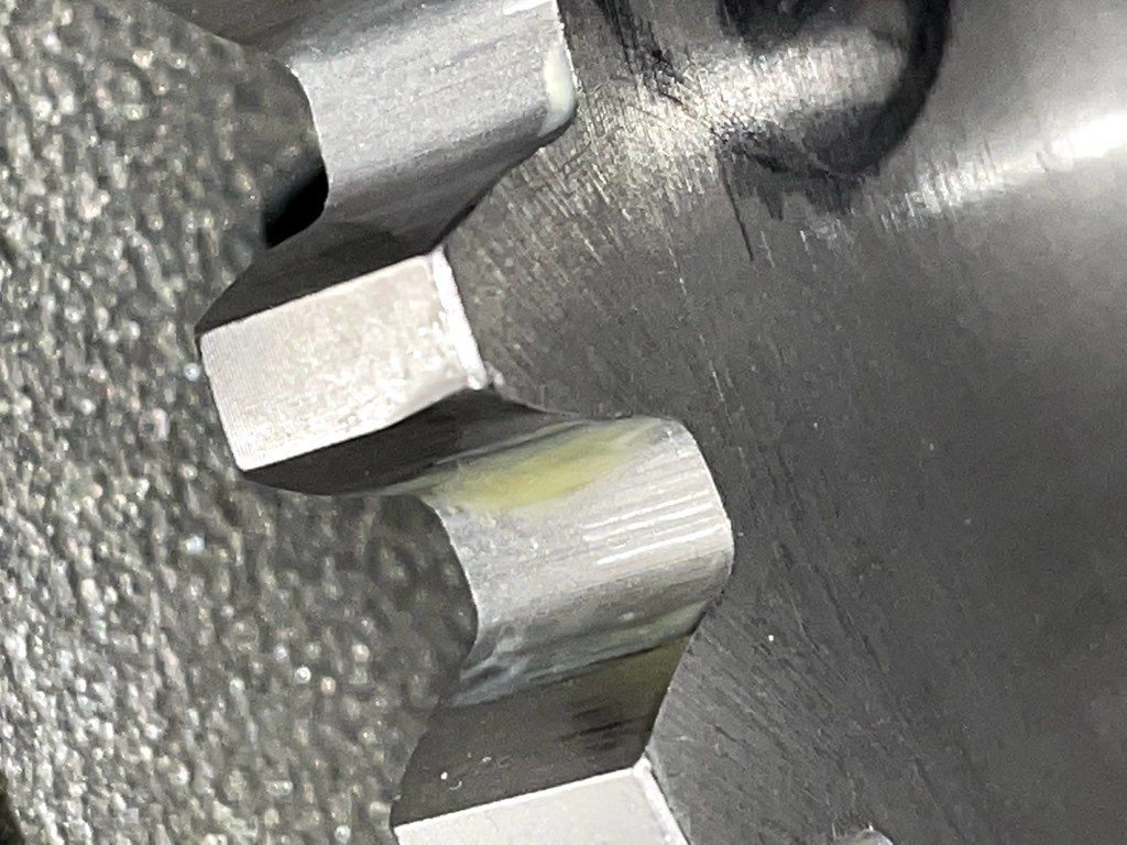

Alright, let's give this thread some closure. After one of the longest shipping delays I have ever experienced the mag made it back to Aerosport in early January. They noted that the flyweights on the impulse coupler appeared to be made of a softer and darker metal than an older mag they compared it to. It would certainly explain why this impulse coupler decided to fail.
Taking it a bit further I saw my friend Wirejock was selling his two mags so I had him take a picture so I could visually compare. Here is the side by side with his mag on the left and mine on the right. The metal certainly looks different! Larry's is consistent with other mags I have seen on the internet as well.
mags by Jereme Carne, on Flickr
I'm not sure what caused this manufacturing defect (wrong metal used or missed heat treat?) but the engine is now repaired and was started again two days ago. See post 614 in my build thread on how the repair went. (good pictures in that one)
