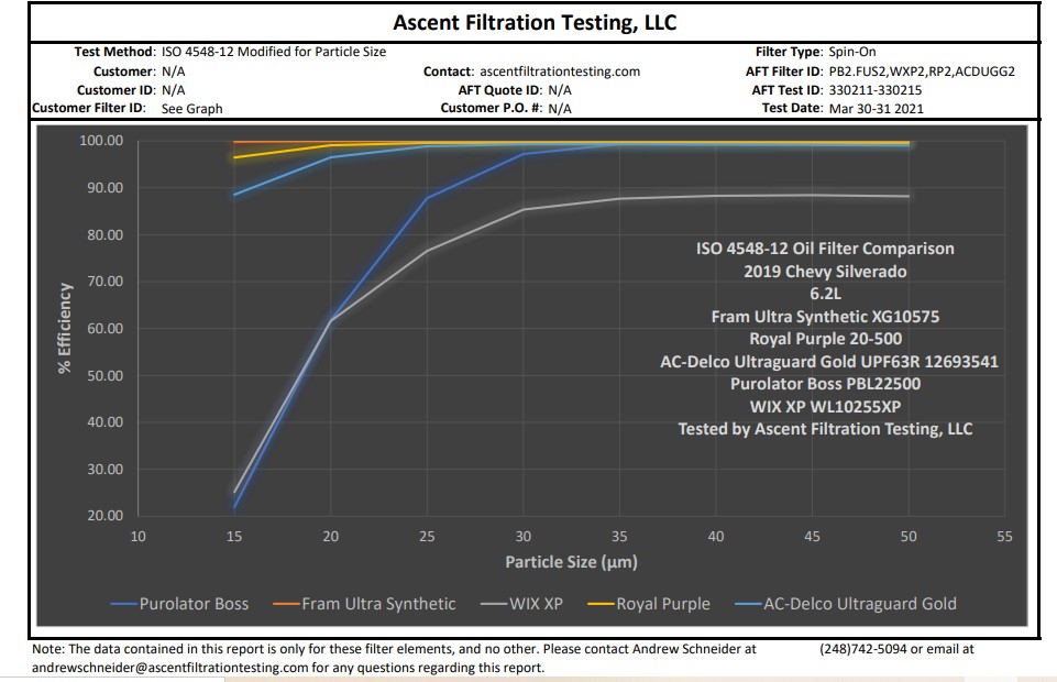

So I was looking at Wix filters as they seem pretty popular on this thread based on the test done by DanH, but looking at other ISO 4548-12 test results on another forum, the representative Wix filter there was actually the worst of the lot. Different filters, sure, but the working assumption with Wix on this thread seems to be that they are largely similar with respect to filter efficiency. The Wix might be good enough, but based on this lab's testing, there are almost certainly other choices which are better.
Worth mentioning also is the lab's comments about the Wix filter (and one that could be applied to any individual filter on any individual test):
"It is possible that this Wix XP filter is an outlier. We would need to run a sample lot of random filters to know with any kind of statistical certainty."

Perspective...On the chart below, the Wix doesn't look as good as some. But consider, right here in the Vans community, we had a very high percentage flying $40K engines with "filters" that wouldn't even make it on to a chart scaled as shown. A filter rated poorly by the standards of the auto, HD truck, and heavy machine industries is absolutely awesome compared the expensive garbage many were using. Any physically reliable filter with enough dirt capacity for our very short 50 hour oil change interval is a huge improvement.
I do not see in the plot (post 328) at what time into the test these efficiencies were recorded. The plot could be deceiving if the efficiencies were at very beginning of test on a brand new filter. To really compare with the test results Dan had done we need to know at what point this data was recorded. I think how fast filters clog up is important which then requires knowledge of burst pressure and bypass settings as Dan mentions.

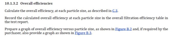

Your point is well taken, as it does appear some advertising selectively picks efficiencies from early in the results table. However, IF per ISO 4548-12, as I read the standard, published results are averages for the entire test period.
Note below the specified test period is 4 to 86 minutes, but as a practical matter tests run to an agreed element deltaP. There would be no value in running the test to 86 minutes if the bypass is pushed open or the element is crushed. Our Tempest, Wix, and Champion subjects ran 82, 100, and 110 respectively, to 10 psi deltaP. The screens went about 14 minutes. Good thing they have a 20+ psi bypass!
Do note that element clogging has nothing to do with burst pressure. Without a bypass the former would collapse the element, but does not significantly change pressure applied to the can.
C.3 specifies....
