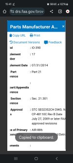

From my neighbor - “I disagree. This is not an STC, it is a PMA. If you read the specific PMA approval shown in the link provided, it is for the Challenger CP-48110 as a replacement for the Champion CH48110 filter (not a screen). So I would believe that equivalency had to be shown by Challenger for the Champion. My question is how were they able to show that, given the poor performance of the Challenger relative to the Champion using the ISO test standards for full flow filters”.
If I were to attack the PMA, it looks pretty smart of Challenger- what does the filter "need" to do?
The PMA calls out the STC.
Circular/chicken vs egg logic...
