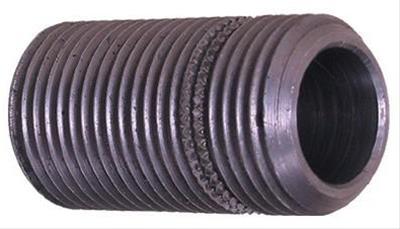

Okay, so as a data point we've agreed the 51515 will not practically fit on a Casper, at least on a conical IO-320. I'm also looking at the 51307 or the K&N HP-1002. The K&N has been mentioned in years past in the archives as working on a Casper. Other than Summit mentioning the K&N's burst pressure at "over 550", a bypass pressure of 11-14, and filtration "up to 10 microns", I can't find analysis data on how good it is. Any suggestions on other models to look at?
Yes. The Wix 51348 is what crosses to the K&N HP1002. It also comes in the Wix 51348HP which has synthetic filter element. The K&N HP1002 is what was recommended by Casper Labs.
Will not practically fit a Casper on your plane without the spacer (at least, I can't see a spacer in your photos). It looks to me like your engine mount would provide enough clearance if your oil filter was mounted a little closer to the firewall.
Mounting closer to the firewall would impede the clearance to remove my #2 battery. The perspective of the one picture makes it look like there's quite a bit of space, which there is until you slide the battery straight up out of the battery box. :)
Makes sense! I bought the same filter adapter and haven’t gotten around to fitting it for a similar reason. The long extension makes it go straight into the oil separator (with limited space to be relocated) and the shorter extension doesn’t give a comfortable enough clearance from the engine mount.

Two more sources for nipples. $3.29 and $3.99.
Straight thread on the nipples salvaged from the aviation filters.
Amazed at the money they are getting for these nipples considering there are literally trash cans full of them at any FBO. Maybe I can start a retirement gig by harvesting all these oil filters and re selling the nipples!
Mike, extracted one from a Tempest, and it seemed like the short threads, previously in the filter end cap, were tight when screwed into a new filter. I assume those threads would also be tight in a filter adapter.
I suspect they are non-standard, intended to be tight so the nipple always unscrews with the filter. Are the Champions the same?
