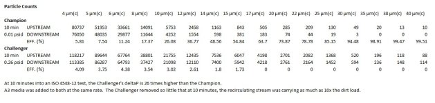

Filter Test Results
Some share your perspective. None have shared why they believe "originally designed with nothing more than a screen" makes a Lycoming immune to abrasives in the 5 to 40 µm range.
Or to the contrary, none have shared why abrasives in the 5 to 40 um range significantly contribute to engine wear. I see lots of planes with and without filters at my airport, most do a once a year oil change and I have never noticed a correlation to the filtered ones making TBO and the screeened ones not. Just my observation.

These are part of the pulsator and vibration test standards run at each 1/4, 2/4, 3/4 turns. My information is 20+ yrs old, but when I was in the business - -an oil filter test engineer said he had tested (pulse & vibration) hundreds of filters and none came loose even at the 1/4 turn. I don't have a positive test to say 3/4 will never come loose on our airplanes, but previous definitive tests say they won't. Thousands of diesels running tens of thousands of hours I never saw, or heard of this happening .
As a result of this test, thanks Dan, I have zero confidence in anything on the basis it has PMA approval by the FAA. I can not understand why this is not a criminal violation for the Challenger filters.

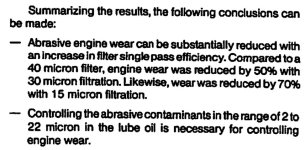

Actually I have. I'll repeat a few previous illustrations below. There are more on the way.
When speaking with a friend a few days ago, I suggested the best analogy might be health statistics for smokers. If we look at life expectancy statistics for heavy smokers, we'll see some percentage live to 100 years old despite the health effects, while some percentage reach normal life expectancy, and some percentage die earlier than normal. When compared, we see higher percentages of non-smokers reaching 100, more living a normal lifespan, and fewer dying early.
Filtration is much the same. Some engines will go past TBO, some just to TBO, and some will die early. Better filtration improves the odds, but just like smoking, we're not going to convince everyone.
Schwaner:
Heywood:
Staley:
Pocock (from 1956!)

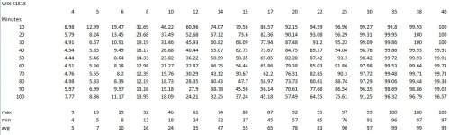

The Wix 51515 and the Wix 51348 are the same except that they are different. The 51515 is longer and fatter. The 51515 is more the size of the Champion filter and the 51348 the size of the K&N HP1002.
I don't see any problem using a filter that has a bypass valve with the adapter that also has a bypass valve installed.
You get double the protection. A WIX filter 51515 will bypass 2-4#s before the Lycoming bypass.
...which protects the filter (i.e. prevents element crush), but not the engine. I'm thinking about startup with 50W viscosity.
The 51515 performed well in the filtration test, but I'm sure there are choices with similar or better performance, and better physical specs. Already pointed a few with significantly higher can strength and bypass values closer to Lycoming spec. There's a subtle aspect to a filter designed with a higher internal bypass pressure rating...the element and core tube must be stronger. I'm looking around, as are others.

About those beta ratios. So far I've been expressing filter efficiency in percentages, as everyone understands percentage. They can also be expressed as a beta values. Beta can be understood as "given this many particles, one gets through". Wix generally publishes a dual beta, but the format is a bit whacky. Rosetta Stone below.
Note Wix claims a 2 beta, i.e. 50% at 6 µm, but our 51515 results show 10% at 6 µm. Likewise, a 20 beta is 95%, but our results show 78% average at 20 µm. It is pretty close to 95% for a brand new clean filter. Point is, the actual values are good, but they're not what Wix is claiming.
Wix 4548-12 efficiency values. Microns at top, table in percentages.
