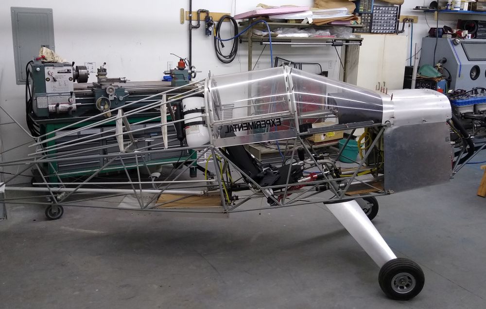

Not an RV, but some may find the techniques transferable, and I'd love to see a bit more custom stuff in our fleet. These parts feature carbon's primary structural attribute, stiffness. They're for an orphan Rans S-9 which wandered into my shop.
The standard canopy is not tall enough for me, and it's ugly as sin.

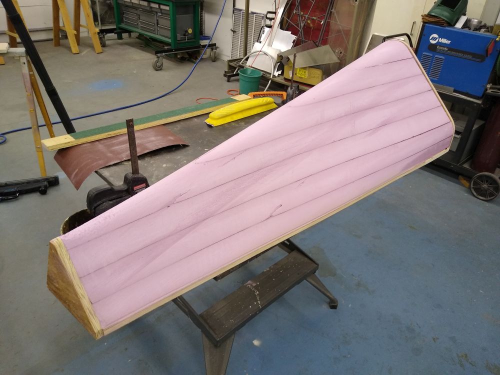

I decided to convert to an open cockpit sportster, a fun flying adjunct to the RV-8. At the regular 08A Sunday sunset meeting, one of the group sort of dared me to build it all in lightweight carbon, which was actually sensible, unlike most of our beer meeting ideas. The current plan will make both sections removable with just a few fasteners, quickly exposing the entire interior of the fuselage for inspection and maintenance.

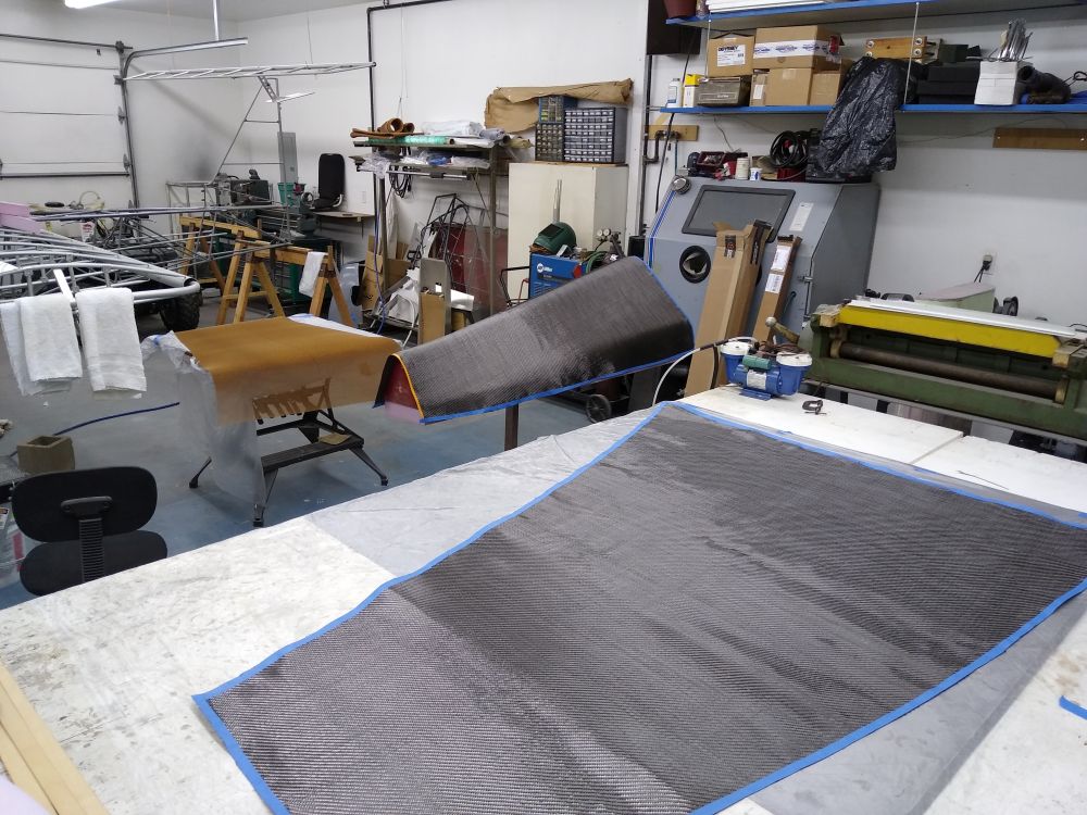

Really stiff parts at lowest weight require that the top and bottom fiber elements be moved apart with a core element. Here I went with 1/8" honeycomb, similar to a Vans cowl. The best matrix application (the epoxy) would be to use pre-preg, but I was far too lazy to build the necessary oven, pre-preg is expensive, and cheap foam forms can't be baked anyway. The game was to see what I could do with a typical home shop wet layup, vacuum bagged.

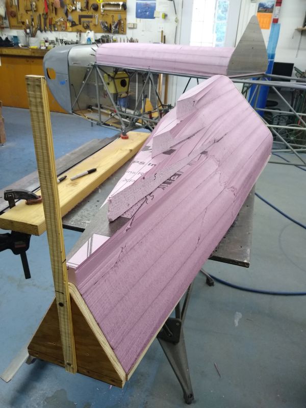

First thing was to make two foam forms. They required a nice surface finish, in particular the turtledeck, because I want to leave the inside carbon pattern exposed. For whatever reason, folks just love the look.
Methods are just like the smaller parts in previous posts...shape foam, seal it, give it a smooth finish, wax, PVA, and do the layups.
Clean up, then lay out and cut all the materials.
Now for the fun part. Very rapidly, drape the first ply of 5.7 oz twill on the form, wet it out, then drape the honeycomb. Wet out the top ply of twill between plastic sheet to keep epoxy ratio reasonable, peel one side of the plastic, and drape it over the honeycomb. Add a perforated release ply, and a bleeder ply, then slide the whole thing into a big bag (furniture storage bags are huge), seal it, and apply vacuum.

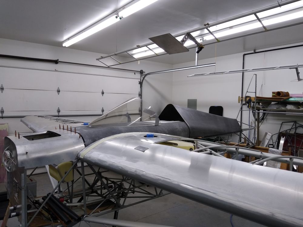

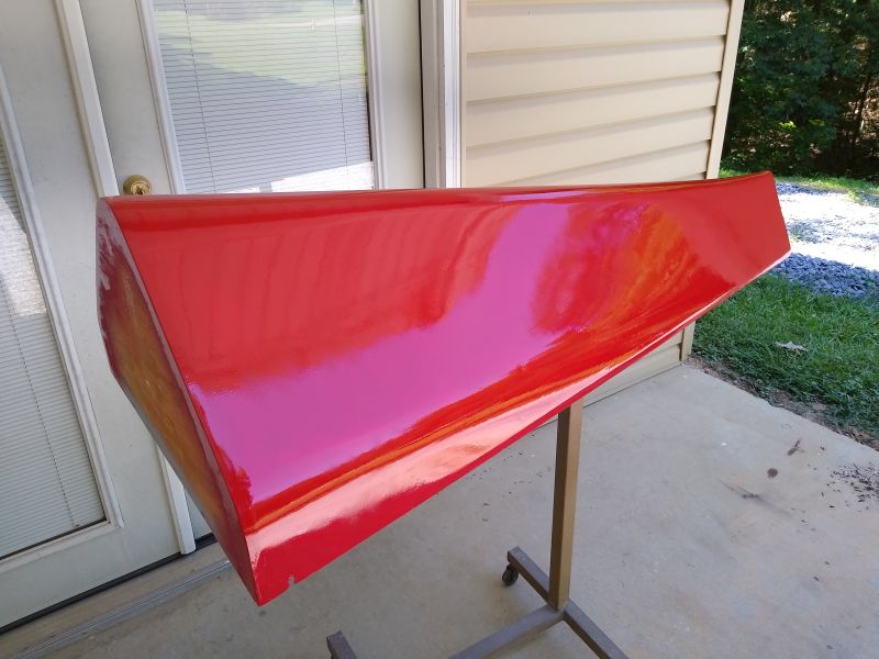

The raw turtledeck shell, untrimmed, weighs a bit over two pounds. It would be a little lighter if made from prepreg, as there is some excess epoxy with the wet layup. However, the wetness means the interior finish is attractive with no other work. It is very stiff, and not being structural, more than strong enough to mount on the airplane with no interior ribs. It's just a big fairing. I will put a headrest bulkhead in the cockpit end.
The cockpit cover was made in a similar fashion, but with more carbon (5.7 twill and 12oz plain weave on the inside, 12 oz plain and a top sheet of 9 oz glass on the outside). It must support the windshield, and stand up to abuse when the pilot gets in and out.
Plenty more detail work to do, but here are the basic shells. I have two windshields, one the forward end of a broken RV-4 bubble, and this one, the aft end of an RV-8 bubble I found in the shop attic. I have not decided between them yet, but it should be a cute airplane either way. More later.

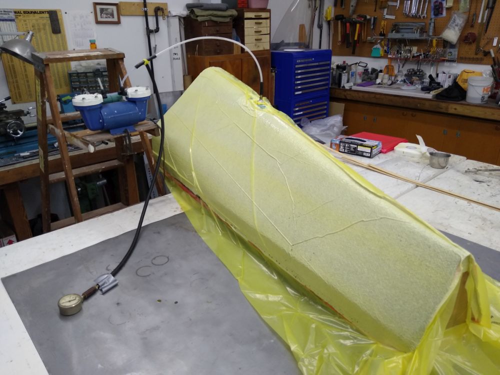

So, Dan, is your vacuum pump regulated? What depression are you using? My pump would suck the foam down flat :D:eek::o
Yep, limited to around 20", controlled leak when necessary. Seems to be close to the limit for pink foam. My crappy little junkyard pump rarely pulls more than 22" or so anyway.
I have to get a different pump and try this on my next vacuum bag project. The actual vacuum pump i use for infusion can not tolerate excess air with a leak.

I rescued a worn out pump from our pond aeration system and it pulls about 20" (a new pump does 25") and could do less with a controlled "leak" valve.
On your layup, it is faint so not so bad, but it was probably stiffer along the micro bond lines, hardly a solution for that. But good to know what to expect.
It's handy to include a leak valve, pressure gauge and a sump. Never know what debris might come back.
Interesting, the discussion about the pressures. Here in Colorado I can't get much about 20" anyway.

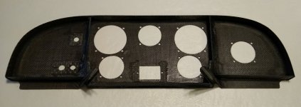

Carbon panel. There is still a place for basic steam gauges in very light VFR projects.
Face is one ply of 6K twill and two plain weave, with a perimeter flange and two upright ribs. The flange and ribs are simply strips cut from a bagged 3-ply 12K flat layup, attached to the face panel with a flox fillet. A little black epoxy dye makes the flox blend in nicely.
The half-rounds are four plies of twill formed on a waxed aluminum tube from the scrap bin. They seat the panel on fuselage tubes. One screw and nutplate will attach the top of the panel to the cockpit cover shell.
Hope it gives you crazy ideas about making something custom for your RV ;)

We find that whenever laying up over foam molds, we limit the vacuum to about 12" to prevent compressing/distorting the mold. Yes the foam is an elastic material and will compress some at any vacuum. But it seems to 'yield' somewhere above 12" and the distortion becomes much more evident.
On the vacuum pump I put a tee fitting, and then in one leg of the tee, put a needle-valve and a gauge that allows me to set vacuum fairly precisely. My cheap ($30 on ebay) medical diaphragm pump won't pull more than 18" or so anyway, and that works well for small parts.
For big parts, like glider wings, we have a big vacuum pump mounted on top of a surplus water heater tank that provides a large capacity vacuum reservoir. That pump can pull about 24" at the shop altitude of 4000 ft. I'm sure it would pull much harder at sea level.

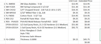

The chopped strand and milled glass fiber are just shop clutter. We're not building boats.
The 7781 8-harness is for highly curved layups. Good stuff and I always have some in the shop, but for low curvaturet parts a plain weave wets out easier.
