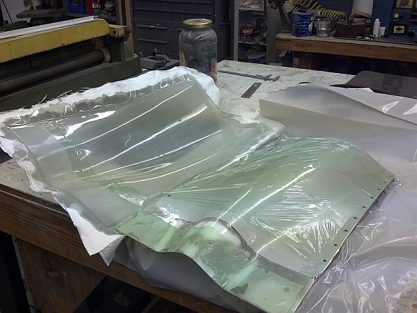

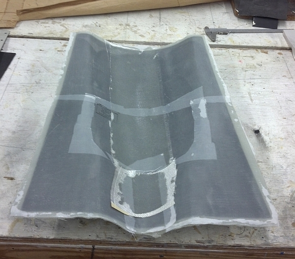

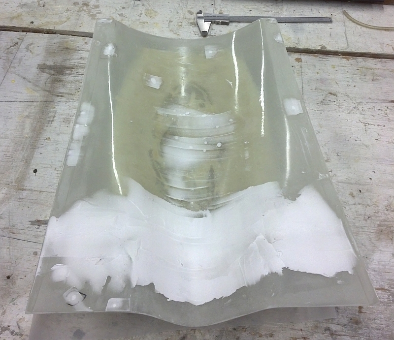

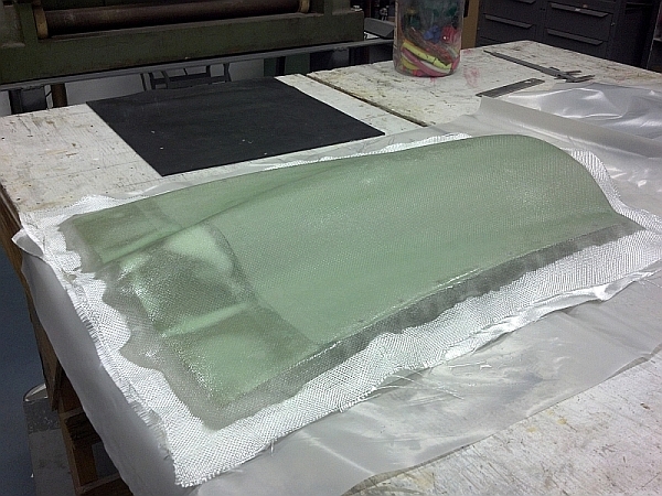

More general fabrication. The task is to duplicate an existing cowling outlet panel, with a 4" extension. Later this panel will be modified to incorporate a variable exit.
The job needs a female mold. This example uses a quick-'n-dirty mold made with materials at hand.
Started by cobbling up an extension, as the need panel needs to extend aft of the firewall. It was simply taped to the existing panel. The existing panel is slick (finish painted base and clear), so all it needs is two coats of PVA to make it non-stick. After the PVA cures, lay up two plies of plain 9oz to make the female mold. Plain weave is fine as there are no significant compound curves.
After cure separate the mold from the part with an air hose. The stuff which looks like plastic wrap is the PVA film blown loose.
In this case the mold panel isn't perfect. The taped seam between the original part and the extension needs some fairing, and there are a few air bubble voids to fill. So, scuff off the high spots with 80 grit.....
....wipe in some micro, and come back tomorrow.

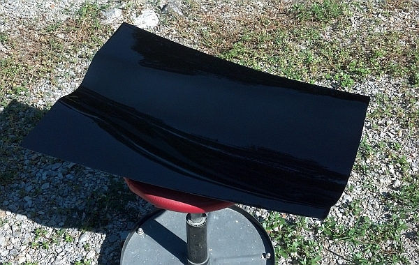

Sand the cured micro as necessary for shape, wipe in neat epoxy to seal and fill pinholes. Finish up with a cheap nappy roller to leave an orange peel finish, a good sanding guide.
Allow epoxy cure, sand it slick, shoot it with a black spray can. Whatever you have on the shelf is fine. When the paint cures shoot it with two coats of PVA.

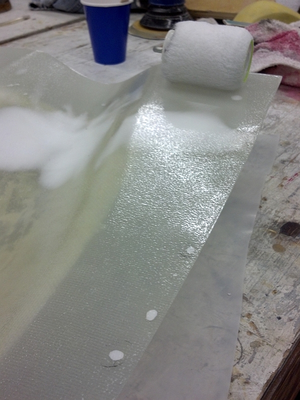

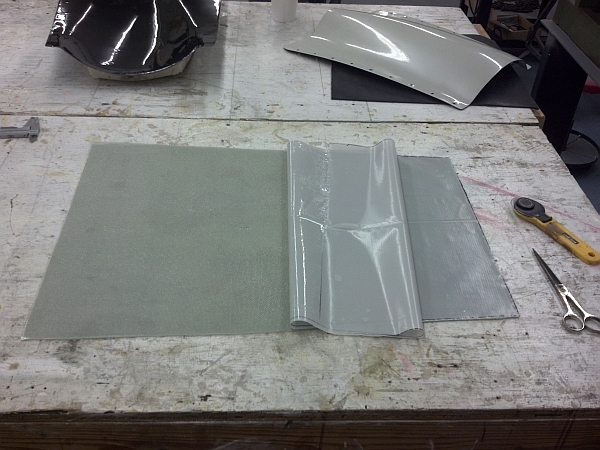

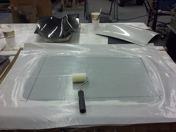

Lay out plastic sheet and stack up precut glass cloth as required. Mix resin, dump it on, add a top plastic sheet, and roll the resin into the cloth. Roll air and excess resin to the edges until you have a nice consolidated layup.
Trim to the correct size to cover the mold plus a little bit. Cut right through the plastic cover sheets. Peel the top sheet, flip the layup, and lay it on the mold.
Peel the other plastic sheet. Use a roller and a brush to smooth the layup into the mold, working out all air. The air is easy to see because you painted the mold a dark color. Add peel ply if you intend to bond to the part later. Peel ply saves sanding time as it leaves a nice fractured finish suitable for bonding with little prep. In this case I also added a strip of scrap cloth over the peel ply, down in the concave belly of the part. Epoxy tends to flow a bit initially, and would make the low spot overly wet. The scrap cloth soaks up any excess resin and tears off with the peel ply.
In the morning it is Happy Feet time.....rip off the peel ply and pop the part out of the mold. Wear gloves to handle the part until trimmed, as the glass needles along the untrimmed edges will really stick you. Trim the edges on the bandsaw and sand them straight with 80 grit on a 18"x3" sanding block.
As removed from the mold the surface finish is much like the wheelpants you get from Vans. No surprise. Subsequent finish steps to prepare for paint will be the same.

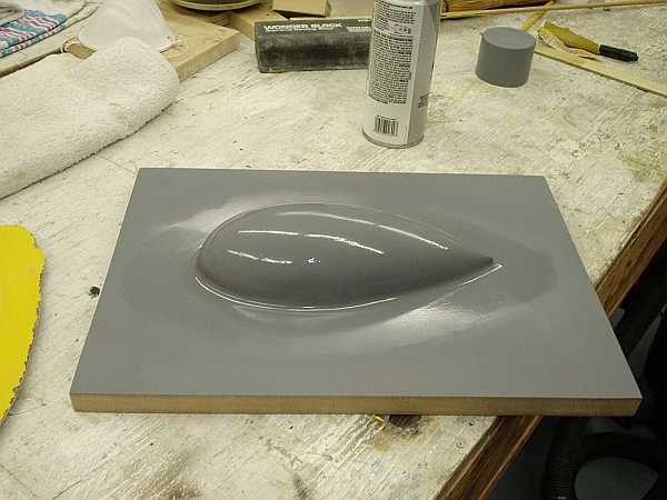

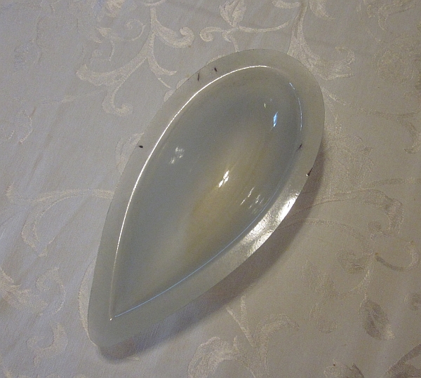

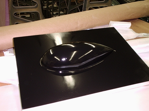

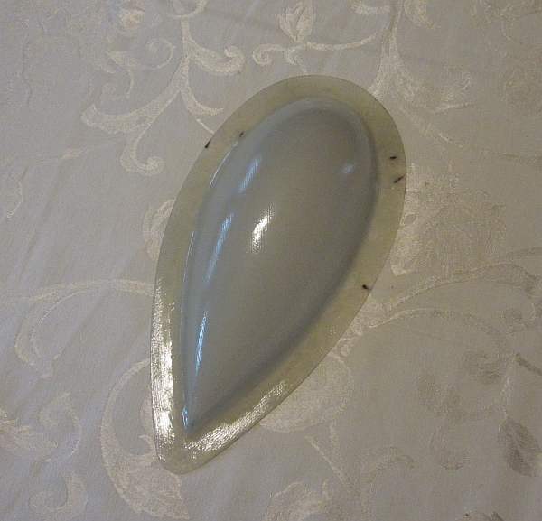

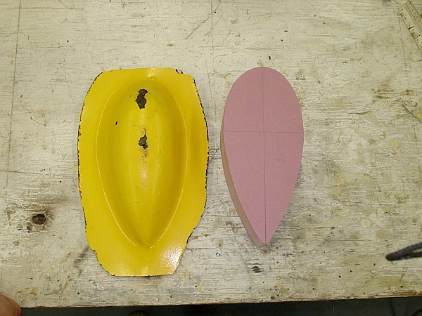

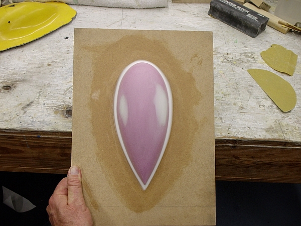

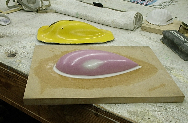

Re-creating a belly blister for a certain yellow airplane. I have no idea how a skinny kid named Dick made the first one back in the 1960's, but it was my honor to make the second.
Start with a profile in dense block foam....
....then shape to contour....
....glue to a base, add a filet, and paint the whole thing with some epoxy.
Sand slick, spray some high build primer from a squirt can, sand again...
...shoot with some gloss black, then some PVA.

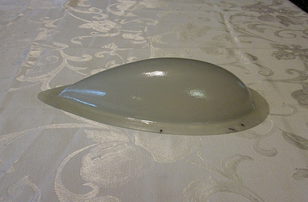

The layup is 8.9oz 8-harness satin, because it drapes so nice over compound curves. A strip of tape thickened the flange where rivets would go later.
Time to cure, a little trimming, and gee, ain't it pretty?
Now if I can just talk them into hanging the airplane from the ceiling, I can see it when I visit the museum. ;)
(Postscript...they did!)

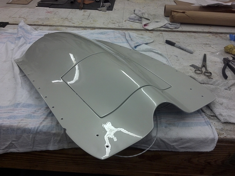

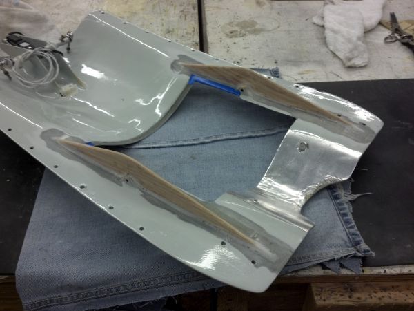

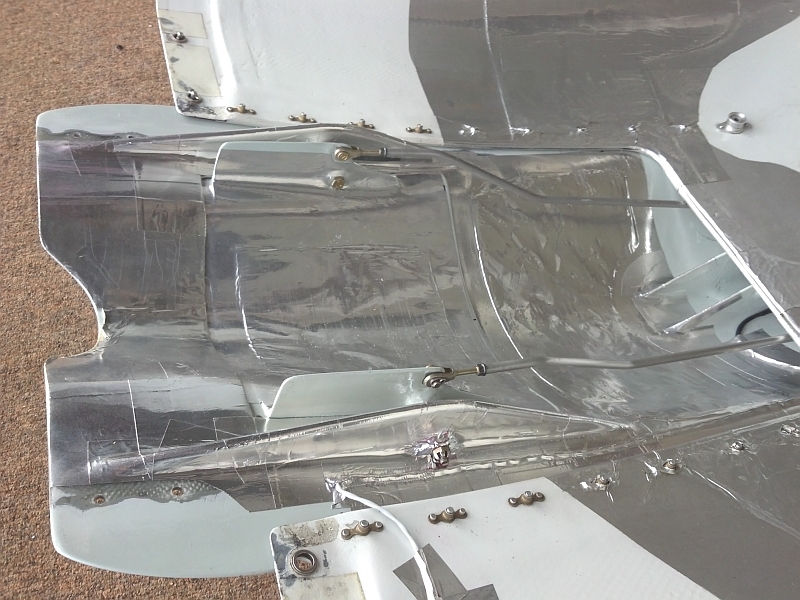

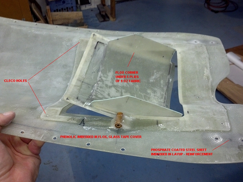

Returning to the cowl outlet panel molded a few posts back. This is variable area cooling exit door. I'll detail the cooling results in other threads after test flight, so please, save those questions. This is about details of fiberglass fabrication.
The door needs a flange for sealing, actually two opposing flanges. Before cutting the door from the panel, the inside of the panel was sprayed with PVA and a four ply layup was done to net a glass section suitable for flange fabrication, as well as general reinforcement around the soon-to-be-cut hole. The section was popped loose, trimmed to overall size, and set aside.
The door was cut in the panel with a fine blade jigsaw. After the edges were sanded clean and straight the hinge line was determined and the previously made glass section was cut so as to form a flange on the big panel and another flange on the forward half of door itself. The cut flange/reinforcement parts were then bonded into the cowl panel and onto the door. Clecos are the easy way to locate and apply moderate bond pressure. The holes are easily filled during the finishing steps later.
The hinge points are phenolic rod drilled for -3 bolts. Phenolic bonds into glass assemblies very well. It's not suitable for hinges if there is a lot of movement, but will do fine here. The phenolic is imbedded in flox, then a few plies of glass is applied over the flox while wet. In the photo below, the phenolic hinges are not yet installed in the door itself.
The vertical ribs on the door started as a two-ply layup flat on the bench, merely to form a flat piece of glass which could be trimmed to shape, much as you might trim a piece of aluminum. Peel ply on both sides made the subsequent surface bond-ready without much fooling around. The ribs were cut from the cured glass, then jigged in place with a few tiny dabs of five-minute epoxy. When cured so they would stand in place, a generous flox fillet was wiped into the inboard corners, then a 6-ply layup was placed across the inside of the door and up the inboard side of the ribs.
Internal cowl pressure will apply a significant load to the full-time exit slot at the aft end of the panel, which now extends 4" aft of the firewall plane. To help with the point loads at the attach screws, 1' x 3" tabs of phosphate coated steel sheet were imbedded at the rearmost attach points. As it happens, steel and epoxy/glass are close on the coefficient of thermal expansion scale.
After everything is bonded in place, the usual filling and finishing methods make it slick.

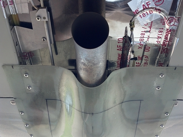

BTW, none of this is West epoxy. There is a lot of radiant heat near the exhaust header, and exit air temperature can exceed 200F. The epoxy used here is HTR-212, chosen for its high heat distortion temperature. The door could not be expected to last if it turned into a limp noodle when hot.
http://www.aircraftspruce.com/catalog/cmpages/htr212resin.php
The inside will get a fiberfrax layer in a selected locations, under a layer of reflective aluminum foil.
POSTSCRIPT Late December:
Test flight showed that the above didn't provide enough support for the hinge points; internal pressure bowed the panel outward and the door could not fully close.
The cure was the addition of a rib along each side of the door opening to support the hinge points. Wood is an excellent core material. These ribs are 1/4 thick red oak, but almost any straight grain non-oily hardwood would be fine here. For serious design efforts refer to ANC-18 and ANC-19.
The ribs were floxed into place. After cure the flox was sanded to a neat concave fillet and two plies of 8.9 oz 8 harness were added. After finish sanding a coat of neat epoxy sealed the surface, and later the ribs were covered in reflective self-stick aluminum as a heat shield.

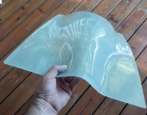

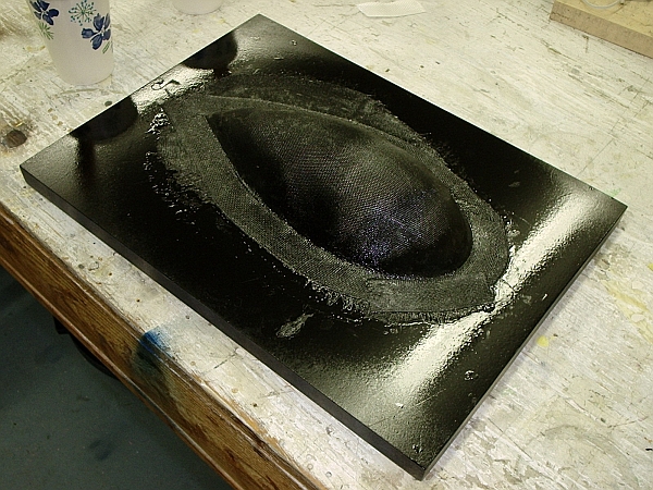

First step is to develop a shape. You can use whatever works. Clay is popular. I used pour-in-place foam this time, and a few cut back chunks of an old Van's fairing. Tape off the aluminum to protect it and shape your medium as required.

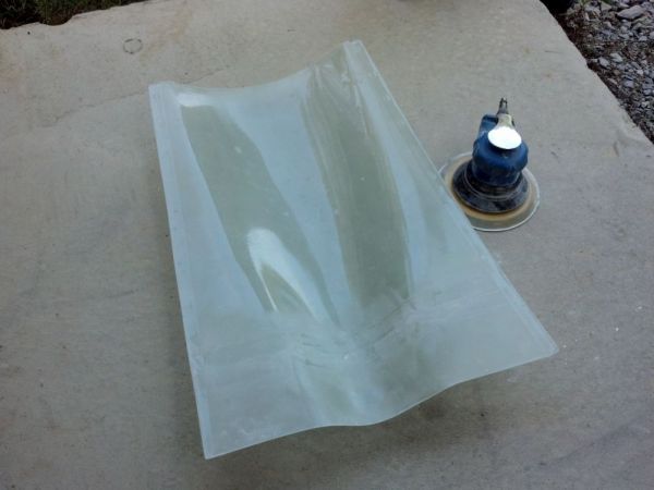

Hey Dan or anyone else who's used pourable foam-- I have some Fibre Glast pourable foam, and before pouring it into my empennage fairing cavity, I did a test with some plastic containers. This stuff really sticks to the plastic! How did you get it cleaned off the tail cavity after you laid up the fairing? Did you have to spray some mold release in there? Right now I just have packing tape protecting the metal and filling the holes.
[/url]pourablefoam by jabiruchick, on Flickr[/IMG]
So I answered my own question... I sat there a few minutes staring at it, then grabbed some 1" bead foam and made some divider inserts for the cavity under the VS. This way, the foam won't be a solid chunk wedged in there and I should be able to cut/lift it out of there easier. After working with the foam on the airplane, I realized that it does release very easily from the packing tape.
[/url]2016-09-10_05-05-00 by jabiruchick, on Flickr[/IMG]
I've found that the pourable foam looks a lot like Great Stuff foam in a can, but its air pockets are much smaller and it carves much easier. I can almost feather it down to a wedge. It only took a couple of hours to whittle it down to a workable plug.
[/url]2016-09-10_05-06-12 by jabiruchick, on Flickr[/IMG]
[/url]2016-09-10_05-20-12 by jabiruchick, on Flickr[/IMG]
