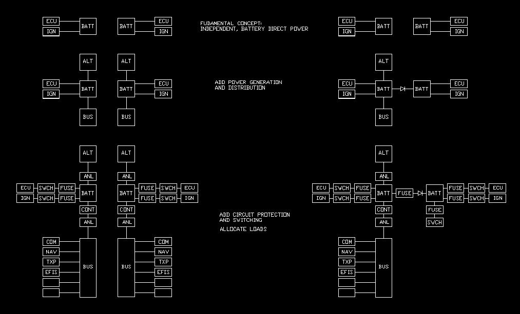

9/13/2023 - Updated drawing at post #149. EFI/EI on single bus with dual feed. EFI/EI bus and avionics busses supplied via MIDI fuses.

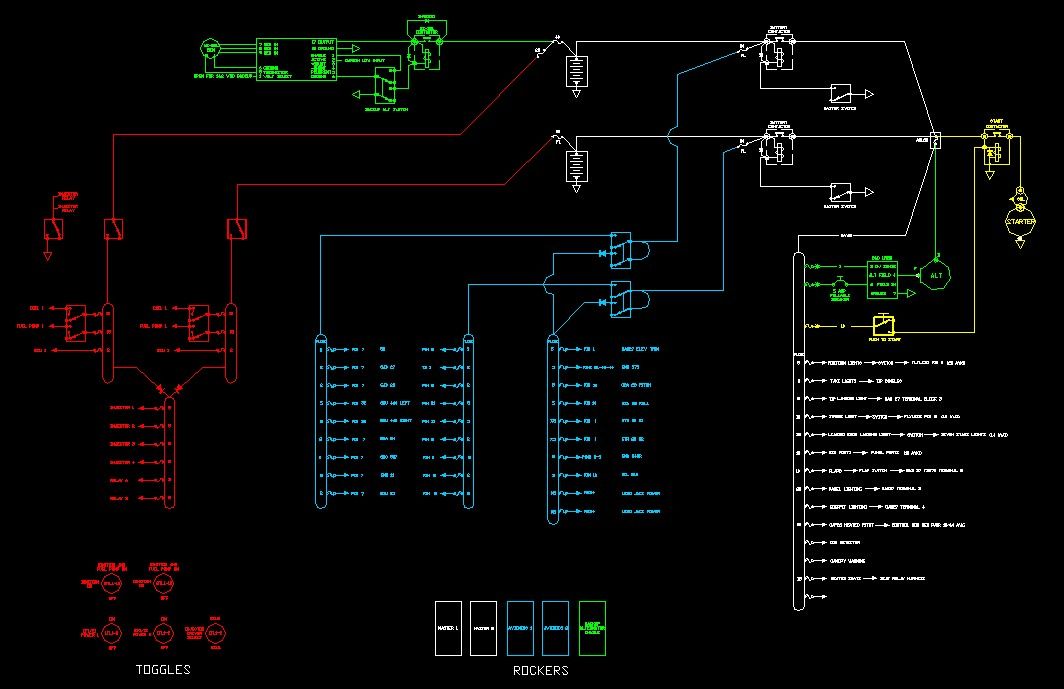

I'm going to post recent work, and risk being branded a heretic.
Opinion...the current approach to power supply wiring has become far too complicated, both physically and operationally. Both aspects can be simplified, if we throw out some fixed thinking.
The attached is a dual bus, dual battery, dual generation system, supporting an SDS EFI /EI, and a three screen G3X/G5. Batteries are ETX900's. Primary alternator is a B&C L60 w/ an LR3D. Backup generator is an MZ-30L. The G5 has its own battery.
Yellow: cranking system.
Green: power generation.
Red: EFI/EI.
Blue: avionics.
White: typical main bus functions.
System is effectively modular.
Nothing exotic at the main bus. No field switch, just a pull breaker, which is mostly relegated to being a test function. The LR3C handles overvoltage.
The leftmost avionics busses dovetail with the dual power inputs on many Garmin products. Single input avionics go on a bus with dual feeds. Avionics may be fed from either battery, or one.
The SDS power supply is critical. Again, feed is from either battery, or one. Each coil/fuel pump switch is a three position Honeywell 2TL1-10 wired as OFF/COIL ON/COIL & FUEL PUMP ON.
The MZ-30L has several interesting features, foremost being self-start and electronic current limiting. Here the primary purpose is powering the SDS system no matter what. As a secondary mission, it will also support limited avionics and main bus function. It's wired with a relay or contactor because it's connected to battery #1, and the regulator does have a small parasitic draw. With the ENABLE switch closed, it is in standby, and comes online if bus power drops to battery voltage or less.

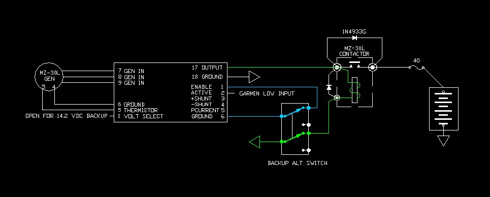

Note a typical Monkworkz application ties the regulator output to the switched side of the main contactor. In that case, if set as an auto backup (regulator pin 1 open), it would not need a relay. Again, here the goal was to feed an SDS bus with the masters open.
Operational simplicity should be a major design goal. When the spit hits the fan, pilot IQ tends to go out the window, at least for a little while. So, let's make the switching intuitive, and more important, arrange it so it requires little or no pilot action given power failure.

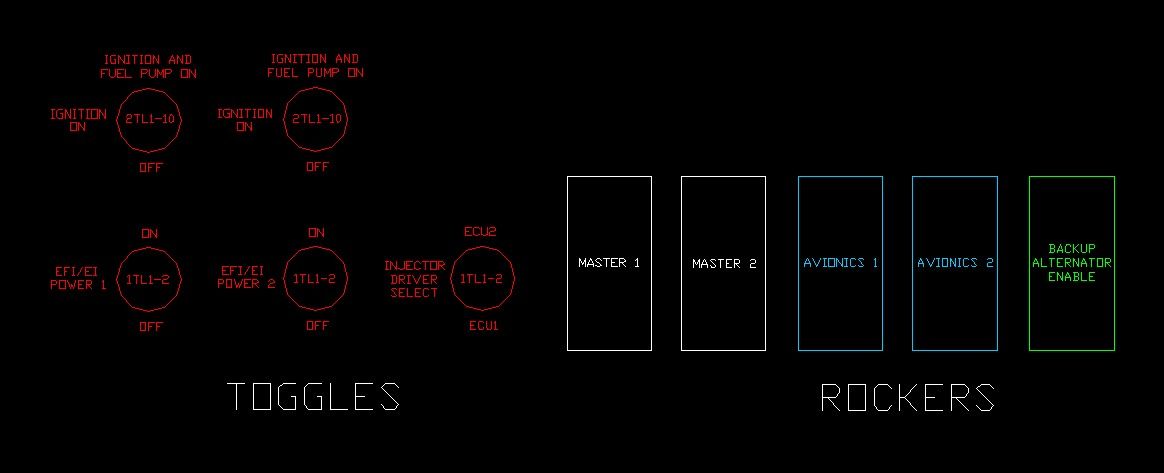

This is going in an Aerosport panel, so all the toggles to the left of the pilot's display are for the SDS EFI/EI. The critical rockers (DPST Carlings) are below the display. Note the conceptual similarities to traditional systems. It's basically mags and masters.
For a critical flight regime (like departure), the switch settings are dead simple...they're all UP, with one exception, INJECTOR DRIVER SELECT. Given power loss at 300 feet over the trees, the entire pilot response is flip that one switch, and change tanks. Again, pretty familiar.
First pass, a basic "open or short" review doesn't turn up any critical issues, but if I missed something, hey, I'm all ears.

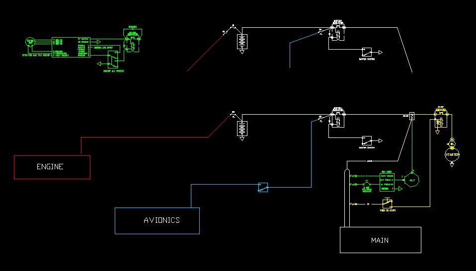

On a bad day, both main contactors can be opened, which immediately dumps the large loads and brings the MZ-30L on line. Avionics load is about 10A, maybe 13 running autopilot servos, and can be less. The pilot has access to both batteries and the MZ-30L, in any combination.
On a really, really bad day, the MZ-30L carries the SDS, and the G5 is on internal battery.

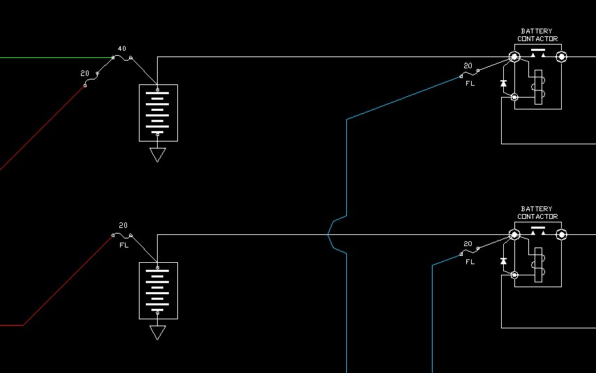

Dan, what is the purpose of the 1N4933G diode in parallel with the Monkworkz contactor?
If the contactor contacts develop resistance, wouldn't the diode smoke? Thanks
Thanks for this. I'm laying out my SDS EFI/Ei system at present, and your approach has given me plenty to think about.
Have you considered locking toggle switches for the EFI/EI circuits? They're not something that you want to have any chance of inadvertently knocking to off.
Also, why the three-position switches on the pumps and coils? Why are these preferable to something like separate 1TL1-2D switches on each component?
Problem with this approach is a runaway alternator that is overvolting can damage everything connected to it. Have had this happen while giving dual in a RV-6. It is best to keep busses completely independent, have some things on one and some things on the other, charging independently with a buss-tie in the event that power sources are lost. Most modern twins are wired this way.
I see a lot of diodes. Do you have a source for those? I’ve had trouble finding diodes that would handle more than just a few amps.
Four, not counting the dinky ones on the contactor/relays coils. Driving the injectors requires 2 to 5 amps. The avionics bus could see a peak surge as high as 15, but typical is more like 6. Lots of choices in these ratings.
Joe, you always have a great eye for electrons. Bill Judge suggested it so the regulator's OV protection would not trip into lockout if the contactor was opened under load three times in the same power cycle. I suppose burned contacts could smoke the diode, but it would merely set up the possibility of a lockout.
..why the three-position switches on the pumps and coils? Why are these preferable to something like separate 1TL1-2D switches on each component?
Operational simplicity; fewer switches, simplified runup pad checks. I'd be happy to replace them with fuses and merely switch the power supply to each SDS bus, but switching the ECUs while running makes Ross nervous ;)
Both regulators have built-in OV protection.

I have separate switches for fuel pumps and ignition to be able to shut off one fuel pump in cruise. A three position switch for ignition will require 2 5 pin relays to reverse the switch.

Dan, a lot to absorb here, but one area I do have a little experience is the MZ30. I have an enable that is on all the time, BillJ has a feature to enable a ground when the unit is operating and flash if overloaded. It is a low cost LED and takes little panel space on either side. Also, a momentary button can run this LED to ground as a test feature to ensure it is still functional. These wires are all low amperage and could take less space and $ than a large rocker.
I like to have a positive indication that the unit is working, a way to ensure the feature is operable, and some warning if the power is about to be electronically controlled to OFF.

Curious about the need/utility to have a switch for the coils AND fuel pump since removing power from either one results in engine stopage.
Why would you want to create a situation in flight where the coils were on and the pumps off?

I assume you're connecting the output on the switched side of the main contactor, as prescribed in the manual.
This one is tied in on the hot side of the main contactor, so it requires some sort of disconnect to untie it from the battery when parked. There's a subtle reason for the tie to the hot side.
Clearly no problem to connect the MZ's output to the main bus side when opening the main contactor does not result in engine power loss. Good example would be an aircraft with P-mags, and a carb or constant flow FI. Typically the battery bus, if present, drives a few avionics choices...the classic Nuckolls "essential" bus.
Same with an EI/EFI dependent on airframe power, IF the hot bus has the necessary amp capacity (Tim, your diode sourcing issue?), and the battery is lead acid. The system is dependent on battery power to remain aloft.
1. To run on one pump, for reduced power demand. Budget is 30 amps when running on the MZ-30L. Nice to keep the avionics instead of an unnecessary pump, and nibble at the battery capacity only short term, like for com transmit.
That's one change of thinking here. These days, the typical "essential bus" is loaded with a heap of Garmin or Dynon, and folks try to drive it all through a diode when the main bus feed is gone. Burn me at the stake, but maybe the essential bus concept is past its prime. Here we accept the desire to keep the avionics and engine, not as a special case, but all the time.
2. Operational simplicity. On the runup pad, cycle each coil/pump switch just like a mag switch. Both up for departure.
Dan,
My plan also has the Stby Alt (B&C 410-14) tied to the hot side of the main contactor. I wondered about the battery back-feed, and have been meaning to talk to the folks at B&C. Are you familiar with the inner-workings of the B&C as to whether I would also need some type of disconnect?
Thanks.
Nope, sorry. Let us know.
Thanks Dan. My "second" pump come on line with a discrete switch (in my case, a pushbutton on the throttle lever itself).
So pump #1 is on the main bus?
I did this specifically to align with the decades of training and muscle memory to flip on the "boost pump" in an engine out, approach, or takeoff scenario.
We should all be considering that aspect in design work. It is a key point here. All pumps and busses are ON for departure (all switches up), with a single exception, the ECU select. Subsequent power failure = flip switch, change tanks...the same response we were all taught.
What did you do with your ECU select?
Fair note...IIRC, the System 32 doesn't require an ECU select. Now if we can just wean those users off the Box 'O Diodes ;)
Understanding that this is the SDS pump module and has two identical pumps, yes, my primary pump is driven off the "engine bus", while the "boost pump" is activated by the "ship bus". In normal ops, the engine and ship busses are tied with a relay. But in an emergency, I can sever the two and turn of the ship master with no effect on the engine.
My ECU is a three position locking Honeywell toggle with pri-both-sec. This switch is the center position for normal ops. Immediate action in the case of engine silence is similar to my early training - boost, switch tanks, fiddle with a switch...
If that doesn't bring it back it's probably time to start looking at a landing spot
Are there any concerns that a short in the "joint" devices / busses could bring the both electrical system down?
I was considering a system with two electrical busses (I guess, something similar, with SDS EFI, lots of Garmin avionics, etc) that are independent as much as possible, and the shared components is where I struggle a bit. I'll admit though that I haven't studied much yet.
For example, if there is a short in the GSA 28 / wire going to GSA 28, then hopefully the fuse that will blow up will be the servo fuse. Which maybe could be controlled by using a slower "main" fuse?
However, if the busses themselves ("dual feed" bus and the "injectors" bus) get a short somehow, they could bring both electrical systems down, right?
I guess, the same is true for the "dual" feed Garmin devices, but assuming they use internal diodes, the only "short" to affect both power sources would be the one inside the device itself -- which should be extremely rare.
I published an "open or short" list in the first post. It's required homework. Number every wire. Examine each one individually, and work out what happens if that specific wire goes open or gets shorted. Not unusual to find something which needs rearranged. Sometimes you get a real surprise.
The bus feeds get circuit protection (fuse, fusible link, ANL, CB, etc) with a rating much higher than the individual device feeds. There's nothing hopeful about it. In your example, the 5 amp servo fuse would melt before the 20 amp feed fuse got warm.
No. That's why each bus feed gets circuit protection.
What guarantees this property if there is a 100A short current? Technically, both should trip. Why 5A would necessarily trip faster?
Ah, right. However, it seems like the short on the rightmost blue buss would still bring two other blue busses down?
A typical essential bus arrangement.
1. Normal ops, relay closed, short the engine bus. What happens?
2. Open the relay, and you're feeding the entire engine bus load with a diode, yes? Do you cycle the relay switch on the runup pad to see if that feed is intact?

Maybe I'm missing something - but based on the schematic it looks like the MZ-30L contactor cannot be activated unless the MZ-30L is already producing current. Maybe this is by design?
Couple of observations:
1. Turning off both Masters will not interrupt power to the Main bus (if the engine is running). The alternator will happily keep alternating until you interrupt its Field power. You could fix this by using DPDT Master switches so that one set of contacts in each switch turns off Field power at the same time as turning off the main contactor.
2. Since you're "simplifying" here, why not get rid of the Starter contactor? As long as you're using a Skytec LS or equivalent with on-board solenoid, that will work as a contactor too. The inrush current into that starter-mounted solenoid is too great for a typical Start switch, so use a Bosch-style ISO ("ice cube") relay to power the solenoid coil. The only concern with this scheme is you have 24" of hot cable firewall-forward. But if the intrepid pilot remembers to turn off the Master(s) before crashing, it's not a concern.
...Sounds like power feed to the ECUs. Failing that switch takes out both ECUs? And you have another switch controlling the injector relays, i.e. which ECU has control of the injectors?
Yes. If this switch dies in service, the engine quits. Ecu, coils, pumps. No workie.

1. Could the two avionics masters be a single DPDT switch that would take care of both? Seems like if one side dies, the diodes will keep it working with both switches 'on'. A single avionics master would be more like a traditional scheme.
Could make it work, but the traditional complaint is all the avionics on a single switch.
2. You pull power for the avionics bus on the hot side of the master contactors. This means that opening both masters does not kill the avionics.
Nor the engine.
Seems like traditional schemes and training is in the event of smoke in the cockpit, you turn off the master, so one action turns everything off. Then you can turn off all the individual devices, bring the master back on, and see what systems you can power back up without getting more smoke.
Not a big deal, but with your system, the correct action in the event of cockpit fire is probably both masters off and both avionics masters off. 4 switches.
True. Use four fingers?
I kid a little, but seriously, this one is an Aerosport panel with rockers like piano keys. On any panel, it's just a matter of arrangement. Really dumb would be scattering those four switches all over the place.
3. Combining #1 and #2 here, seems like a single DPDT avionics master that is connected to the switched side of the master would be a good choice. What are the reasons why not?
What you're suggesting is more or less old school certified practice. Current EAB practice (Nuckolls et al) piles avionics on an "essential bus" and gives it a battery direct backup feed via a diode. Think about it in the context of your question.
Now consider the architecture as presented...or again, the essential bus feed above. If an avionics bus or the wire connecting it to power was actually shorted, the circuit protection device (fuse, fusible link, ANL, breaker) feeding that wire would blow. If it has a problem, it turns itself off. If it doesn't have a problem, why turn it off?
4. This may be outdated thinking, but I power down my avionics bus for engine start and engine shut-down. But I need the engine monitoring box powered during start so I see oil pressure, amps, rpm, etc immediately. Of all the electronic boxes, the EMS also is the most essential for continued emergency operation. So, I would be tempted to put the EMS on the SDS bus so it is separate from the other avionics.
Nicely illustrates how different folks find different things to be essential.
I'm suggesting we not decide which child to throw to the wolves. The real goal is to keep the avionics bus up and running.
Why is the SDS bus a safe place, but we need to kill the avionics bus?
I suppose if you have EFIS and EMS combined in one box (as is more normal I guess) then that box needs to be powered all the time..
The G3X system is an entire array of modular devices, mostly remote, all tied together with conventional wiring and CAN bus. It's the far opposite of all in one box, and to a certain extent, it's all or nothing. Seems to be the trend.
...I still want radios, transponder off for engine start and shut-down.
Ahhh, then you'll love the new approach. Light up the whole panel on one battery, and crank on the other. All your worry parts are isolated from cranking gremlins.
5. Probably more a question for Ross, but does it really take 5 switches to run the SDS? Couldn't some of those functions be tied together so that just two switches, analogous to two mag switches, would run everything? As you noted, its all got to work or none of it works, so it seems like the pumps, coils, and injectors fed by each source could all be activated from one switch. So just two switches for the two sources.
Exactly what I drew first, but switching ECU power when running makes Ross nervous. As drawn now, the ECU power goes on before cranking and stays on for the duration.
6. Is there a battery failure mode that could result in a battery acting like a big sink (internal short) that could drain the other battery and overload the alternator(s)?
Not the battery, but shorting one of the big wires may cause the EarthX BMS to disconnect output. It's a sensible protection, given the battery's low internal resistance, and this design accommodates it. Wait one to three minutes and the battery re-connects.
If such a thing can happen, would you be able to tell which one so you could turn off that master?
Turn 'em both off and forget about it. Here the main bus is the sacrificial child. You lose the big alternator, but also all the big loads...lighting, heated seats, heated pitot, etc.
And I imagine the diodes in the parallel avionics buses and SDS buses are sized to tolerate that without frying?
Pick diodes with higher amp ratings than the circuit protection device feeding the bus.
And the Garmin devices that dual inputs - can they tolerate a short on one input?
I'll assume the Garmin gang would have done the same.
Fun stuff Steve, thanks for asking.
Another question about the EFI/EI system. I'm not an expert on this stuff, so feel free to tell me I'm typing nonsense, as long as you tell me why it's nonsense.
I don't know what the failure rates of the SDS system components are (negligible I hope), but I'm guessing that the pumps would be the most likely items to either fail or draw over-current, and to have the shortest lives. Therefore, it might be useful to have the pumps switched separately, both for failure modes and for powering down one or other of them during cruise, without affecting other system components. Is this something you have some thoughts on?
I dunno. Give it a try.
If you short the bus itself, absolutely true. Same for the injector bus. However, we're not talking about a naked brass bar screwed to a row of breakers. Way too old school. Lots of well protected bus products out there.
...it might be useful to have the pumps switched separately, both for failure modes and for powering down one or other of them during cruise, without affecting other system components. Is this something you have some thoughts on?
Yep. That's what I did.

Hi Dan,
In my case it was an externally controlled alternator with the built in overvoltage control that did in a bunch of memorably expensive avionics.
My dad had a lightning like discharge that took out one bus while flying a plastic airplane in ice crystals, so two examples from my experience were high voltage was an issue as much as low voltage.
With a bus tie you can get electrons anywhere you want but you don't have the complexity of multi sourcing busses separately, and most of the time its running as two fully separate systems.
I'd normally sit quietly, but you opened with "Simplified Approach" so figured I'd throw my mouse trap into the ring.
Split the devices so that the loss of either bus is not critical - and then give a battery and alternator to each.
One relay after the battery masters from each battery can connect bus1 to bus 2 with a #2 wire. This relay remains off, except in case of a failure where for whatever reason I want to power something on the other side or if I want a few more amps to start the engine.
Derek
SNIP
This is the first immediate action for any electrical fault on my planes - open both master solenoids. The panel retains power as it is feed via a separate feed from each battery - on the battery side of the masters. Once done the most stable and reliable power backup mode is established. The choice then is to trouble shoot or continue full IFR flight capability for 2-3 hours, land and figure it out on the ground.
I suggest we shift our thinking from “backup batteries” to “backup operating modes”.
Carl
Great question Dan. It produces current as soon as the pin 1 connects with pin 6 (blue). The current path is the contactor coil (green). Contactor closes. If voltage on the battery side is below 13.7, the MZ continues output. If above, it goes into standby, no output, but contactor remains closed because the coil remains powered from the battery side. It's latched as long as the coil has a path to ground, i.e. enable switch closed.
Very true. Personal preference is a pull breaker, but that does require a separate action. Ok, I'll look at it. The Carling rockers in the Aerosport panel are DPST, so there are some contacts available.
My RV-8 is wired exactly that way. Moved a wire inside the NL inline starter. The how-to was available from Plane Power before it went over to Hartzell.
Thanks Derek. I had not heard of an LR3D failing to control an OV event. It was an LR3D, yes?
BTW, I like a well considered twin bus system too, and have encouraged them right here. The illustration below is from an old post; system development block diagrams, IFR on the left, VFR EI addition on the right.
Yep
It was, though I tried hard not to name them :).. Sent it back and it came back no fault found though. Unfortunately for this one I was paying the bill but not doing the troubleshooting so never got a good answer as to why. My best guess was some sort of local ground fault that made it sense low voltage, (same as the OV sensed) so it drove the alternator to full output. Its replacement worked well for more than 5 more years.
For the rest of the design, I'm a fan of pulling the avionics from the "wrong" side of the master. Saves an amp of draw when you don't need it, avoids a failure mode and even an unfamiliar pilot will hit the avionics switches if they don't go dark when they "should". Even a better idea for the folks with a single battery system. Its a little unconventional but not in the heretic category by far.
I do share the concern on the field, smelling smoke, hitting all the switches and still having power generating heat. Too much thinking required to pull the breaker.
After that we get in to preferences and alternate thoughts...
I've never been a fan of pick the bus switches. I have a hard enough time chasing and understanding electrical gremlins on the ground when I have lots of time to think, and most of the time pick a bus means I need to understand both the capabilities of the bus I'm asking for, and the nature of the loads that I'm applying which is more than I want a new to the plane pilot to have to think out when stuff starts flying.
In a similar vein, as long as the propellor spins and the G5 stays lit - a power failure does not need to be a memory action emergency even IFR. You have time to figure out what you want to do, what loads you want to shed and what needs power. My primary design criteria is to be as intuitive to understand as possible rather than to have quick solutions to the failures I design in. I default to CBs grouped by bus since I can then make the decisions as to what I feed power to to be minimal needs to get on the ground and find the source of the smoke. Dual AV busses and fuses works too, but requires more thinking to make sure the split works for all scenarios. For example, a bad ADHRS that is creating noise, can I turn it off and have stuff revert to screens I still want to fly from? Any single failure is as far as I go, but looking at each one is a good idea. 23.1309
For dual bus OV scenario it gets interesting where you need to power the injectors. My only thought there would be putting zener diodes and CB in the circuit each side of the injector feed to create a local OV protection. I haven't convinced myself though that there isn't a better answer here yet.
Derek
I think Ivan has a point. I have no idea if the small 12v products we use in our aircraft can cause this kind of failure, but I have seen this in the real world in my datacenters.
We used an Automatic Transfer Switch (ATS) connected to A and B (a.k.a. Red and Blue) power feeds, and it provided power to the rare single-feed devices our customers sometimes wanted to use. A fault in this single-feed device took down both A and B feeds in the rack when the ATS dutifully switched to the B feed after blowing the A breaker.
Can't say if the risk is high enough to warrant a design change, especially since we're talking about a SEP aircraft and targeting a simplified electrical system.
The dual pump module is for redundancy. One does not need to run both pumps except for those critical phases of flight most of us were trained about in our initial flight instruction. That said, you do need at least one functioning to make the engine go, so I question the need to have the primary pump switched independantly of the ECU or ignition. I do not. I do have circuit protection however, so if it shorts it will drop off line and of course if it just dies, then no action required to save the buss.
Keith,
I think we are thinking along similar lines. My primary message is that once Dan decided to go dual battery, dual alternator an opportunity presents itself to have two fully isolated power sources and isolated equipment, where either can get him on the ground. Two fully separate systems can't interfere with one another, and solves things like OV.
If you can keep them separate you don't need fault detection etc, which you need if you have fail over in the background. Fewer interconnection options means no complicated drawings on the panel.
Ultimately not having a bus tie is the cleanest but I hit limitations. For example:
1. I can fly an approach on either bus, but not necessarily the one I want/need since I don't have two of everything. The bus tie, and pulling a bunch of breakers lets me solve some edge cases.
2. If I lose an alternator belt, I'd really like to get power to both sides of the engine just in case I get the double failure that we aren't supposed to design for.
The tie would be open almost all the time, but sometimes its nice to have both belt and suspenders, and for me one interconnect was better than multipule pick a bus logics.

Humor an example. Note the dual bus block diagram I posted above has no crosstie contactor. Having one requires the PIC to sort out why the dead bus went dead, before he/she connects it to the live bus.
Our presumed PIC is a non-professional who bought the airplane second hand, and really knows very little about the underlying system architecture. It's almost guaranteed that given an inflight abnormality, he is nervous, with a temporary IQ score below his norm.
Ok, apply the OV scenario to the dual bus system. One of the alternators starts pushing 60V. All the avionics on that bus burn and go dark. There's a little burn smell in the cockpit. Pulse rate goes to 150. Can we really expect our PIC to search out the two bus voltmeters and eliminate OV as the cause before he hits the crosstie switch...in particular when the voltmeter for the failed bus was on the now failed screen?
There are two keys to embracing intuitive simplicity. The first is to be humble. So often these discussions devolve into "Well, it's my airplane, and I know how it works!". Yep, Steve Canyon, Chuck Yeager, and you. Me? I once crashed a race bike because I got task-saturated by the splash of a water puddle.
The second is embracing a reality; on some future day, some other poor sod will be flying it. He is not as smart. Design for him.
