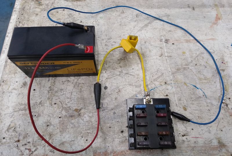

This one for Ivan.
Previously...
The bus feeds get circuit protection (fuse, fusible link, ANL, CB, etc) with a rating much higher than the individual device feeds. In your example, the 5 amp servo fuse would melt before the 20 amp feed fuse got warm.
What guarantees this property if there is a 100A short current? Technically, both should trip. Why 5A would necessarily trip faster?
I suggested he give it a try. In the shop this afternoon, it occurred to me that I probably have a more extensive junk drawer. So, I dug out a bag of fuses, a fuse block, an inline fuse holder, a battery, and some jumpers:
That's a 20 amp in the inline "bus feed", and 15, 10, 7.5, 5, and 3 in the fuse block. Be assured each of the smaller fuses sacrificed itself in a little flash of light when I touched its respective output terminal with the jumper, while the 20 remained ready to rock.
To further illustrate, I loaded a 7.5 into the bus feed and burned a 5. Then I swapped for a different 7.5 and burned another 5.
Could be a pattern here.
I would love to see the following experiment;
-load the bus to a constant 15A draw for a few minutes
-then short the 5A breaker
Now the result should theoretically depend on the fuse characteristics: slow blow vs. fast blow

Using shielded wire for power sounds good however: I once had a short on the unprotected shielded wire from a Lightspeed Ign...
The operative word being "unprotected". The armor example has a fusible link at the battery end. The idea is to make it harder to short...but it does, the burned wire will be a link enclosed in a fiberglass sleeve. Note it doesn't even hurt the tube.
