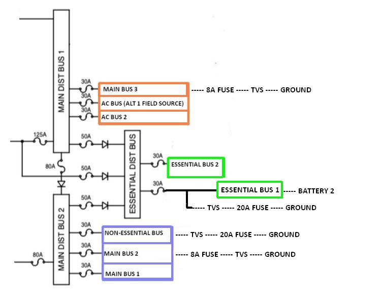

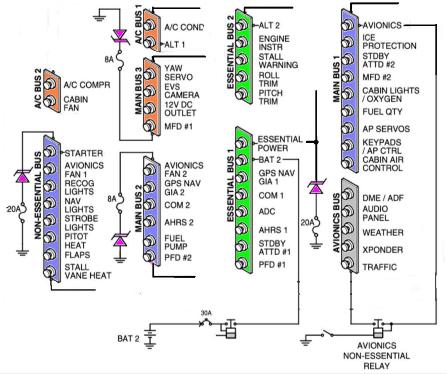

To clarify, I stripped and simplified. Here are the individual child busses:
Note the arrangement of the TVS diodes and companion fuses. Different fuse ratings, 20's and 8's, with the 20's between the TVS and ground, while the 8's are on the bus side of the TVS. What is going on here?

I can guess....
Might not have been the best example since it opens up a whole other topic..
I'll open with no relation to the program, so guessing and don't have the the parts manual so don't know the size of the diodes, but those are some pretty big fuses so very likely also some beefy diodes. The order doesn't matter.
Best guess, came from the lightning impact analysis based on the size and placement. Nav/Strobes are lighting zone 1, and lots of energy potential there.
The 2nd big one (ESS1) does either side of the essential bus, and since close to the PFD1 etc, at the same time serves as protection to the screens as the 8A ones do elsewhere.
The other two 8A ones are protecting the busses with the screens which they've been doing for a while. If you look at some of their other layouts you will see small ones just associated with the PFD/MFDs. Size increase from previous likely grew out of the same lightning analysis. I'm not aware of anyone else who does this for the screens for small airplanes, but Cirrus has had it from the early glass days, so could be baked in somewhere.
I'd be more worried about the ECUs than the screens which is where I see the application in our space.
Lots of conjecture here, but seems like it would fit.
Terrible scheme to do OV protection. When the OV condition occurs, the TVS closes and causes the fuse to blow. The problem is, in the amount of time it takes a thermal device such as a fuse to work, the damage has been done.
And...the fuse should be on the supply lead, the TVS anode connected to ground. So its drawn wrong. Otherwise if the circuits are wired exactly as the drawing then it simply wont work for anything.
It's not OV protection in that sense but rather for transients. e.g lightning, spikes, noise. The TVS won't pull the voltage to zero it will only provide a path to ground to while the voltage is above the design voltage - and that is does MUCH faster than a fuse, basically holding the voltage at its design limit until it melts or the small fuse opens
Part of the design is that if short high voltage transient that exceeds the capability of the diode / fuse combo to route the excess power to ground it absorbs all it can and then bows out, which is what happens when the fuse blows. To your point, at that point the device is subject to whatever is on the wire. The diode becomes a non factor.
A sustained OV with enough amps behind it would of course exceed the capability of the protection, and the fuse would blow. The slower acting normal OV protection that is (relatively slowly) warming up the fuse or CB on the field line takes care of that case.
You don't want the scenario where you have a big transient zap that melts the diode saving the main device, only to lose the main device because the diode fails as a short to ground, hence the fuse.
