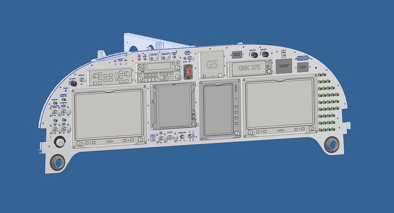

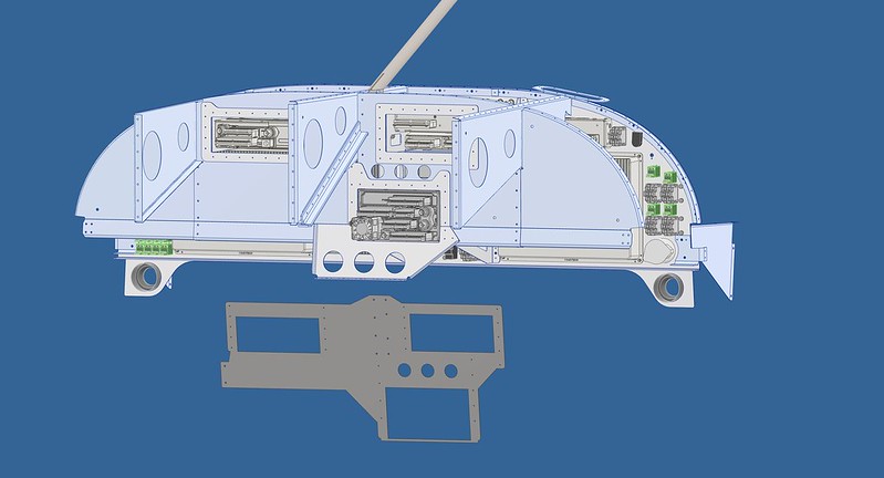

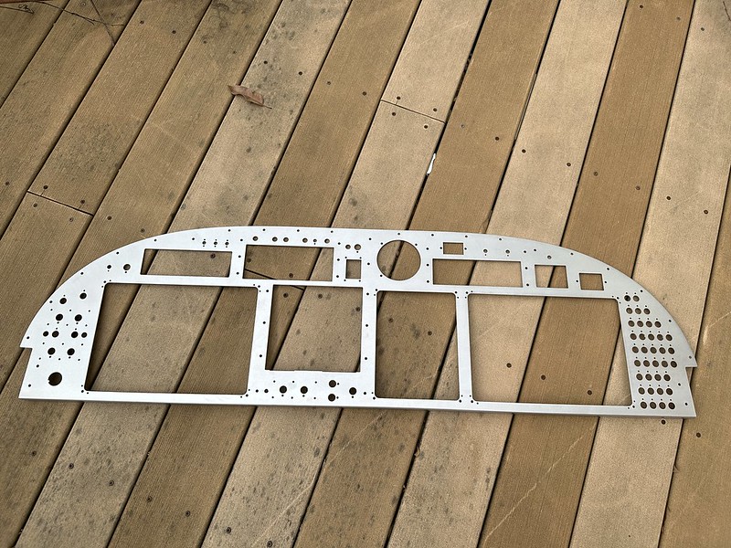

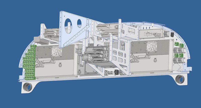

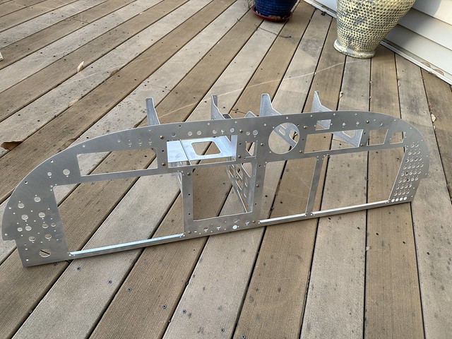

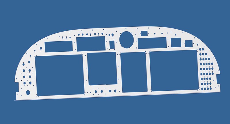

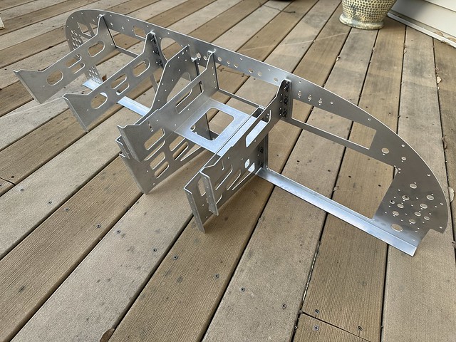

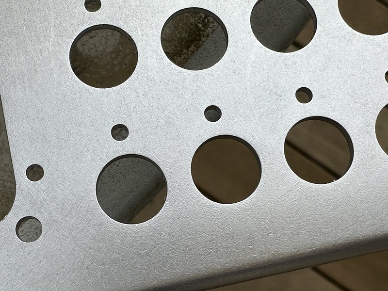

I would like to share about my experience with ordering an aluminum panel through Xometry. They have charged me around 300$ inculding a delivery fee from Mexico.
So, I just uploaded my STEP file of the panel, clicked the button Order and in 3 weeks later I received a panel. It was very easy. I really like the quality of their laser cutting and tolerance. All the holes on the panel have been designed with the tolerance +0.2 mm to the actual diameter of the switches, LEDs (every single item was measured with a caliper during engineering process... Don't TRUST the drawings provided by manufactures!!! ) And the actual diameters on the panel I received are exactly +0.3 mm
Tim,
Nice work! Any chance you are willing to share your STEP file? Would make a great starting point for those of us looking to do a G3X. It looks like you've already gone through the trouble of sourcing the individual models, etc
I'm waffling between an Aerosport panel or a traditional panel. Would be fun to experiment and move things around.
David
Files
It's not the end. I haven't even started a bottom console, where I am going to place all other switches, engine controls.... etc.
It's just the base aluminum panel. And I am also going to attach a fiber carbon overlay panel. The reason I personally don't like Aerosport's panel - they look like old Toyota's dashboard and it's not possible to fit as many instruments.
I would love to share everything I have, but I don't know how to share a 150 mB file here.... The project has been made in Autodesk Inventor 2023, so I can make a ZIP archive or export it into single STEP file
Let me try the Google drive...
https://drive.google.com/file/d/1iXm1BkdXypiLO0dJyfUC23RsLNx3Z69F/view?usp=share_link
Let me know if it doesn't work
It's just the base aluminum panel. And I am also going to use a fiber carbon overlay panel. The reason I personally don't like Aerosport's panel - they look like old Toyota dashboard and it's not possible to fit as many instruments.
Let me try google drive...
Thanks Tim! A STEP file is a fairly common format that can be imported into a number of CAD programs. Question is whether or not it will maintain object groupings etc.
Google Drive works great if you get the share settings right.

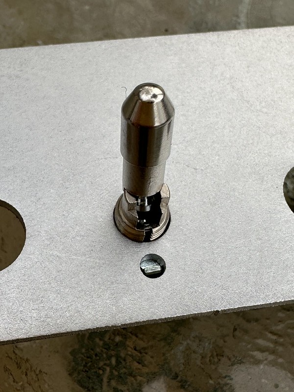

Dozer. Since you are using a laser cutting service you have the option of having them leave a tooth inside the switch and breaker holes for indexing and keeping them from moving. I even do it when there is a keyed magneto switch. So no extra switch locking holes or indexing washers are needed for the components. Attached is an example of the hole configuration I am talking about. I have these laser cut and it works out really well. I do have to do a little bit of slag clean up with a small file but it only takes a few seconds. Both methods (holes or indexing teeth) yield very professional results.
I like a hole for a washer with a pin. But if someone really need to have a tooth, make it bigger and then file it to specific size. Laser unable to do very small teeth (they are melting at the tip).
But the reason I like those extra locking holes - my panel is a sandwich (aluminum base + fiber carbon overlay). And I don't make locking holes in the carbon fiber panel.
Not the best pic but you get the idea.

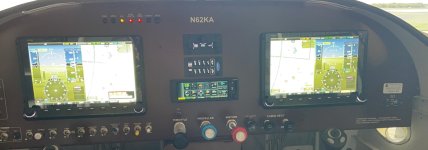

Dual Dynon HDX 1100, Dynon Comms (2), Garmin GPS 175, Garmin 340 Audio Panel. Not shown on left side...E-Mag dual electronic ignition switches.
I have no VHF nav radios. The Garmin GPS-175 gets me around in IFR. I've flown a few flights in IFR weather and have never missed that VHF Nav capability.

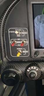

Battery and IBBS Switches
Joe,
Love the organization on your panel. Why did you choose rotary switches instead of toggles for battery and ibbs?
Bob
It has to do with total integration. I wanted engine control switches (mags, boost pump, start arm) grouped with the other engine controls (throttle, prop, mixture). The section of the console I used is near the GTN. In order to keep switches from getting in the way I chose the rotary switches. The electrical control switches followed suit for consistency. I've flown them for 600 hours now and really like them. They also help clean up modernize the look.
Joe,
Also wondering what carbon fiber material you used? I’m planning the stock because I like more open space for the legs.

Great to know some of the design decisions of the pros line up with thoughts I've had, without diligently doing the research as you have. Planning a number of things you point out.
Minimization/automation/decluttering/controls: dual g3x touch, gtn 650xi nav/com 1, remote nav/com 2, remote xpndr gtx45r, remote audio panel gma245r, gmc 507, g5. My only physical switches are bat 1, alt 1, and alt 2 masters, boost pump beside throttle, and an ACS keyed ignition switch for the emag/mag/start. Lights, cabin climate controls, and pitot heat switches are getting put on a Nextion touchscreen with page groupings, feeding ground enabled switch inputs to the VP-X, GAD27 and flyLEDs, backed up by on-PFD control of the VP-X switching, with the VP-X itself backed up by VP-X backup method B for the essentials.
Ergonomics/eye hand movements: g3x pfd and mfd are positioned side by side on the pilot side. Touchscreen, GTN and autopilot controller below those in a horizontal configuration, working to mimic the G2000. Audio panel, transponder and nav/com tuning on the PFD/MFD, autopilot on the GMC, flight plan editing on the GTN. I might give more thought towards how you've placed your mag switches very close to throttle, which has value on doing flow work on abnormal and emergency checklists.
Electrical system: Leveraging the VP-X with dual battery and dual alternator. All of the essentials can be powered by one or both of the alternators or one or both of the batteries. With our without the VP-X in the loop using backup method B that backs up the VP-X electronic circuit breakers with fuses off the batteries.
