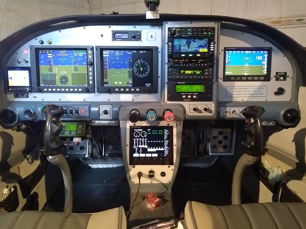

Panel lay-out
This is how a single pilot IFR/VFR panel should be laid out with the two screens in front of the pilot. It is a bad mistake IMO to place one screen on the RH side and only one screen in front of the pilot in a two screen lay-out.
I felt when I built my panel (below) that the Dynon D-100 on the right would be a good stand by EFIS should the two main screen go dark. The day this unthinkable problem happen to me I found that the screen on the far right VERY difficult to read.
As a result of this I put in the Garmin G5 just the the left of the PFD. In this location it is easy to read plus it has in own back up battery.
Looks great, only downside may be working in the tunnel will become 'challenging' with the center stack.
I shouldn?t have to work in the tunnel. I put the inspection panel on the side for inspection, but I?m putting filters in wing root. I dont want to be spilling fuel in the cabin during conditional inspections.

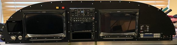

Panel is Built!
Just got this pic from Aerotronics today of my completed panel ready to be shipped! Can't wait to see it in the plane.
Can't say enough good about Andre Todd and others at Aerotronics. They have been so good to work with so far (and see no reason for that to change). Very responsive and helpful as we designed, changed and finalized everything.

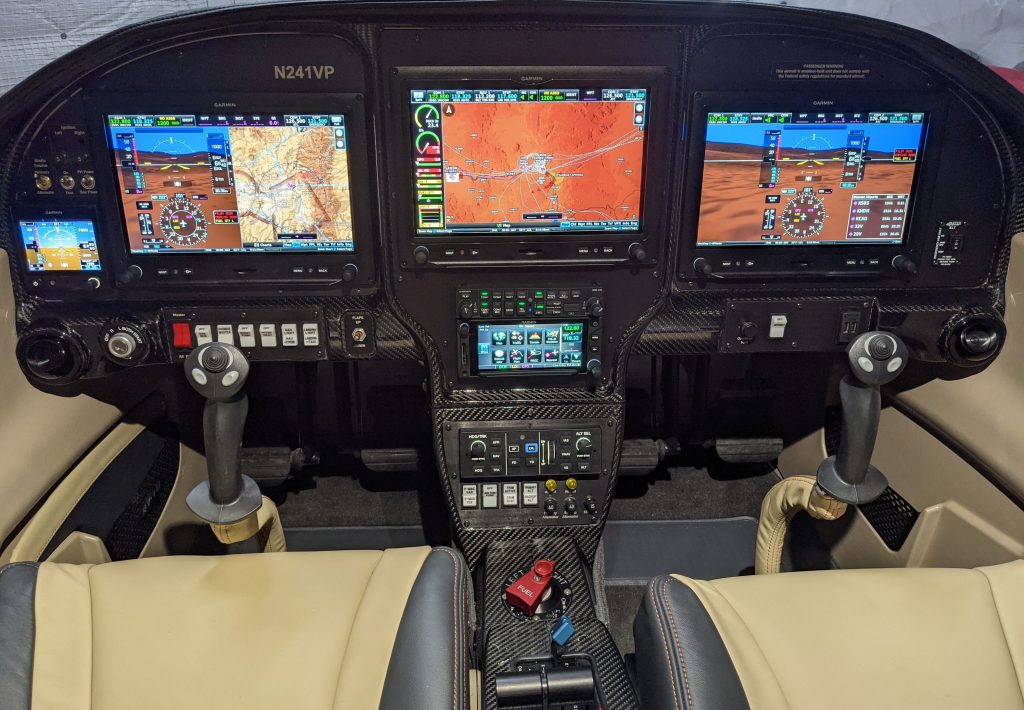

I'm really happy with the way it turned out. The insert color was chosen to coordinate with the interior colors. The Aerosport carbon fiber panel clear coated very nicely.
The folks at Stein were incredibly patient with our multiple changes and very knowledgeable. We were fortunate that the Garmin GTN750Xi was announced just as we were finalizing the design.
There was a lot of lost sleep about the electrical system architecture given the desire for redundant and independent power sources for the dual channel SDS EFII - this drove the switch layout for the panel. Ultimately, I think we achieved our goal. And yes, we have CB's for the hot battery busses plus one main bus and VPX for the other.

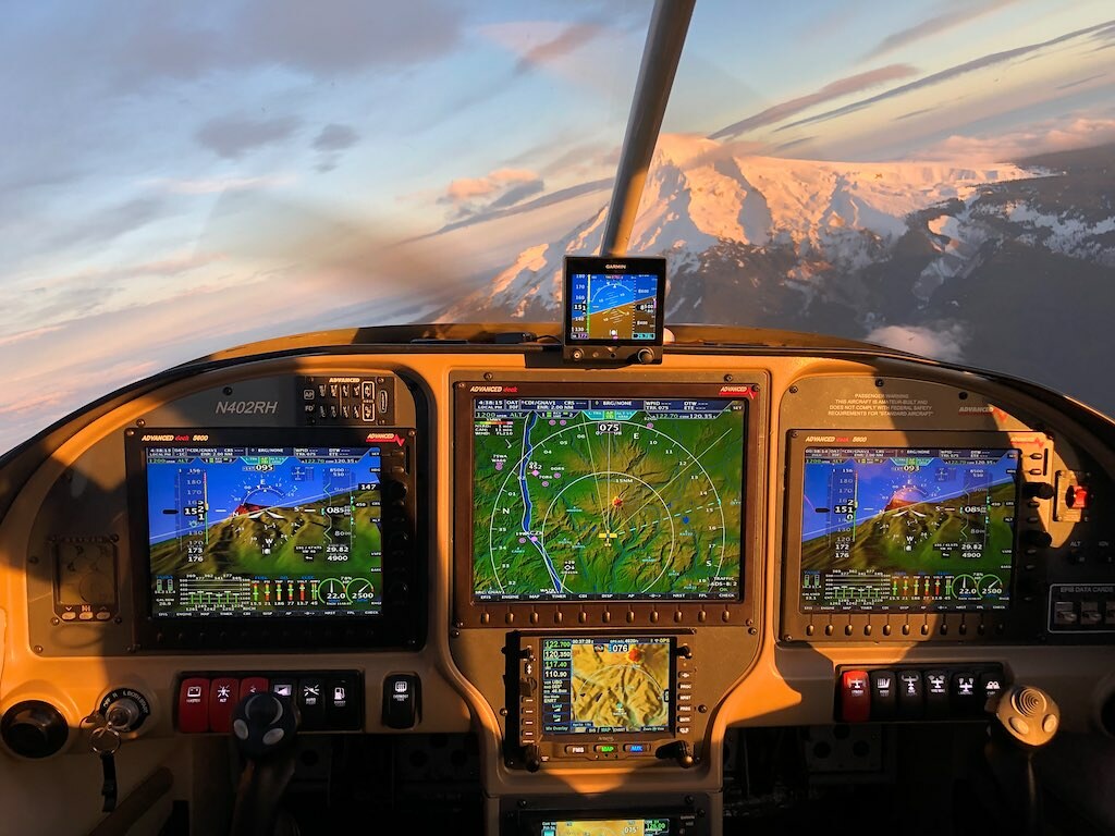

I just updated to the new Aerosport switches with graphics in my RV-10. Photo taken last night about 50 miles east of Van's during a software test flight.

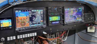

Aerotronics Cut Panel - My layout and wiring
Here's a photo of my Garmin equipped RV-10 panel. I realized in looking at today's posts of RV-14 panels that I still hadn't posted a pic of mine.
I worked with Jason and Aerotronics on the layout and then had them cut the panel. They also supplied most of the hardware for the panel (switches, Garmin avionics, breakers, etc.). Jason and his team were very easy to work with and very responsive. I highly recommend them.
I created the wiring diagrams and then built the harnesses and wired the panel. So far I have been very happy, but am still on a learning curve with all the G3X and GTN capabilities.

Very nice!
What are the things to the left and right of the 650? Hard to tell, but almost look like some sort of slide dimmer??

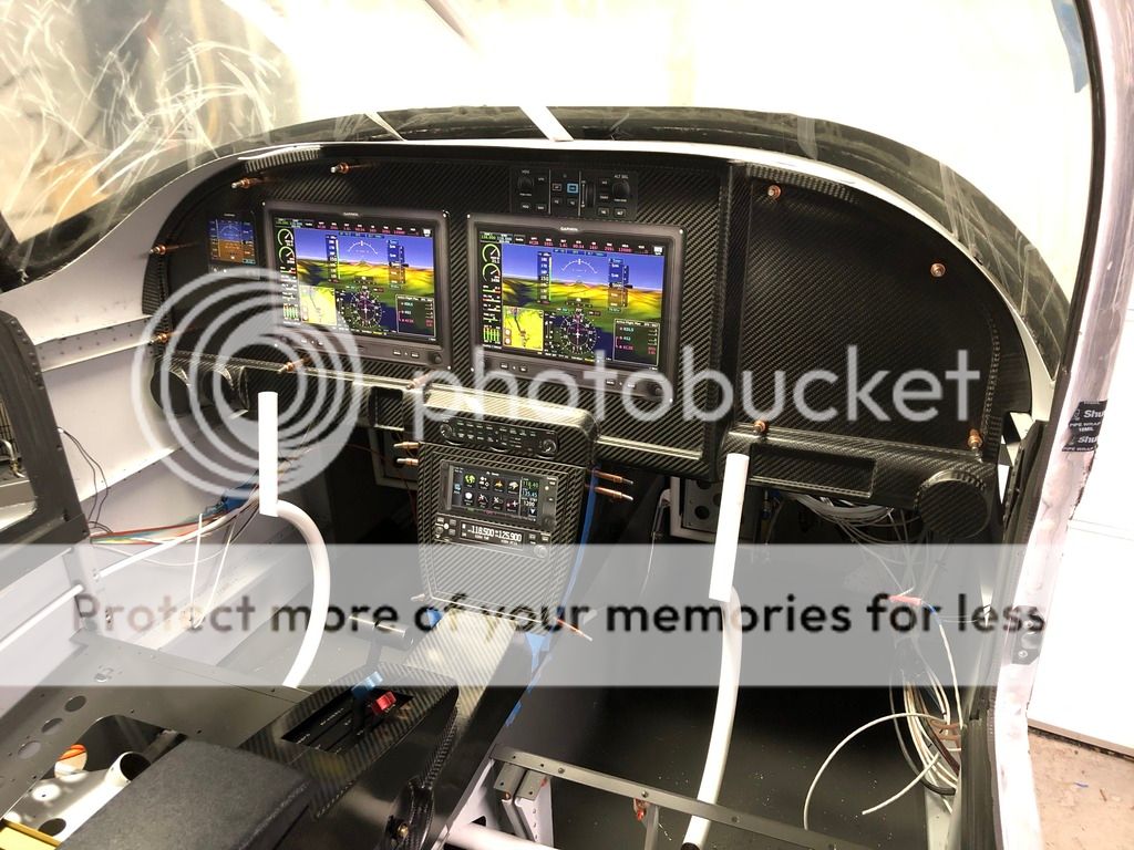

Stock Van's panel with South Florida center console. Wanted the GMC 507 centered on the upper panel so built an eyebrow panel to contain it. Did all the wiring myself....1 wire at a time. Grouped switches by system/function away from in front of the stick.

Battery and IBBS Switches
Joe,
Love the organization on your panel. Why did you choose rotary switches instead of toggles for battery and ibbs?
Bob
Joe,
Also wondering what carbon fiber material you used? I’m planning the stock because I like more open space for the legs.
Sumit

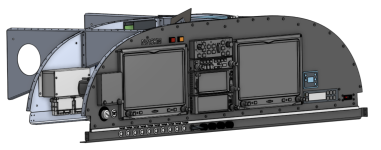

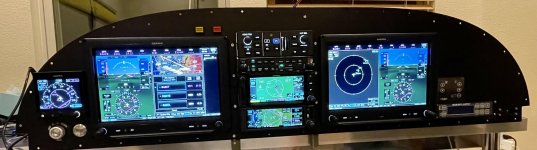

While the cockpit is not complete, the mechanical panel work is done. Everything designed in 3D and then waterjet cut and anodized. Stock panel design. The radio stack fits underneath the central rib, no cutouts needed.
All switches and dials will sit on the bar below the panel. Above the switches, a dimmable, dense micro-led-bar (360 LEDs) will backlight Dymo printed black on clear labels on milk glas covered with thin acrylic for protection.
The master caution and master warning light also has Dymo printed labels underneath the cover.
If anyone is interested in the 3D-design, I open-sourced it here on OnShape (create a free account, then clone the design):
https://cad.onshape.com/documents/5...renderMode=0&uiState=6166f10498325275f4eec3f7

Looks sweet, I may just copy this when I reach this point.

Major parts working after running some 138 wires (see https://docs.google.com/spreadsheets/d/1AqWwhWavieX5wUc94eRBboVtdiVnk19nisR-6vLuD6g/edit?usp=sharing). I have a 650 main GPS and a 375 secondary GPS with transponder. Cross fill works via the G3X system.
I built the sub-panel and center rib out of wood to be able to mount all the boxes in their designated places to get the harness right. I printed the sub-panel and rib at 1:1 scale at a Fedex Office place ($1 per square foot), then glued it to the wood panel and cut it out.

Looks great, Martin!
I'm interested in possibly cloning your panel for my RV-10. I've always planned to use the stock panel, in lieu of the Aerosport ones, to save money and "knee room." Does your G5 fit under the glare shield. It looks a little close. Also, why the backup GPS? Did you use the 3D model files to fabricate all the supports and sub-panel structure, or did you build them as you went with your wooden model (meaning only used the 3D files to watercut the panel itself)? I'm curious how much I could do with your files, without having the actual Garmin racks and avionics.
I used the std panel for the same reasons. I will shoot a pic of mine for you. No issues getting my G5 in there.
Larry
> Does the G5 fit?
Yes, it should, see CAD view. Also on my real panel, there is room towards the edge of the panel just as planned.
> Why backup GPS?
IFR redundancy. If the primary 650/750 goes out, you lose all your ILS/LOC/VOR/LPV capability at once. Plus you need a transponder and ADS-B In and Out anyway, so the GXN375 has all that built in, so add a little more money and you have a backup IFR capable GPS instead of just a transponder.
I also like that you can copy your current flight plan to the second GPS, modify it and then switch over when you are all ready instead of fiddling with the GPS that is currently driving your autopilot.
Yes, the panel was waterjet cut from stock material and my CAD file. I built the sub-panel and center rib from wood but glued a CAD printout on the wood so I could cut along the lines. I made three angle brackets to connect the center rib to the panel and to the sub panel to make it rigid. I did purchase the switch bar from Vans (some $30) so I could mount my switches before having the fuselage (QB coming in Jan).
/Martin

Which panel LED?
Almost finished.. ;)
Hi Igor,
very impressive panel. I love your panel lights. Who is producing them?
I know you are installing AT-1 for traffic awareness. But which transponder device are using then?
Alex
