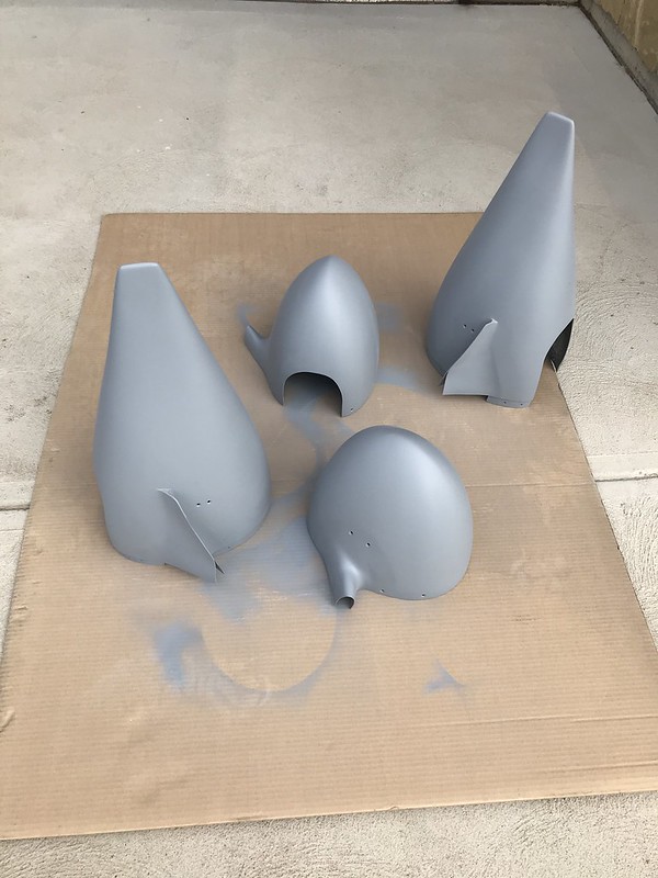

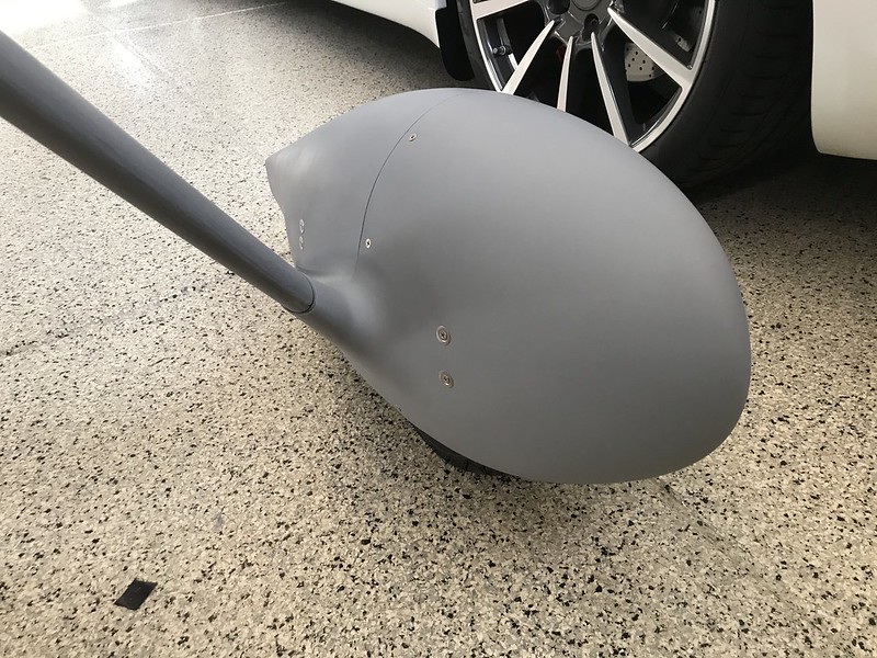

Fun with wheel pants and intersection fairings... there's more work there than at first blush. First coat of epoxy primer:
First coat of primer... by Dave Hock, on Flickr
Standard Van's pants with RV Bits (https://www.rvbits.com/) intersection fairings, very nice quality. I will say fitting the wheel pants, leg fairings and intersection fairing is a lot of work, more than I expected. Required a lot of aligning, measuring, cutting, glassing, filling, sanding filling, etc... I figured while I wait and wait for my FW FWD kit (next week I'm told) from Van's and my Thunderbolt engine (this month) I would get these done. I didn't want to leave all the fiberglass to end in any case. If you want to see my progress click on my Flickr page and step back.

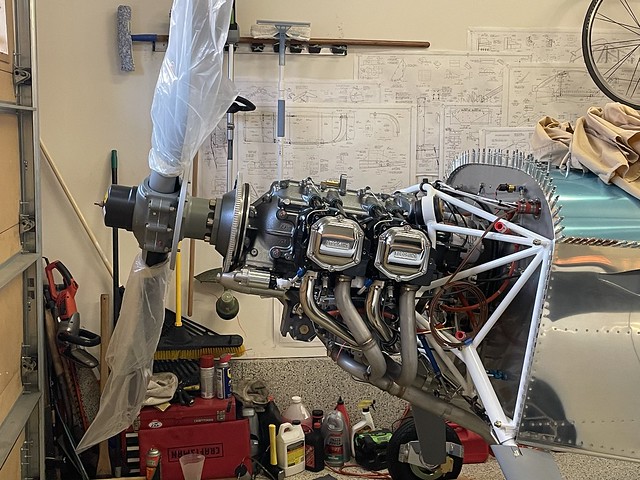

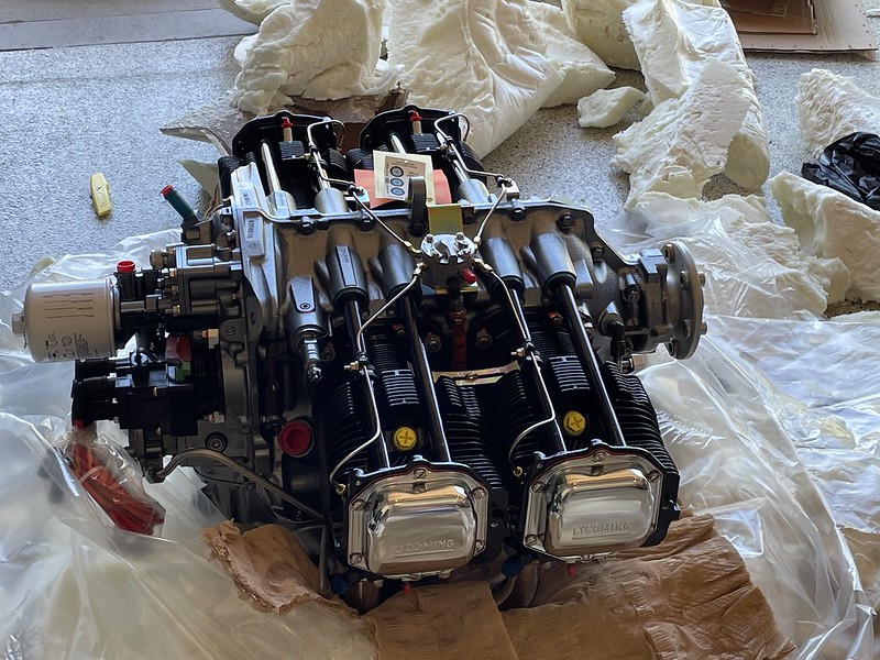

Engine Mounted
Not anywhere near as bad as I thought it would be. By myself. I've swapped a few engines in cars so I applied a few tricks.
Nice job Larry... looks like a M1B with dual PMags, same as mine. I'm hoping to have my engine by EOM.
I'm trying to decide where to put my two SS pass throughs for wiring. I'm building a slider and thinking that outside forward 3 ribs is the place to go centered in that bay. Thinking all the engine stuff (CHT, EGT, FF, etc) on the left (pilot) side and then higher voltage on the right.
Passthru
Yes. IO360M1B with dual P-mags.
Passthrus are pretty much what you are planning. One each side. One high, one low voltage. Note locations for control cables. Especially the throttle cable on the new A model mount. It goes through the recess. Keep the area above the mount clear so the battery will go in. I'm hoping mine goes in. It's really tight behind the engine.

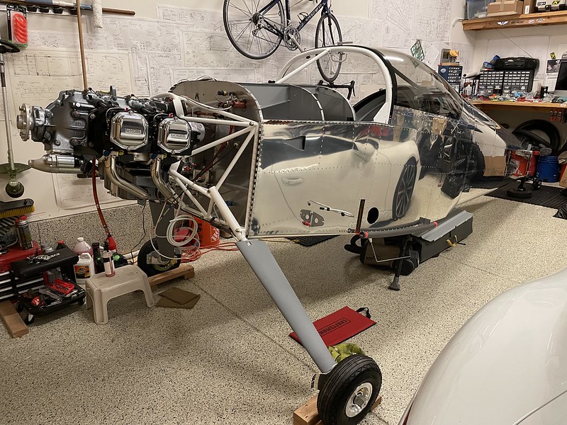

Milestone: Engine On!
So easy an accountant can do it!
Seriously, hanging the engine wasn't too bad thanks to help from my boys, good Van's instructions, Youtube videos, and information from VAF provided by "those who've gone before". Thanks All!
btw...I recognize my professional limitations, so my regular A&P/IA will be by in the morning for a look over.
yep yep...I'm a bean counter by day with an "odd" plane-building hobby by nights & weekends!

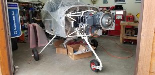

On the gear and the engine hung...
I'm really excited about pushing forward.

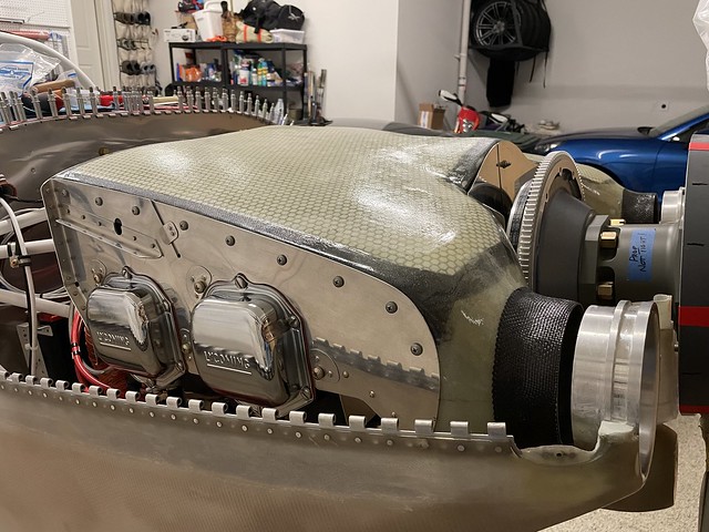

After fighting with designing a mold (and tweaking it) and fabricating my custom plenum to fit my James cowl for over a month it's finally at state I will call done for now other than a slight trimming of the intakes. I will end up with some sort of very thin gasket on the edges and still need to go around the engine seal with RTV or similar to close all the small gaps between baffles and engine. Tip, if you can buy a plenum do it (I could not), making your own is a ton of work and still pretty darn expensive.
Details: I have 2 layers of 8oz FG on top of a Soric layer and then on the inside a layer of carbon fiber ($) for the body of the plenum. The intakes are multiple layers FG and then a ring of CF on the intakes. I used Fiberglast high temp industrial epoxy as I was concerned about heat soak on shut done. Nut plates are riveted to the inside with SS screws and fiber washer, holes in baffles are slightly oversize to allow some give with temp and engine vibrations. The plenum is pretty light 2-3lbs and very stiff.
I hope it works for me.
https://flic.kr/p/2mANGry
Plenum
Beautiful work Dave.
Please keep posting. I'm following because I have an RV Bits plenum to install. Looking forward to seeing how you join the ducts to the inlets.
Thanks! I have some neoprene (wet suit material) I will use, tough and very flexible, this is what James recommends. A buddy has used neoprene on his "7" with a James cowl with good results. I was considering using SCAT but too ridged given the short span and sizing didn't work well.
