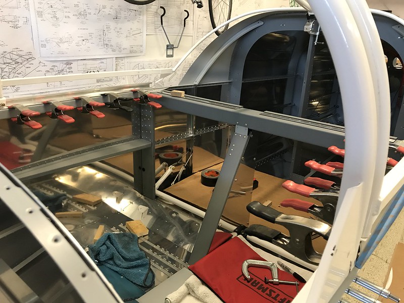

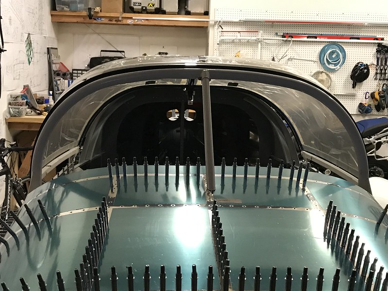

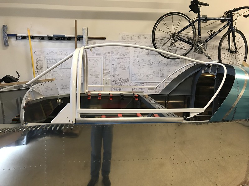

Now for the canopy

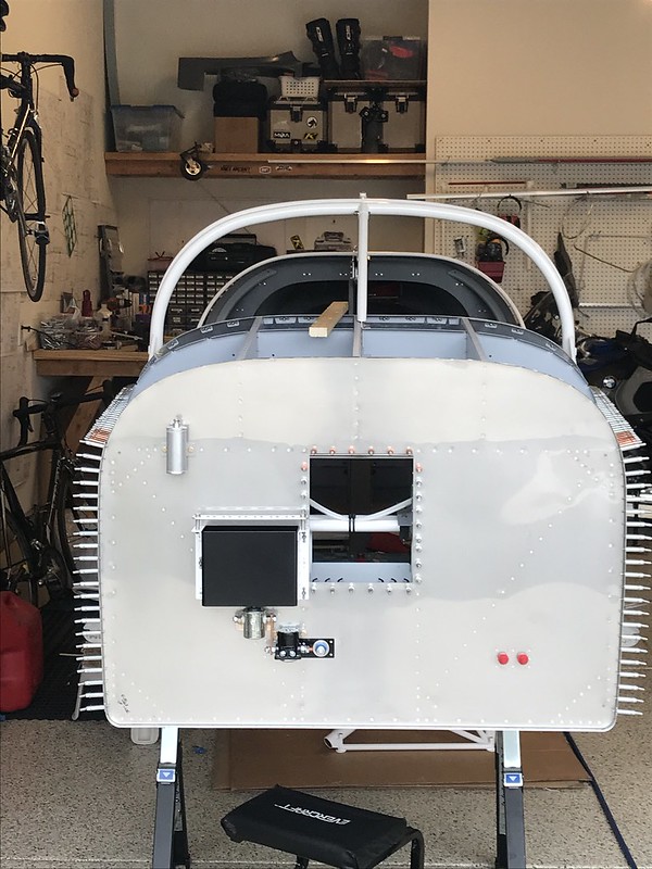

I've avoided the canopy as long as I can, the fuselage is built up as far as I can so it's time to dive in.... Spent quite a few hours on the the initial tweaking of the canopy frame, getting close but probably need a few more hours of bending to get it to fit the canopy bow. This feels a lot more art than engineering as you don't know what happens to your fit until the canopy is on.
Head on:
Head on view of canopy frame, getting closer by Dave Hock, on Flickr
Side:
Gap on left side still a little "looser" than right side by Dave Hock, on Flickr
Spring clamps:
Untitled by Dave Hock, on Flickr
That was after 6-7 hours of looking, bending, swearing and then just saying ----it and cutting. I am following your write up on the Sika process and after reading many articles planning a little bit of hybrid. My plan is to bond to the "hoops" and center then screws along the bottom edge and bond the aft skirts to the plexi... at least that's what I thinking now. I need to leave the forward skin off until I do my avionics and wiring over the winter but wanted the canopy done now before it gets cold in the garage (I'm in CO also).

That was after 6-7 hours of looking, bending, swearing and then just say ----it and cutting. I am following your write up on the Sika process and after reading many articles planning a little bit of hybrid. My plan is to bond to the "hoops" and center then screws along the bottom edge and bond the aft skirts to the plexi... at least that's what I thinking now. I need to leave the forward skin off until I do my avionics and wiring over the winter but wanted the canopy done now before it gets cold in the garage (I'm in CO also).
You're choice but I would Sika the whole thing. You're were a member of our Google Group, Colorado RVs. For some reason, I don't see you in the list. If you would like back in, shoot me an e-mail (see signature below).
That's what I did, though I sealed the canopy skirts with Sika. Expect the canopy to spread the frame a bit (which you likely already know). I had straps pulling mine together by about an inch (from fit) and it still sprung beyond the previous fit.

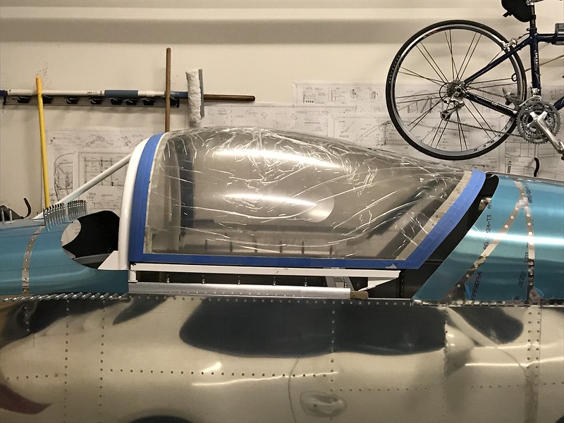

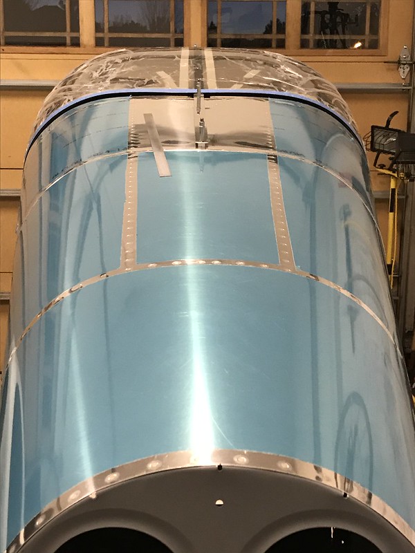

Canopy is bonded!
Boy I think I spent more time thinking and sweating about this than
the actual job. Some great tips from Larry aka wirejock on his process,
THANKS Larry! Some pictures of the initial fit tonight. I went onto
the roller tracks with zero friction, I think my canopy expanded the f
rame less than a 1/4", I was concerned but in the end worked out well.
I might do a few thing different if I did it again but overall it worked.
For me I will rivet and screw the side skirts and Sika bond the aft
skirts and attempt to do it with the aluminum. Whew, on to the next job.
Canopy
Looks good Dave! By the way, I pulled some of the plastic protective film and the plexi looks pristine underneath. I think I'll leave it on a bit longer.

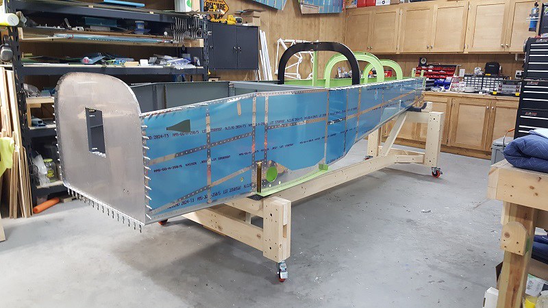

January this year I started with digging out the longerons and got them bent. Mated up the aft and center sections. Got all the skins on and built the forward section. Then all the disassemble, prep, prime and paint. Put it all back together and lots of riveting.

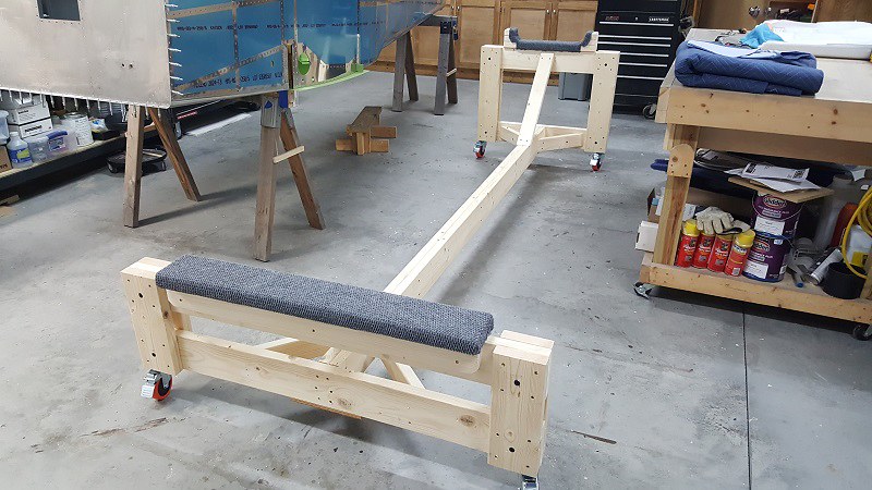

Finished up today and got my fuse dolly made. And flipped my canoe!!
