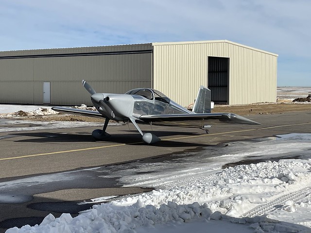

25 hours in Phase 1 and still grinning! Flying great with no trim required after wheel pants and leg fairings:
Untitled by Dave Hock, on Flickr
Looking pretty :-) it's been cold in CO. Was not expected much heat from the standard heat muff and happy to report that it puts out a TON of heat. I've been flying with it just cracked a small amount with a very pleasant cockpit with the OAT's below freezing.
