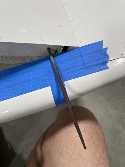

My highly skilled partner drilled a 3/8 inch hole through two end caps with foam in between and we had 8 rivets with no cracks. One scratch on the front of the spar, but that was it. Took about 1 hour for both sides. We didn't have any holes on the end.

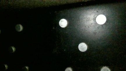

No cracks observed.

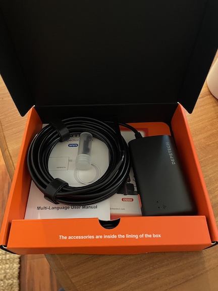

Found a very small diameter (5mm) borescope with a side looking camera that fit thru existing tooling hole after a bit of filing:
Depstech DS500. This inexpensive borescope will be a nice addition for regular visual tail inspections. More convenient and smaller diameter than my regular articulated scope.

Note: Drilled 1/4" hole 5" in front of rear spar, centered vertically for bore scope
