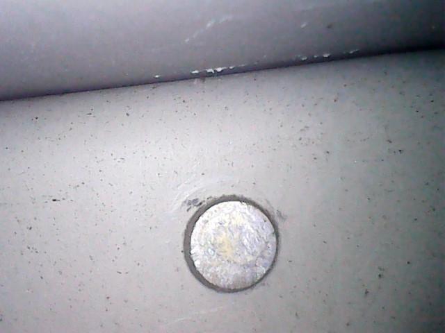

After scoping my rv 6 it appeared to have a crack running from one of the bracket rivets. I had many eyes on it and all agreed it was a crack. So I removed the skin and the hinge bracket only to find that it was just dirt. It was strange that it was a straight line, but with the skin off it is easy to tell that it wasn’t a crack. Maybe should have tried some brake clean or something like that to clean it up and verify that it was a crack before repairing. Never thought of it because everyone agreed it was a crack. I’m going to install the repair it anyways. Anyone else run into something similar?
Mine looked similar (except it didnt emanate from the rivet), but after wiping clean and flying it another 5 hours the black line re-appeared in same spot. Sure looks like a crack and probably cant be definitive without doing dye penetrant test
Yes I did. I saw something like metal or may be a hair so scratched the area and the spar looks ok.
