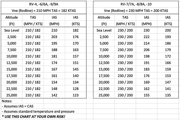

There's more margin in the RV9, The VNE for the RV9 is 210mph TAS and the RV7 is 230mph TAS. Thanks for catching that Carl.
For those with steam gages, and those with EFIS' that have not set Vne in terms of TAS.
Does this chart factor in the standard decline in temperature with altitude?
Yes, it does take the temperature lapse rate into account. It's based on the 1962, 1966, or 1976 U.S. Standard Atmosphere (I forget which one, but they are all similar, if not the same, for the altitudes in the charts above).
Please feel free to spot check a few of the numbers.
Steam Gage IAS if rudder has narrow Vne margin for error
Thanks for the reminder Carl, I was aware of this but was previously less concerned with it, until this thread & learning of the possible -9 rudder's narrow margin for error with respect to -7's Vne. I suppose if I do decide to keep my -9 rudder on my -7 then probably should consider having an EFIS -and with a good audible alert.
