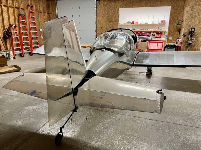

Can someone post or send me the small rudder/ -8 drawing and manual page for building one? I thought I had it already but cannot for the life of me figure out where it is. I can probably figure it out just from the drawing but wouldn't mind the manual section too if possible. Thanks!
Finally think I have time to build one.
Attached are the RV-8 rudder drawing and the assembly manual section.
