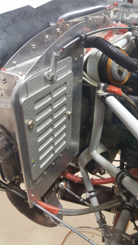

I just installed the AntiSplat oil cooler shutter last month and ran into a couple of issues. I'm not sure if the baffle kits that Vans provides have changed over the years but I got my IO360 baffle kit in 2014. Here's a few pictures and description of the issues I ran into to while installing this on my Mattituck powered RV8.
The cooler bolt centerline does not match up with the shutter door centerline on each side. It actually measures 3 13/16" and I was able to center it and drill the holes with no effect on the shutter operation. Doesn't leave a whole lot of room for error though.
pfB7pJJLeYrM54tPYQ_jlzUZjdnDv5-q-r-CLCl-u1K6BDuUZNXRMCp9TziGwO2ZNqDp10pgAb3KsonSOLhRaAscPfz0C8Ub96PdjqfASvkhiAqyqAA5eo3Zruu0N8mlF5Wi4PcD4c4=w2400
In order for the actuator arm to move freely, I had to grind down a small portion of the upper cooler fins and braces. The oil cooler is the standard one provided by Vans (Niagra cooler I believe).
aYApgodVycwQixad3u1lWYAC_Xdq4jh5XzYJ5tivFQTJS7J4Vb6tj56K-4yJDRKlH87W3OHlpcAd2_FI1fuZSnpoV3tuOraxtDvSozC6s7TXczFRu2eodz-KBnrMTT4Lio9SqFPa15w=w2400
The baffle upper and lower edges come from Vans with a preformed curved section. I had to squeeze these flat so that the shutter door would lay flush and flat against the baffle.
jKEwVzFuDkCNpaHv1q6JFdReCn2gbR5LMIzBmn4-DPmULJVzssrcwWJbLiuO_2lGLGmhiVHaE5QjR0LBcVb6HN_Ij1m8lDgwb9-NnUejwklQMhPS96q0W4FLUQdIK6HcBX2Fj3ILMMo=w2400
The top right bolt which was an AN3-4A had to be replaced with an AN3-5A to accommodate the thickness of the shutter. The bottom right bolt originally had a spacer installed under the bolt head per plans that had to be removed for the same reasons. The spacer was there to stop it from contacting the cylinder fins.
nRTNdXXvgi3Kl7a6RBEVN9t6rqXG7NdlMWVrE4jGUwtlpjkt8l6_rU3AVaR1IcKG9DYjARZmfXHclxKKpmBvLffF4SAshdwx4M3P6YnKBbr8jlY7KSbZH5kgocta_68VSbCAo_0D2tk=w2400

I've flown with it installed on my RV8 for a few weeks now and it works great. I'm finally able to regulate the oil temperature and get it consistently above 180 degrees for the first time. Before this, the cooling was so efficient that 170 degrees was about the best I could do even in the heat of the TN summer.

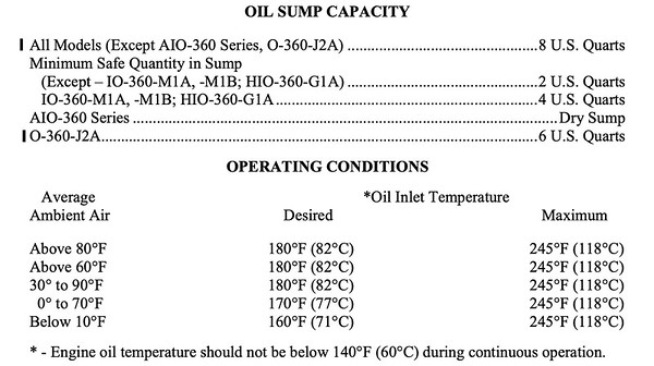

Note that per the Lycoming Operator's Manual for the O-360 Series, 180?F is the desired oil temp. So that is a fine temp to shoot for.
On many days in the Winter I can't get to 180?F with the cooler fully blocked off. But I can usually get above 165?F, well above the Min temp of 140?F per Lycoming.
I'm sure there are many opinions on oil temps. I was in the 180F camp as the target, but the mechanic that I've grown to trust said he really likes to see 200-210F to burn off condensation. Paul McBride seemed to agree that 185-210 in cruise was ideal, so now I target 200F and with the help of my shutter, can get there on any day above 25-30F OAT. I don't have any hard data, but my engine seem to run a bit more efficiently at 200F vs 180F.
https://generalaviationnews.com/2011/02/09/ask-paul-whats-up-with-my-oil-temperature/
