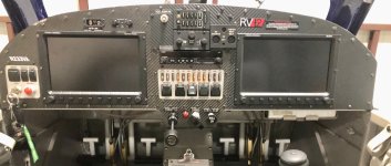

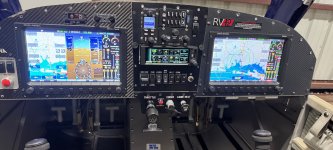

I've been wanting an IFR GPS navigator since I bought my classic RV-12 three years ago. As it turns out it was a much bigger job than I thought at first blush. The problem is that there just isn't much avionics panel space in a classic RV-12. That meant moving some stuff around. First, here is the panel I started with...
To make space for the GPS it was clear the SL-40 radio had to go. The Garmin GNC 355 with both GPS and Comm would have been a terrific choice here. Terrific except it is about 1/2" too long to fit in my panel. So that meant using the much shorter GPS 175 and a separate radio. The separate radio I selected was the remote mounted Dynon radio.
With the SL-40 removed there still isn't enough panel space for the GPS 175 so that meant getting rid of the fuse / switch module. I replaced the fuses with a VP-X ECB to free up that space. With the VP-X I can use any switch I want but it isn't an RV-12 unless it has the Otto K1 / K2 rocker switches so that is what I stuck with. I did replace the trim rocker switch with the equivalent K2 paddle switch. I like the paddle switch a whole lot more than the rocker switch for trim. The fuse / switch module also included a current sensing shunt (using a PCB trace, which I don't care for) and a large filter capacitor, both of which also needed to be installed. I also had to provide for an overall 30 amp circuit breaker for alternator output. I was happy to get rid of that troublesome 30 amp car fuse.
With those things done there is plenty of room for the GPS 175.
I had the replacement panels made by Front Panel Express. They did the cutting and the engraving. I was pleased with how they turned out. Vans doesn't provide a CAD version of their RV-12 panel so the shape and hole locations were all from measurements. I triple checked my measurements and the hole locations were pretty much spot on.
Things are getting a little crowded under the hood but not too bad. The wiring I inherited when I bought this plane was a rat's nest. Believe it or not what you see here is a big improvement.
So far I like this setup a lot. The Dynon radio is a big improvement over the old SL-40. The efficacy of the VP-X is controversial here but I personally like it a lot. The GPS 175 integrates nicely with the Dynon avionics. For me entering flight plan info is easier on the GPS 175 than on the Dynon display.
Still to be done are some redundancy items like backup AHRS and/or backup AI. I have already installed a second Dynon backup battery for the right hand display. Even though the GPS 175 doesn't draw much power, the remaining power available is limited. I've got a few ideas for a heated pitot that may get me there without adding an extra alternator. The VP-X gives me great insight into my power budget. Now I need to get a full IFR pitot / static system check, get an ICC, and go play (lightly) in the NAS.

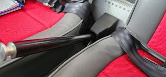

I managed to get my lap belt wrapped around the flap handle locking area a couple of times, preventing deployment of the flaps. I came up with a 3D printed cover to fix that problem. Attaches to the F-1228 Seat Floor Cover with a couple of screws into nut plates. Print file is available at: https://www.printables.com/model/1697954-rv12-flap-handle-cover
View attachment 115873View attachment 115874
Thank you 12viator. 🙏
Your clever design works a treat! 👏 I used velcro to easily attach it to the carpet flooring.
