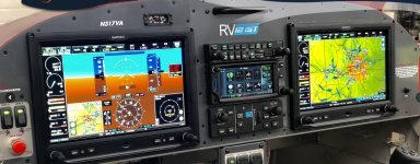

I'm about to begin building an RV-12Is-T equivalent, Dual G3XT's, Basically an IFR trainer with all options in the panel.
I have been spoiled having dual com radios and I wanted to add a second com to this airplane. Both Van's and Stein Air refused to help out stating it is not part of the approved package... Understood. It can't be added until after Certification.
The G3XT is fully capable of controlling a com 2. I am wondering if a second com would exceed the electrical capacity of the 912is Sport... Especially with all of the electrical options offered by Van's installed on the airplane?
Has anyone put in a second com after getting their 12 certified?
Thanks for the info.
I'm thinking about the Garmin GTR 20 REMOTE COMM, there's not a lot of panel space left!

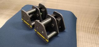

I was playing around with the 3D printer and made nut covers for the canopy bolts, kinda cleans it up a bit. I have a hex hole to accept the nut and they fit tight but still might use a dab of RTV. I'm still working on the print parameters. It will take 56 to do all the visible screws, weight gain 1/2 ounce.
Nice finish to the interior canopy. Thanks for taking the time to do this
Also on the IMC post what park brake system did you install? Matco part/s number please. Thanks
Nice
Did you share the file on ThingyVerse? Our public library here has a 3D printer. I can email a file and a form and they'll run what I send them. Then I get an email when my order is ready. They charge $0.10 per gram to cover materials.
We also have a Glow Forge laser engraver at the library, and while I wouldn't cut and structural parts, it is great for the required placards. Nice, sharp, fine print...
And they have sets of GoPro cameras to check out with an array of mounts, a commercial sewing machine, and a Brother embroidery machine amongst other cool technology stuff. Remember all those home VHS tapes of the kids at soccer and band? Transpose them onto DVD at your home.

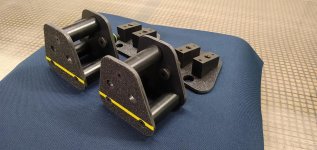

I finished the design and have shared the process and files at my blog at https://waltsrv12.com in the "Fun Stuff" tab Canopy Nut Covers.

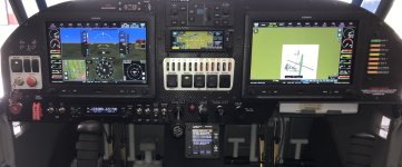

Added G5 with backup battery as a tertiary backup attitude indicator (primary, look out the window, secondary G3X, tertiary G5). Plumbed into pitot static system, so also provides secondary airspeed and VSI.
Completed painting
Nice but You could have kept the handle.

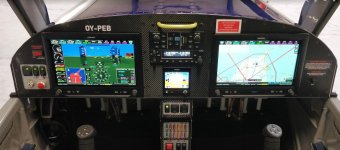

My panel:
