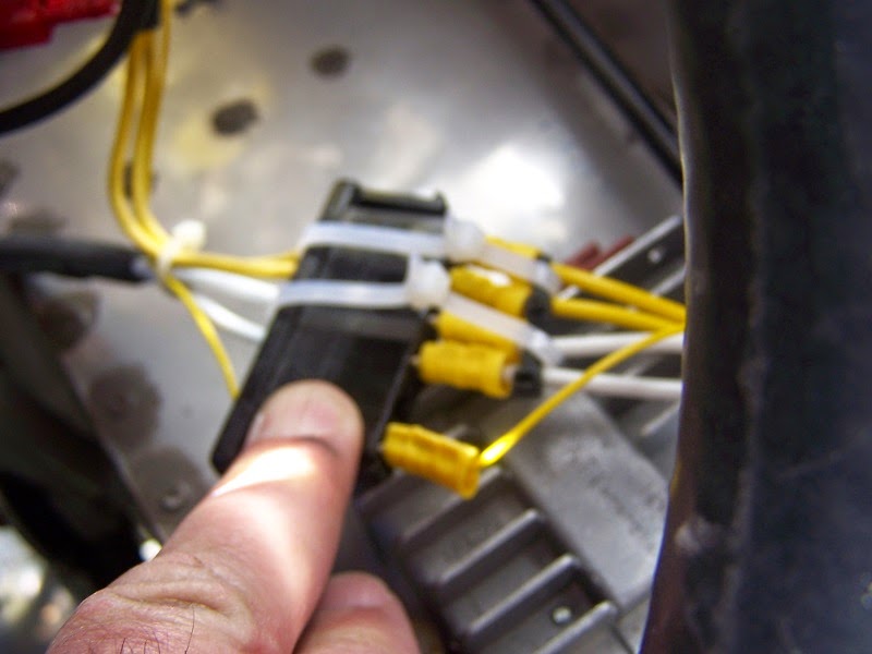

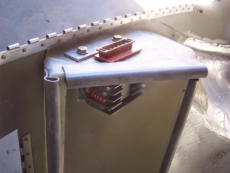

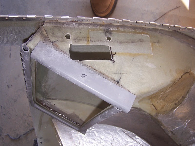

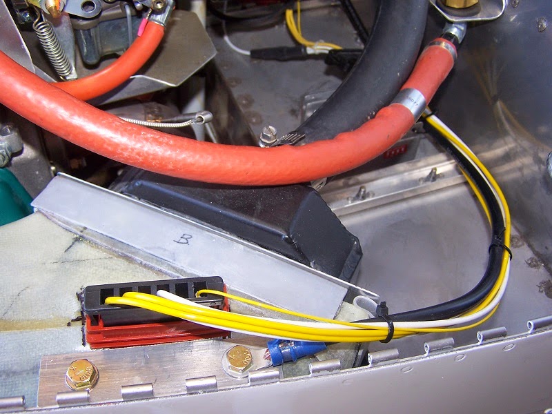

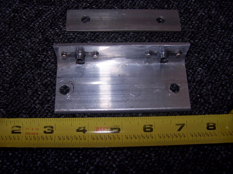

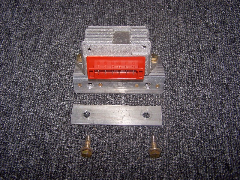

Update on the effectiveness of the relocation of the Ducatti Regulator.
My relocated regulator has now 150 hours and going. The previous one failed at 100 hours on Hobbs.
After many failures of the Ducatti Voltage Rectifier/Regulator due to overheating VANS decided to relocate it inside the cockpit to improve the cooling. I decided that a better option was to relocate it inside the cooling tunnel. Here are in a few pictures the steps I took to achieve the relocation:
The components I used, an Al angle 2X2 1/8" thick with one side cut to 1"wide and a counterplate also 1" wide:
Cuts in the fiberglass of the tunnel:
Regulator secured on the angle:
Regulator installed inside the lower cowl's tunnel:
Lower Cowl in place with Regulator connected including a ground cable:

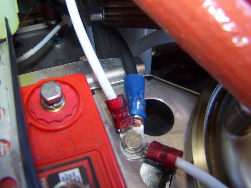

The ground cable goes to the battery housing:
As I decided to leave the initial connector untouched, I connected the extension I made to reach the tunnel with spade connectors but I had to secure the spade connectors with tie-wraps or risk a damaging disconnection of the alternator. On the picture you can see the stand-by Regulator located at the initial location on the firewall. In case of failure of the active located in the tunnel this standby unit can be switched into active by disconnecting the failed unit and reconnecting the standby.

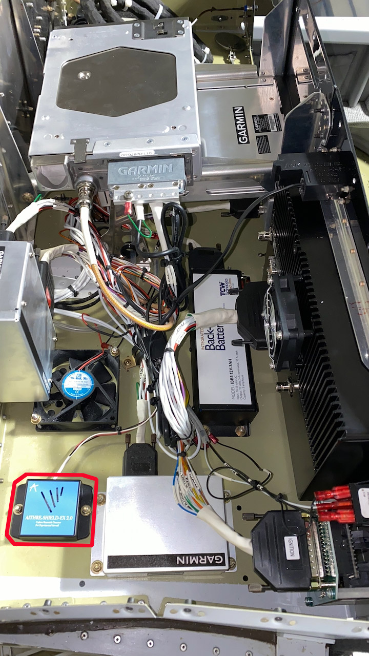

CO detector
Just installed a new Aithre Shield EX 2.0 Behind-the-Panel Carbon Monoxide Detector. Works great and looks great easy install. Integrates into the G3X touch via the GEA-24 50 or 37 Sub-D connector.

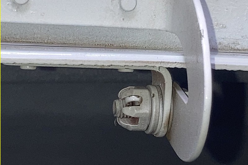

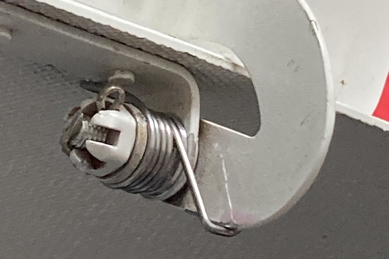

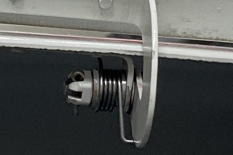

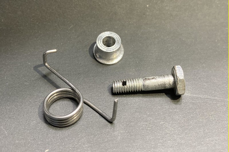

Oil Door opening spring mod
I normally leave my oil door open for cooling, one day the wind blew it closed and I missed that it was not latched on the preflight. Just as I was lifting off the door started flapping, I had enough runway left and landed so no harm was done but it made me think.
I have added a spring to the door to hold it open. The pictures are self-explanatory. I wound the spring 4 coils out of .045 music wire. The spool is aluminum and I used a longer bolt to put it all together.
The stock right side hinge.
Parts to do the mod, the spring and sleeve I made.
finished with spring in place.

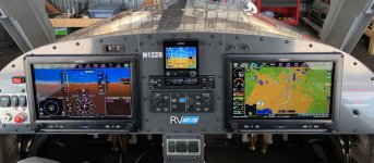

Added Garmin GPS 175 Navigator, Dynon D3 and several other items to panel
I completed some additions to my panel, primarily to provide GPS/IFR navigation capability. Not for "hard" IFR by any means, but to allow me to maintain currency and the ability to get out of places when ceilings are too low. Took opportunity to add a few more items at the same time. Summary video link, and photos below.
https://youtu.be/kpUzCfVtjW4
1. Relocated DYNON AP/Knobs panel to lower right panel to make room for GARMIN GPS 175 top center. Powered GARMIN unit by tapping into power plug circuit (wanted to use different fuse than the one for the Dynon GPS for redundancy) Simply mounted DYNON D3 battery powered backup attitude indicator beside the GARMIN unit on right side for redundancy. Passengers now have more to look at too.
Installed DYNON ARINC on top of glove compartment box inside avionics bay as this is needed to connect GARMIN unit to Skyview. Had SteinAir create wire harnesses which worked seamlessly.
2. Installed "go around" button for GARMIN added below AP disconnect. (will add placard)
3. Expanded plate and mounted GPS antenna to existing shelf in engine compartment for GARMIN WAAS antenna. Was concerned about proximity/possibly interference to existing DYNON 2020 antenna but initial testing OK.
4. Added RAM mount using doubler to bottom left avionics shelf for iPad
5. Added switch for power to facet fuel pump on upper left, above ignition switches. Read all the back and forth on it already in the forums. Wanted ability to turn off mechanical pump on ground when loading s/w without pulling fuse.
6. Added additional USB power plug on lower right side of panel for passenger and also to recharge DYNON D3 as needed.
Nice! I've considered similar. Is there any concern about 'power budget' with the 912ULS? Or any concerns on voltage regulator after install?
I'm interested in the mod for 2 reasons:
  1. Training to get my Instrument Rating
  2. Ability to do VERY light IFR
[/LIST]
Power draw was a question for me too. Of the various Garmin navigators this one takes the least. The units with nav/com, FIS-B etc... capabilities clearly draw more. Trying to find reference but I understand the 175 takes about 2 amps, install calls for a 5 amp fuse, which is what the power plug circuit I tapped into has already. Limited testing to date, but it operated fine with two different USB chargers simultaneously connected, one for an iPad and the other on the Dynon D3. I will not plan to operate it that way but was curious. Impact on regulator to be monitored.
