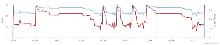

Like Matt showed earlier, I too noticed that the FP varies with the MP.
Then it got me thinking, as Dan says, why??

Does the pressure in the rail stay more or less the same at high or low power??
Is the varying FP shown on our instruments due to the physical placement of that fuel pressure line to the sensor when the regulator is moving more or less fuel to the return line??
At 29,5 MP = 34,6 PSI FP
At 6,1 MP = 23,5 PSI FP

Note "vary with MP" and "vary between one or two pumps" are different questions.
That's the theory. To understand your numbers, convert MP to PSI.
29.5"hg is 14.5 psi
6.1" hg is 3 psi
Now you have
34.6 - 14.5 = 20.1
23.5 - 3 = 20.5
29.5"hg is 14.5 psi
6.1" hg is 3 psi
Now you have
34.6 - 14.5 = 20.1
23.5 - 3 = 20.5
Thanks Dan,
Yes, I get that they are 2 different situations, 2 pumps vs. 1 pump = different FP. As in the OP's initial question, 1 or 2 pumps on takeoff.
VS. my observation/question relating to the fuel pressure (measured from the regulator) varying along with MP.
Instinctively, my first thought would be that the FP (in the fuel rail) stays closer to a fixed value throughout the flight independant of the throttle's position. But I (or most of us?) don't have a FP sensor on the rail or spider.
I'd like to understand how both relate.
Substracting the manifold air pressure from the fuel pressure?
FP (34,6 psi) at WOT on takeoff (14,5 psi) = a delta of 20,1 (high RPM)
FP (23,5 psi at closed throttle (3 psi) = a delta of 20,5 (low RPM)
Very close numbers, ok is there a reason or is it a coincidence?
Does high or low RPM influence the data as the FF changes? Will have to check that on another flight: same MP, varying RPM vs FP...
Additional data according to my graph:
FP (32,9 psi) at cruise MP of 22,3 inHg (10,9 psi) = a delta of 22 (med RPM)
FP (29,1 psi) reducing speed on downwind MP 16,6 inHg (8,2 psi) = 20,9 (high RPM)
Again, pretty close...
Why? Because the sensor is connected to the regulator and...???
Thanks for any explanation, understanding the why is bliss !!
So one of the basics for most EFI systems is that fuel pressure is ideally maintained at a constant differential over MAP. You'll see that FP drops at idle by about 10 psi from static (engine not running). This is in response to only seeing about 10 inches MAP vs. 30 inches with engine off or at WOT at sea level.
On a boosted engine, FP will rise proportionally too as MAP rises above 30 inches so that there is always 45 psi effective differential across the injector.
About 2 inches hg = 1 psi for rough calcs.
As I stated before, flow varies as the square root of the pressure increase. So if you double pressure, you get about 1.41 X the flow. This excludes the dynamic changes in injector characteristics (opening and closing rates). That's another subject, but within the usual range of most EFI injectors (roughly 30-60 psi), things remain fairly predictable.
While I was writing my last post, Ross put this out, thanks.
OK, so constant delta between FP and MP is a good thing. Why?
Is it an easy explanation?
How is it done, with the regulator being connected to the MP??

If I’m understanding your question, yes, the FP regulator has a MP vacuum line connected to it…that’s the only way it can “regulate” the fuel pressure. The engine produces more vacuum when idling and the vacuum decreases as the RPM’s increase. So, with the engine idling and not needing much fuel, the FP regulator is open, which allows most of the fuel to be returned. Then, as the engine increases in RPM’s, it produces less and less vacuum which in turn allows the regulator to close more and more so that less fuel is allowed to pass through it and more fuel is supplied to the engine. So MP controls the regulator and is a direct relation to the amount of fuel the engine needs.
Regarding placement of the fuel pressure sender, the best place to put it so as to monitor the health of the post pump filter, is to place it “pre” filter (between the pump and the filter). In doing it this way, if you were to notice your fuel pressure starting to go up, this would be an indication that your post-pump filter needs cleaning or replaced.
Given a injector's known flow rate at a known pressure, a specific quantity of fuel can be injected by calculating the length of time to hold its pintle open. A change of differential pressure (fuel pressure on one side, manifold pressure on the other) alters the flow rate, which makes the time calculation inaccurate.
Manifold pressure is piped to a chamber above the regulator's diaphragm while pump pressure is applied to the bottom side. A spring in the upper chamber opposes pump pressure. The spring pressure is adjustable. Raising the diaphragm against the spring uncovers a return port. More spring pressure means less return port area and higher fuel pressure. Less spring pressure means more port area and lower fuel pressure.
Now consider manifold pressure also acting on the diaphragm. When the throttle is closed, air pressure above the diaphragm is low, which assists compression of the spring. The diaphragm moves further upward, uncovering more return port area, which decreases fuel pressure in proportion to the reduction in manifold pressure. Opening the throttle increases air pressure above the diaphragm, helping the spring close return port area. Fuel pressure rises in proportion to manifold pressure.

Having a constant pressure differential across the injector makes calculation and programming a lot easier, otherwise we'd want to have a FP input into the ECU as well. As Dan pointed out, when using injector open time to calculate fuel flow, we want to have the differential constant or inaccuracy creeps in.
Ideally we should be sensing fuel temperature as well since that affects density and indeed many automotive ECUs do. We start ending up with an increasing complex system though for perhaps questionable gains in aircraft use at least. Closed loop effectively fixes the sum of most minor inaccuracies by measuring the end result and correcting AFR automatically back to desired target.
As far as pressure vs. atomization, It's been shown that higher pressures can produce smaller droplet size and increase power slightly but get the droplet size too small and power starts to decrease again. Things you only find out on the dyno.

Deltas, psi:
Idle 0.9
Climb 0.6
Cruise LOP 0.8
Downwind 6.9
That's strange. Mike, do you have thoughts about 6.9 on downwind?
BTW, what regulator are you using?
