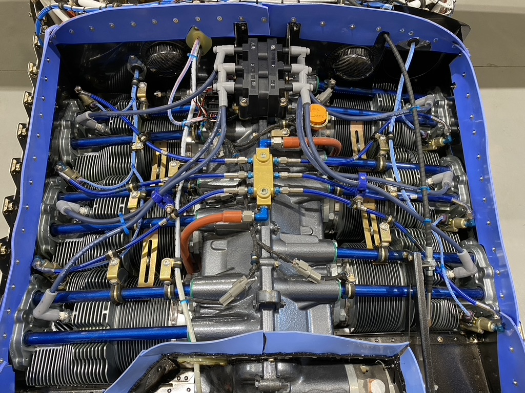

Is it the builders choice with your system to run a “fuel rail” from injector to injector or use the “fuel block” and lines to each injector? Are there pros and cons to each style of delivery? I could imagine the fuel in the lines from the fuel block to the injector could be subject to vaporisation like it can in the lines from the fuel spider to the injectors in a “normal” engine?
The fuel pump is putting out way more fuel than the engine can consume, the remainder gets swept right back through the backpressure regulating valve, the duplex fuel selector, and back to the tanks. There is no way the fuel is going to pick up enough heat in the short time it spends in the fuel block (or the rail, whichever is your choice) to begin vaporizing. The topside of the engine is the coolest environment FWF as well, with the incoming airstream there coming to the top of the cylinders. What heat it does pick up will be dumped into the fuel tank and lost through contact with the air through the tank skin.
No, we don't run rails as this is a mess on a Lycoming and in our view, a liability. You can PM or email me and I'll explain further.
The dead head, individual line to each injector layout we pioneered is well proven. Dave Anders has done hot starts (15 mins after shutdown) in 118F OATs. No issue.
With the top case mount fuel block, the block and lines are at ambient temperature in flight which is the most important regime.
The EFI uses much higher pressures than a Bendix type system. The fuel is under 45 psi after the pump so the boiling point is raised substantially. The AN3 lines have minimal volume. Hot starts are no issue.
With a fuel rail close to the exhaust ports and immersed in the hot cooling air coming down through the heads, the fuel will certainly pick up more heat here.
Aesthetic considerations should take a backseat to mechanical/engineering, IMHO. Despite the fact that neither system seems to be falling out of the sky, there are some compelling differences in even seemingly identical components between vendors. Do your homework. Make an informed decision.
Concerning the "Fuel rail" vs. "block" issue - I was an early adopter of the "direct fit" injector housings Ross invented and as result I had my own reservations about the amount of heat the lines would pick up. Against Ross' advice, I created a custom fuel rail type distribution system. It involves welded stainless steel tube and while it has performed perfectly to date, it is still a bit of a time bomb. Since the field experience now overwhelmingly shows the "block and hose" method SDS sells does not suffer from the fuel boiling/hot start issues, I will eventually go to that.
I was thinking more of in a parked situation. With the fuel block, the fuel between the block and the injectors is sitting getting all the rising heat from the engine below it. The typical problem with a Bendix system and the fuel spider. With a fuel rail this hot fuel is pushed back to the tank as soon as the pumps are on. I had it explained to me these systems are high pressure and not the same as the bendix at all, and that any vapors in the lines between the fuel block and injectors are just mixed with cold fuel and/or sucked through the injectors on start anyway. As you’ve said, obviously operational experience shows it’s not a problem. Was just wondering. The EFII fuel rail under the cylinder obviously also works.

I like to watch threads from the sidelines. But I'll chime in, for what it's worth. Krea, your install is nice. And I agree the SDS system is perfectly capable. I will never hold a match to Ross's posts here. Nor DanH. Personally (and I do mean personally), I think having routed on top of the engine is a cluttered PITA. I'm actually surprised that, in some way, it doesn't affect engine cooling. It's certainly a lot more outer baffle or inter-cylinder baffle penetrations (read: more points for air leakage). I have nothing to prove that, it just /looks/ like it would.
I'm posting the one recent pic I can find quickly from this past winter of my engine. Please avert your eyes from the ugly yellow - it's off an old Citabria. :) I started my build and flying with the original EFII system, then retrofitted to System32 after about two years of flying. There's no issue with installing the primer port-based injectors. I have the MP sensors on a clamped mounting plate because I started running out of accessible firewall space during the original EFII to System32 retrofit. The oxygen sensor controller is hanging loose here during my annual CI, but it's normally mounted to the upper engine mount leg, where the two wraps of electrical tape are.
Controller/software-wise, the one thing that really stands out to me between the two now is the ability to change all the mappings through a set of CSV files you put on an SD card loaded through the System32 controller head. No need to click through the 250 RPM increments or MP increments in the SDS/old-EFII control head. And in the CSV files you can have any RPM increment and MP granularity for any step. I haven't gone that far with my mappings, but it is a capability difference to note if you're of that level of tweaking abilities.
I can't remember whether SDS / old EFII was capable of this, but there's also the automatic "accelerator pump emulation" that injects more fuel at more sudden up-throttling at lower RPMs to prevent engine stumbling. I mention that since it's a fairly common trick to emulate pre-start priming. That's my cold start sequence - two pumps of the throttle to have the AP function squirt a bit of fuel in, separated by 10 seconds between them. 5 seconds after the second prime, hit The Big Red Button, 2 blades of cranking, and I'm running.
Honestly, I'm not sure what the hangup is over running one pump or two. Clearly both systems and their pump manifolds have more than enough flow to ensure quick starting even with heat soaking.
At some point you have to ask yourself "does this difference really mean anything functionally /to me/? does it /really/ matter, and how?"
