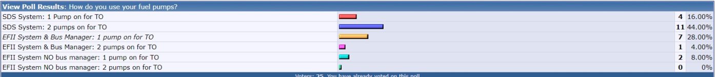

How do you use your fuel pumps?
  • SDS System: 1 Pump on for TO
    Votes: 6 13.0%
  • SDS System: 2 pumps on for TO
    Votes: 19 41.3%
  • EFII System & Bus Manager: 1 pump on for TO
    Votes: 13 28.3%
  • EFII System & Bus Manager: 2 pumps on for TO
    Votes: 1 2.2%
  • EFII System NO bus manager: 1 pump on for TO
    Votes: 3 6.5%
  • EFII System NO bus manager: 2 pumps on for TO
    Votes: 4 8.7%
  • Total voters
    46

Bus Manager and 2 for take-off
To the person who uses a Bus Manager did you not use the auto-switch over feature, or did you energize the second pump in another way?

There have been 4 respondents to the poll who use EFII with no Bus Manager (one which runs 2 pumps for takeoff).
If it’s not too much trouble, can I ask them to PM me with some details of their electrical system design to support EFII? (Or post here if you prefer)
Does the pilot who uses 2 pumps for takeoff on EFII use the EFII boost pump module and have they ever seen any issues?
For the 1 pump at takeoff respondents - whether they have a home made fuel pump switching device?
Thanks in advance!
