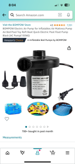

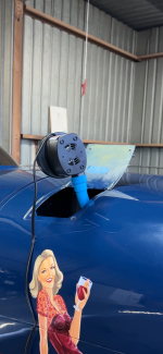

I found this air mattress pump on Amazon that’s snaps perfectly into the blue oil fill snorkel that comes with Phillips oil. I run it for about 5 minutes after flying to displace all the steam that outgasses from the oil with ambient air. It only make half a psi but moves a lot of air that blows out the breather hose. Before I leave the hangar I switch it out for a home brew dehumidifier that uses a fish tank pump and a container full of desiccant.

Great idea, Steve! They also sell portable units that could be used after every landing. Currently I just loosen the dipstick, but this looks like it would be quicker and more effective.
I do exactly the same things as Steve. Blow down the crankcase after flying to remove water-saturated hot air and replace it with ambient drier air for 5-10 minutes, then plug in my home brew dehumidifier system which is on a timer for 2 hours per day. This keeps the crankcase around 25% humidity, which will not support rusting on steel parts (camshaft and lifters). I have an extension cord that drops down from the ceiling and hangs a couple of feet above the engine so I don't have to trip over cords on the floor. Simple, clean setup that works well and makes me feel good about my engine. :)
