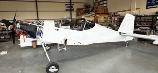

This weeks update:
Good progress - plane is primered and ready for wings to go on. Better part of the week was in the paint booth. We will begin attaching the wings Monday.
Canopy is complete and ready to install.
Still working on the wheel pants - but they’re gonna look good! Lots of sanding.
Here’s a few pics.

This weeks update:
Here’s a few pics.
Great idea to paint before assembly... sand away... Looking good. Look forward to your flight test and performance numbers...
Only doing the primer. Mainly because we don’t have a paint scheme yet. So, at AirVenture likely RV-14.png it’s just going to look like this pic ….white primer w decals. But, we figured it’s better than bare metal and fiberglass.

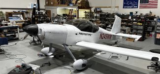

Update on this week’s progress…
About to install the wingtips - we’re going with the Aveo set-up. I use these on my current 14 and like them. This particular model is a newer gen model than mine, and if they work as good as they look they’ll be great.
Additionally, we added some lighting in the form of leading edge lights - for those times when one is landing on remote unlit strips. The switches for these ‘off-road’ lights are above the smaller G3X on the right side of the panel.
Finishing up the aerotronics panel installation - still work to do, but we fired it up and all is working well.
Waiting on the MyGoFlight mounts for the iPhone (it’ll mount to the left of the pilot-side G3X) and the iPad (it will mount on an articulating arm anchored to the right of the co-pilots small G3X).
Lots of other tasks completed - most not worth mentioning.
We’re still waiting on our FAA sign-off, so it’s looking more likely we’ll be ready to fly but unable to do so for a week or two. Because of this we’ve pushed back the first flight date to 6/12 since there are a lot of folks traveling here for this and we don’t want to get them out here prematurely.

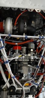

Craig, how does the interface between the ducts (for the radiator, oil cooler, intercooler) and the forward cowl air inlets work? Is it just a snug fit without any fasteners, or is there some sort of sleeve with hose clamps or other mechanism to secure and seal these components while allowing removal for maintenance? It should be simpler than a typical Lycoming with a plenum where you have to allow for relative motion between the plenum and cowl inlets, whereas on the DeltaHawk installation the ducts and cowl shouldn't have any significant relative movement other than vibration. That said, vibration between any two components in an airplane (especially FWF) can cause a lot of wear if they are touching but not firmly fastened to each other...
Checksix,
Short answer to your question on the fit of the ducts to the cowl: snug without any fasteners.
Longer answer: This may change. The current set-up is based on what DH is using w the Cirrus. I suspect we’ll change this a bit on V2 of the RV14 as it’s not optimal for installing/removing the cowl face plate (however, the upper and lower cowls are a breeze to install and remove).
Here’s a pic of one of the inlet ducts:
We did split it and put a flexible sleeve on it, but this was more for alignment purposes - not for vibration or installation purposes.
Again, this all will likely change a bit. We’ll focus on it more once we have flight data and know, for instance, if we need to alter the capacity of the ducts to optimize cooling/drag. The final goal is a complete cowling and ducting system that is not only efficient and effective, but easy to deal with when removing or installing the cowling.

I’m please to report that 245WM received its Special Airworthiness Certificate yesterday. Had a nice visit with our local DAR, Gary Brown - who happens to be a well of knowledge on all things related to experimentals (and, I’m sure other things, too).
Cory, with Shasta Aero out of Corvalis, came down and certified the Pitot Static and Transponder systems.
So…we’re still looking good for first flight next Thursday.
High speed taxi tests went well today. Plane taxis nicely and handles great on the ground. Incidentally, it’s much easier to pull around when getting it in/out of the hangar than my current 14. Not sure, but I think it may be due to the larger wheels and tires. Definitely doesn’t get hung up on small debris.
During the taxi runs we scrubbed the brake pads in - and managed to get the tail up a few times in the process.
All is looking good for first flight tomorrow. The plan is to do a few ‘just barely in the air’ hops the length of the runway - we’re talking a couple feet off the ground - making sure all temps look good, and the controls feel normal. After that we’ll likely pull the cowl again and look for any anomalies.
Then we’ll go for the first legit flight in the pattern - likely only 10-15 mins. There are two of us in the cockpit (me and DeltaHawk’s test pilot, Victor). Victor knows the engine better than I do so I’ll concentrate on flying while he listens to the engine, monitors gauges, handles the radio, and adds two eyeballs to the effort. He’s been a test pilot for about 30 years and I’m happy to have him on board for this.
After the first flight, we’ll pull the cowl again. If all looks good we’ll head up for about an hour and knock out a few test cards.
Here’s a short video of today’s start up from when we headed out for the taxi runs.
That’s about it for now - other than If you don’t hear from me tomorrow it means things didn’t go well!

Another update.
Four flights today (Saturday). They’re visible on Flightaware.com if you search 245WM. There may be other sites that track this stuff, but this is the one I’ve been using.
Our goals today were to continue to feel out the performance characteristics of the plane and deal with some minor squawks that needed attention.
Here’s my take-aways from today:
Even though we’re limiting power to 180hp, she’s looking to be about equal to my current RV14 in performance (climb and speed).
I was seeing about 1600 fpm climb with 2-pilots (440 lbs) and 44 gals of fuel. A bit less than my current RV14’s climb rate in similar config.
Single pilot (205 lbs) - my last flight of the day - with about 34 gals of fuel, I saw over 2000 fpm for a brief time (about a min). I didn’t attempt this for a prolonged period as measuring this climb was not my objective. On par with my current RV14.
As for speed - we still have not run at full power other than take-off (she’ll go 100.0 MP, but we’re keeping it to about 90.0 MP). Best speed in level cruise so far was between 165-170 KTAS at 7500’, 65.0 MP, about 2300 rpm. But will likely change a bit as we play with RPM, and certainly with MP. The engine has so much torque, we find dialing back the prop sometimes gives us better speed.
Here’s a sampling of some numbers I noted at different power settings:
5000’ msl, 47 F, 142KTAS (163 mph), 4.2 gph, can’t recall the rpm/MP, 38 mpg
7500’ msl, 47 F, 160 KTAS (184 mph), 6.5 gph, 2350 rpm, 60.0 MP, 28.5 mpg
7500’ msl, 47 F, 160 KTAS (184 mph), 6.2 gph, 2300 rpm, 60.0 MP, 29.8 mpg
7500’ msl, 47 F, 168 KTAS (193 mph), 7.4 gph, 2360 rpm, 65.0 MP, 26.1 mpg
These numbers are just a sampling - don’t read too much into them as we’re not focused on performance data just yet. Nonetheless, I wanted to get some idea of what we could expect performance-wise and share.
All that said, perf numbers are looking pretty good so far. Some related thoughts…
We’re thinking best performance will be about 2250-2300 rpm’s. It appears we actually burn more fuel and lose some speed with higher rpm’s. Likely due to the engine moving out of its peak torque area.
Fuel efficiency is dropping with speed - no surprise there. But, I suspect at higher altitudes very good speed/efficiency will be realized - better even than we have seen already (due to the decreased air density (lower drag) coupled with the forced air system).
That’s it for now other than we may not fly for a few days. We’ve got a small hit list of things to address:
-Cracked wheel pant (shop accident).
-Modify the lower cowl to allow for more cooling air to exit (cowl is ‘ballooning’ a bit - seems we’re taking in inlet air faster than we are evacuating it)
-Tweak to the flaps as the left wing is very slightly heavy
