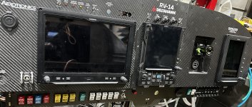

Little update…
The DeltaHawk RV14 - v2 - was just loaded and sent off to Racine, WI (DH’s home base) for the installation of the DHK200 engine and firewall forward package (including cowling).
We’re expecting the fuse/engine back in Eugene in April, at which time we’ll begin final assembly.
The Aerotronics avionics/panel is mostly installed (just missing the iPad (right side) and iPhone mount (left side), and sundry knobs).
And the canopy, wings and control surfaces are 90% complete - ready to install when the plane returns. Pretty much on pace with last year’s schedule that had us at AirVenture in July. Which means there will not be much to report until we get the plane back in Eugene. But, once here, things should progress quickly.
