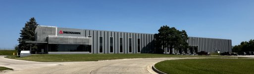

Arrived in Racine Thursday afternoon and after successfully navigating the TFR (Republican Convention) headed directly to DeltaHawk’s hangar. The DeltaHawk/RV14 was already wrapped and loaded on the trailer for the 90 min drive to AirVenture.
Met lots of the folks w DeltaHawk. Very sharpe group. Also met their two test pilots - Danny and Victor. Checked out Danny in my RV14 as he’ll be coming out to Eugene to do the initial few hours on the DH/RV14. Victor is heading the testing on the Velocity. Wish I had recorded its departure to OSH this morning as it sounds awesome.
This morning we did a tour of the DeltaHawk HQ and production facilities (across the field from the hangar). They are working on some interesting things that I am sworn to secrecy on. Nice set-up and more very sharp people.
Dawn (my better half) and I are now kicking back at a marina for lunch overlooking the lake and contemplating our plans for the weekend which will end with us being at AirVenture sometime Monday morning. I’ll post additional updates from there more focused on development news on the engine.
