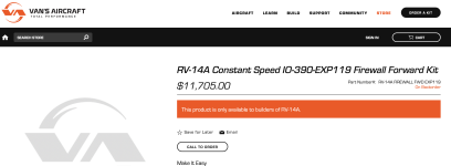

About the same as a Lycoming:
390 Thunderbolt - $74,889
Prop - $11,871
FWF kit - $11,705
Total - $98,465
You are going for the GOLD and no offense, I think you misleading with apples and oranges. First the DH is 180hp and the IO390 is 210HP.
The FWF (accessory) kit from Van is $2300. Now if you are talking about the
FINISHING KIT (which has FWF), that is way more than just FWF parts. Apples and Oranges. If you want to do the math, figure out what deleting parts from Van's finishing kit saves: Cowl may be? Engine mount may be? That would be fair. A Lyc powered Van's RV is going to be less money. See my
