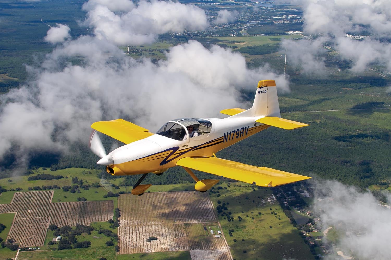

Carl,
It’s looking like the DeltaHawk (prop) will be about 3” forward of the standard Lycoming installation.
However, for a visual comparison - here is my current 14. Its prop is about 2.5” forward due to the light-weight Whirlwind composite prop (pushed prop forward, plus other tweaks, to compensate for CG issues).
So from an aesthetic standpoint the DeltaHawk should be very similar.
Craig

That's a lot of weight to push that far from the firewall..... must be be needed. for turbo etc.
I agree, the mount looks like it is not up to the task.
