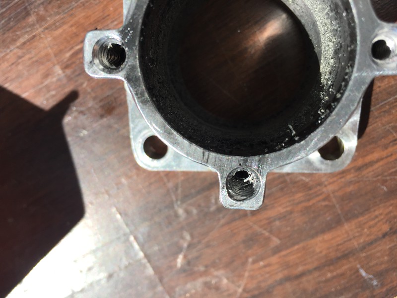

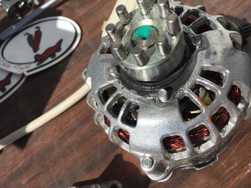

About 8 years ago I switched from the Van's 35a alternator to a Nippondenso, the one for a 70's Honda. I wired around the built-in regulator and retained my B&C external regulator. I had 2 failures caused by broken stator wires (covered by warranty). I stabilized the stator and the wiring as mentioned in the previous post and it's been fine ever since.
Question about the guts . . .
The stators have a shoulder bolt that secures them to the housing. Are they loose? PP uses 2 of them but the design allows 4 to be used. More likely it is rotor orbit or rotor balance that initiates the vibration. Or the bolts were not properly torqued. I found a screw protruding from the belt end bearing retainer on one. It just was not screwed all the way in. A QC issue to be sure.
Question to you guys, what did the SRE (slip ring end) bearing look like? Did it have two plastic rings embedded in the outer race?
VPBO_7-nb_idNdyTh7aAEnsZxAArAMwb60C7Q8tgroNWobjnoVpUtJ_al0XQ2oy5CL1qqhpJwLMp5WmHNdWGYTGiLXJfuvmO_vPdueMymbIZ-wJy0WBi7SAgYsc9Ll-OTsriS0LupkTNGGUCAEXXIvh-07C3pEOSlS32REcUqpedMw70d8qZu7zN7CE02oLPkOif_wcvsG73tpo-Mjq-vAqEzq7SFjObblgr8_q1A6LyfCUsgYRQlj323k8tQPyDhRc2w346igA3-aFgkJgEpvWDlWJYdVb82spQSMd3oWVZBNEexoMO1Mq4rfHVnJ_JT8_RWh6I9pcMsinSlRstw_I8E9IOLM981Mynpc6VlhVFJKum6LXa7WtKJFwikZ8Z6Id8tFxC6uWW40KPJMealLvLct3JVKYE308tN4D5jMe6HAYkibz7RNwzEF9osACPuK6h-_K5QLxP6dCTbVR_Z6kBpize34NXGbuidm96m-EyiFrWNuQ6Mq73K_zGc5uaDWw_o3f3FtbuMWI8-62Jx4koz0aWQGI4-3UTp5h9tkooopyuEaJorjYXrjZy5M0czANjdcbxhcHIION5Qm27peud3FNKDP75ZtCz862_v2h_90WB23cWUTKoLkc3Xom1gfFrzDpjTDzEHTQGZWsKd065O_G6Q88nWBBHRR7yPx-KeptZ8KZA5yA=w600
a8_PGmM2iRyeu8COVpUrXR2faigjYAGDdxHfQ_f9FIWtVRFFzMEMthFT0b6pZR2o-sbeh_g6dkXT-o3322FvXP5L_wdrEHaF5iL13ok9wQW-LoZbt_MvS02pPD15CYBolqz_wvnY_cApuvUUGvPXh1NFzh2O0rsxBdJ7n6pXgHbGNPcKT7IoMjXBV_Ml0EW2S1ZTPPuvwtNqfz5FPEjmbRRQR4MSWuG3WRWuqMBlV3ybpAXfc2N5JavQXqHXYZFGSrmxg_SJJ6MIqlVRSXcWhu6Pri53MF6ImY9vH3przkQy8sgtYubct-7qvy0-n_Nycd-oseE01D2wDta-IhapmDcznswym4IAqqTM6NjswOF2Xu9ziNxO03hzjJomKby0gDvHiiUgB9GPgW0r4-R0MUIMEFAeGY5tP_sdaRQsx3rAiXmxQmV4tWwlWJD6hsigEhSS7QAWoa1crIp0tyJ9TcE7KEfSHanDaxw2ED8Ctx4GlK1TRorKYP5ej2dQOFuCuf4xzbTQu3nIF5q-AvX6QAaXui-8oWIHkB8kruz6qxAdIJgUx2O0IU2YhoMgJ2_VhxyBiJ21N000op45DOIUrlTvXOw8CYM4Q5phmuE-RfZ7xyukDZblselaQT_KIvKjUGYRf2ABKinzx6C9x2GH5q6Wt7OsbSXX6EfD1HBuPVZ95jRbwsQAiu8=w600
Yes, mine were loose. Star washers now installed.

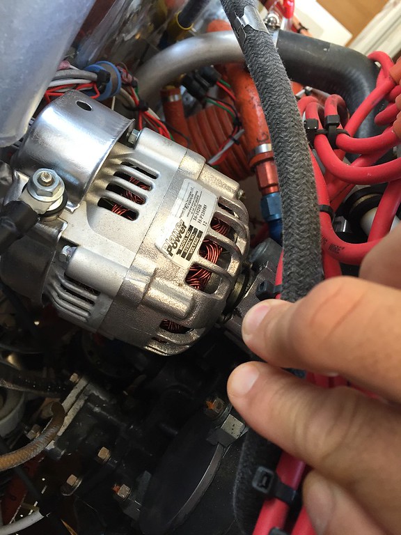

Our Altercator
Plane Power installed 600 hours and 8 years ago. RV-6, Lyc. O-320-D1A, fixed pitch Catto, blast tube from the front right baffle. Still working great!
Here’s my experience with a Plane Power backup alternator. It went off line in flight. Inspection showed it dangling from the cable. It took less than 100 hours for the threads in the bolt on adapter to fail. Short fasteners in cast aluminum from the factory. The B&C unit I replaced it with has a one piece nose, not an under engineered bolt on adapter.

Here’s my experience with a Plane Power backup alternator. It went off line in flight. Inspection showed it dangling from the cable. It took less than 100 hours for the threads in the bolt on adapter to fail. Short fasteners in cast aluminum from the factory. ...
Wow - that must have been a really sick feeling to see. The shaking on a typical lycoming is pretty intense, so is the vibration, so anything hanging on there with leverage is going to need to be very well designed and implemented.

This Denso Alternator will accept the PP Regulator and provide over voltage protection, successfully installed and bench tested.
